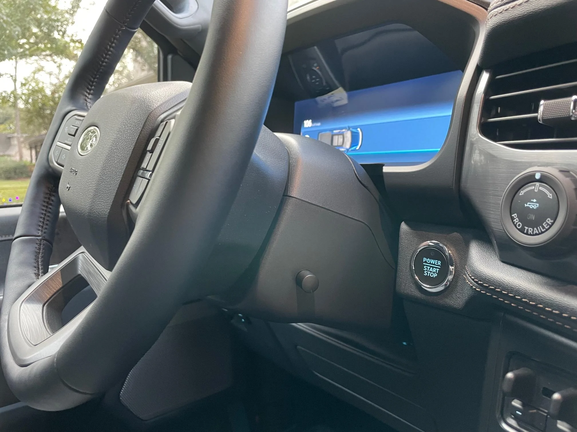

Transforms the audio experience and doesn't interfere with under seat storage. Replaces the stock subwoofer. Power fed from 12v battery. It really is amazing bang for buck. The sub output level control is installed on the steering wheel column. I highly recommend this solution to anyone wanting to improve the audio experience with minimal work.
Are you still enjoying the subwoofer?
skyak
Aug 19, 2022
164
157
F250, 911, Lightning
Yes, this subwoofer plus disconnect center speaker works wonders for the price and ease of install.
