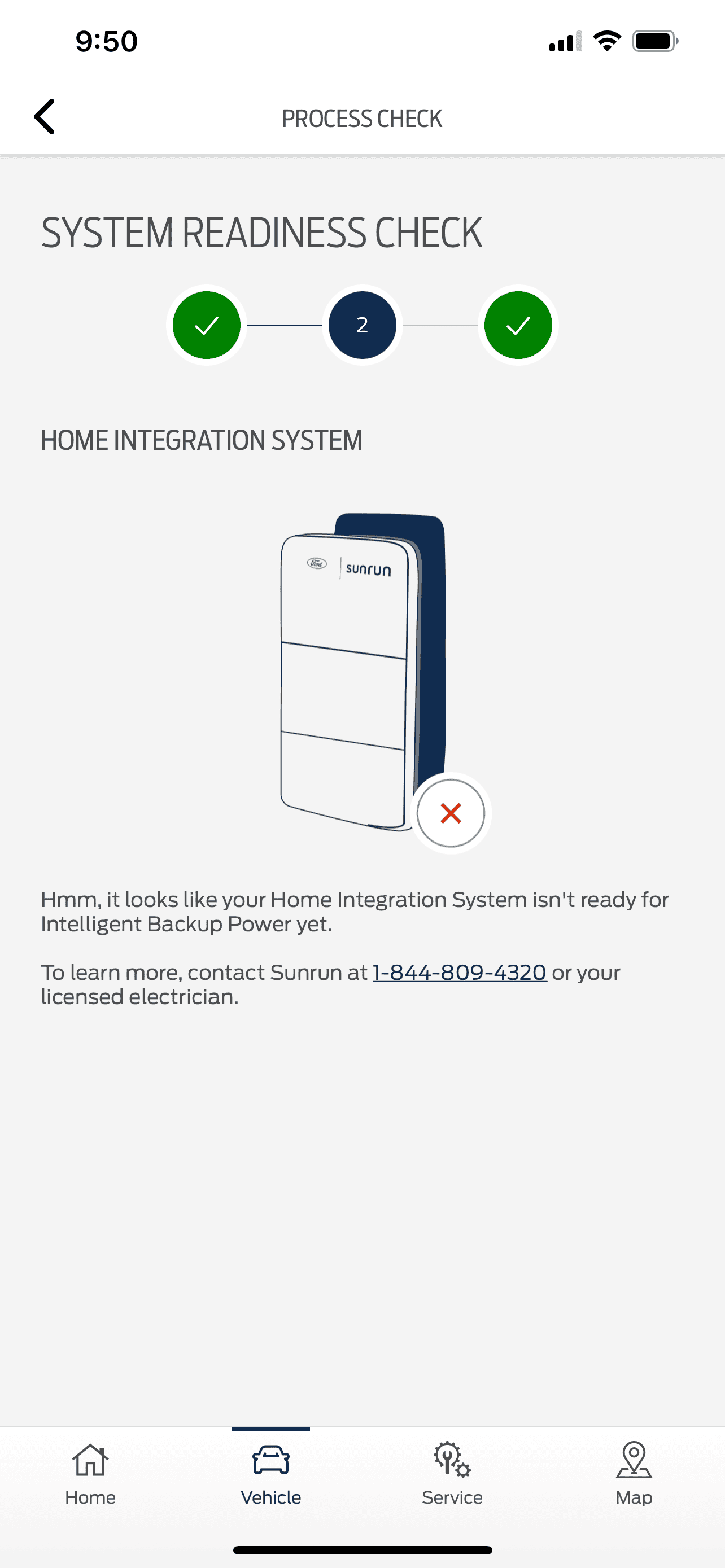

Nope. Still just sitting like this...

Let me know what you learn. I am in a similar situation - Check marks 1 & 3 are complete, but check mark 2 is not. However, as a test, I connected the charging cable and killed power to the house. The automatic transfer did occur (it took about 10 seconds) and the truck powered my home flawlessly. I ran my entire home for a few hours and then restored power to the house and the system returned to normal operation. My only concern: I never received a notice on my app that I was running on back-up power.
Update: I just received this from SunRun (months after install) Hoping it will complete step 2:)
Thank you for purchasing a Sunrun Home Integration System. You are one step closer to accessing the capabilities of Ford Intelligent Backup Power!
The Installer will confirm when they are finished installing the Home Integration System & Ford Charge Station Pro. Once done, there is one more thing you need to do to register your new system to the FordPass app:
  • Call (844) 809-4320 and let us know that you're ready to register your system to the FordPass app
Once that processes, you will see a green checkmark on step two of the “System Readiness Check” in your FordPass app. This checkmark will take several weeks to appear, but we need to load the information in now to get that ready for you.
Please reach out if you have any questions. You can reply directly to this email or call us at (844) 809-4320.

Is the Fordpass app working now for you? Can you share a screen? I have not heard of anyone where it is working
