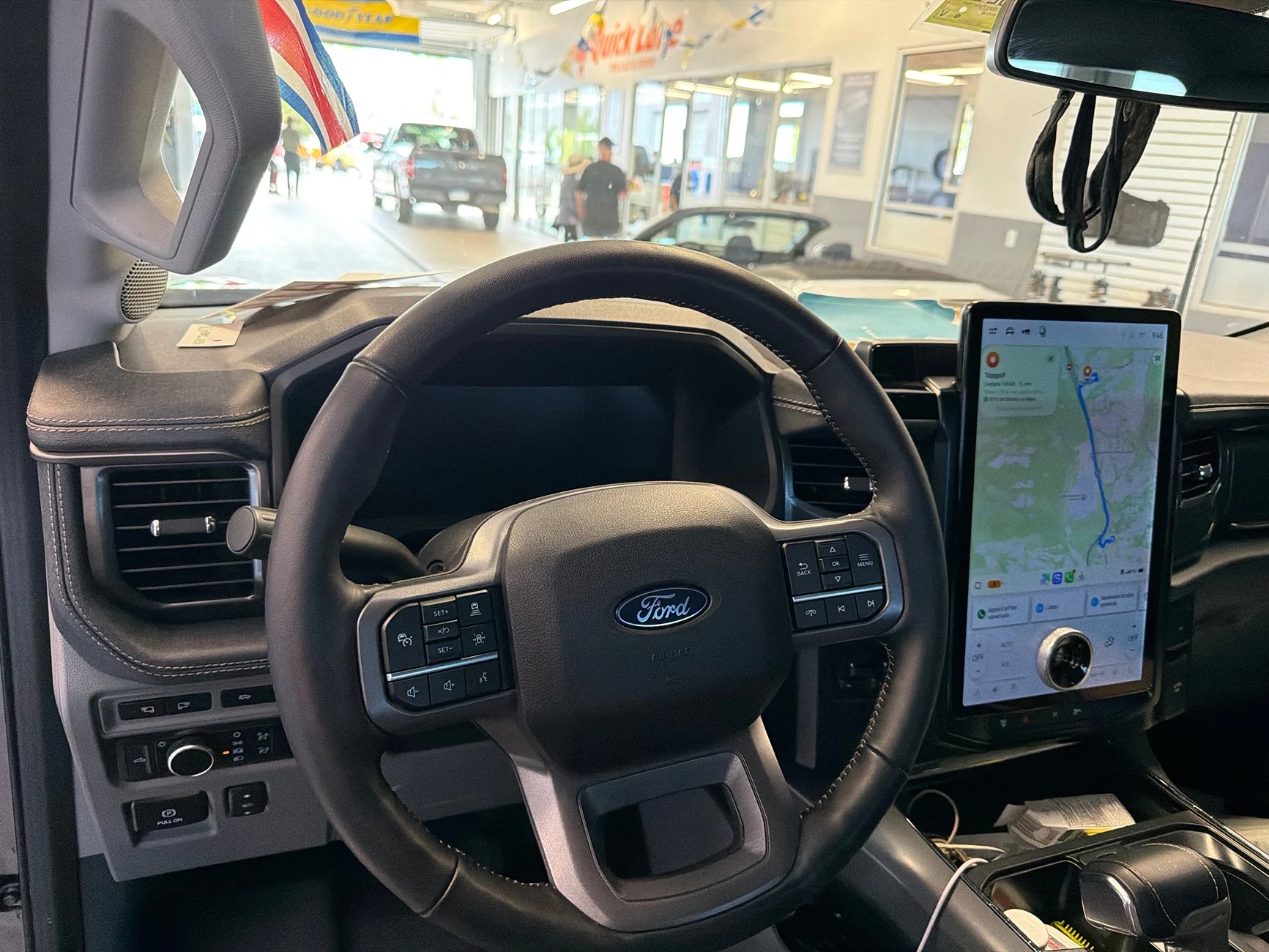

Just had this issue happen to me.
‘24 Flash with 42,994 Mi.
Currently at the dealership waiting to see what the issue is. The screen is backlit with no data being displayed.
Powercycled the truck twice.
@Ford Motor Company please help!
Did you try pulling fuse 13 in the passenger footwell? That fixed it for me and hasn't returned since.

Update:
When the tech came in to pull it in, it cleared. No DTC stored in the system. It’s been documented but it looks like it’s gone away.
