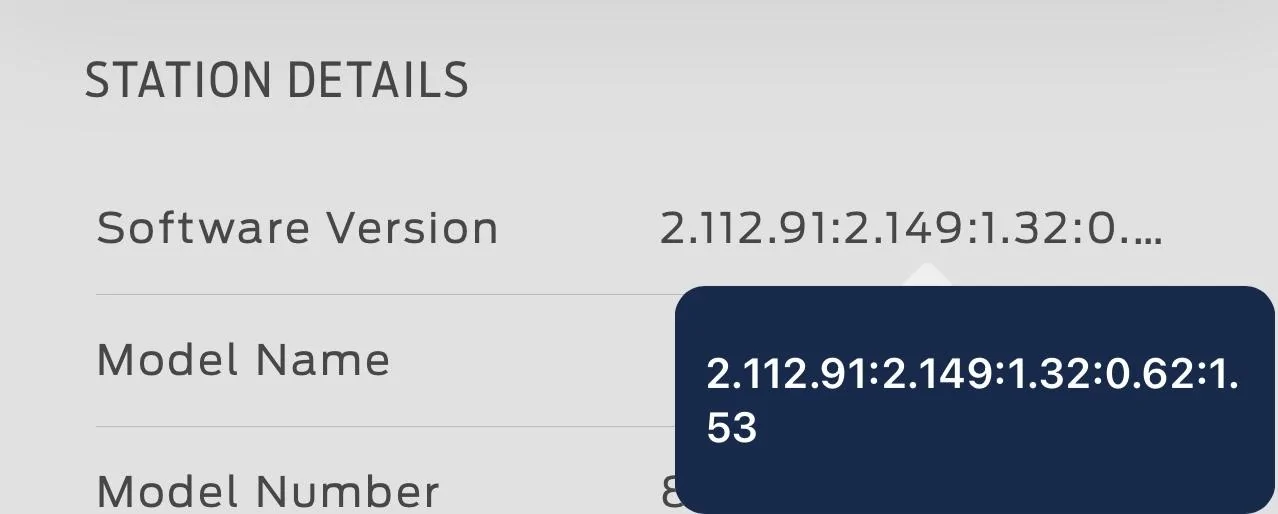

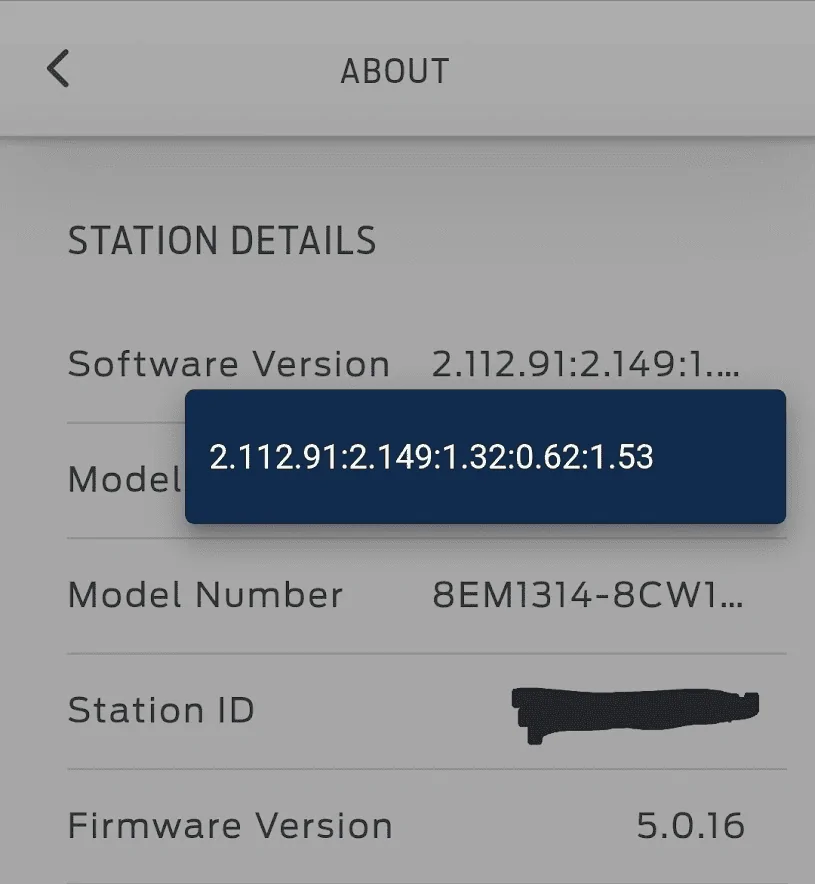

Do you have the latest software on the FCSP?
As viewed in fordpass connected charge station settings:
Ford F-150 Lightning Intelligent backup power Bluetooth issues and solution 1693673013860
As viewed in the Charge Station Pro setup utility:
Ford F-150 Lightning Intelligent backup power Bluetooth issues and solution 1693673056051
Yes it looks like I have the same.
2.112.91:2.149:1.32:0.62:1.53
Ford F-150 Lightning Intelligent backup power Bluetooth issues and solution 1693673375144
216
15,808
17,735
That's good, at least we know you have the latest version, I was wondering if it would have a positive impact on reliable HIS operations, possibly not the case.
