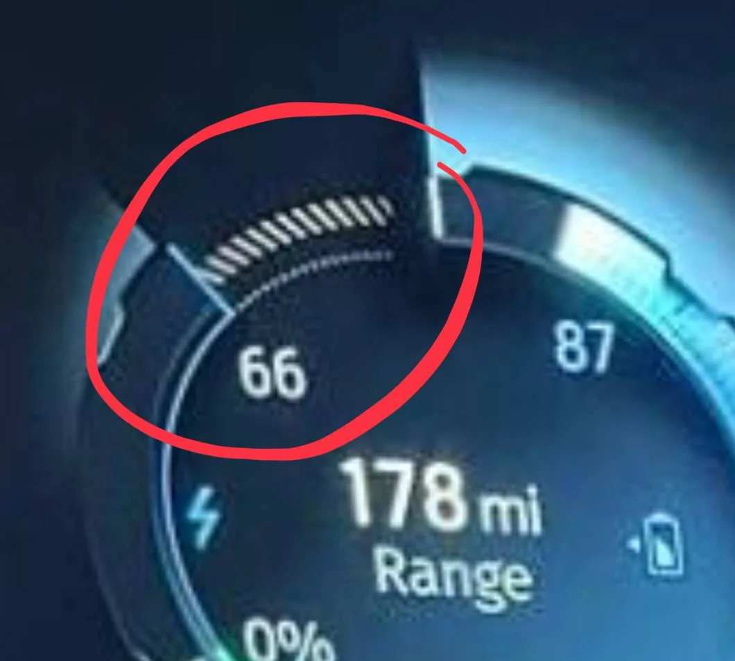

Speaking of gauge elements I don’t fully understand, what is the meaning of the energy guard not going to 100?
Sorry if any of this is obvious or redundant. Just to add a bit to what others have already said; there are multiple reasons that bar drops. As you use more of the energy the voltage of the cells drop (usually from closer to 4V to 3.5V on the cell lever and in 400V to 300V on pack level). Voltage is like the hight/depth of water in a damn. The higher, the more power. So when you see SOC bar going down really low, the power bar goes down too.

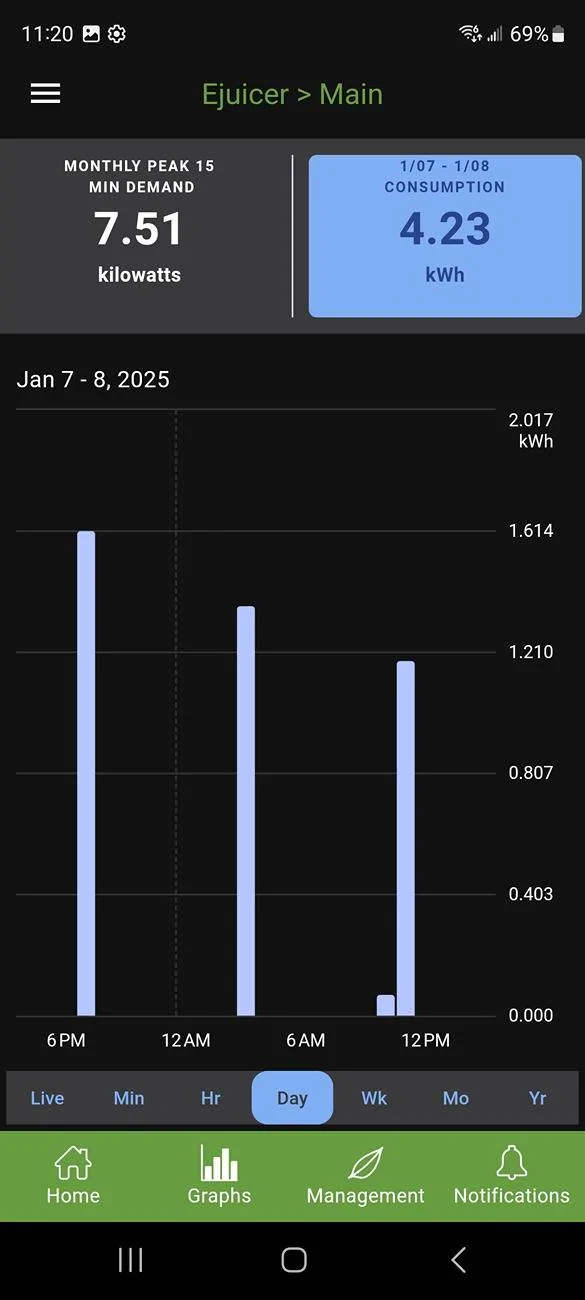

The cold makes less energy available as well. I was just preconditioning my battery (plugged in without charging the battery). At my temps (in 20s). It zaps the battery for 12 minutes (1.5 kWh) every 6-10 hours to get the battery temp to around 41F. When battery temp is going up, I can see SOC remain the same while energy numbers going up. That energy number may be something truck uses to calculate range. Here are a few things I am looking at.

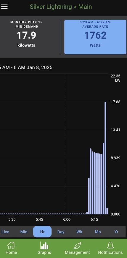

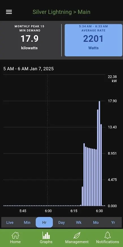

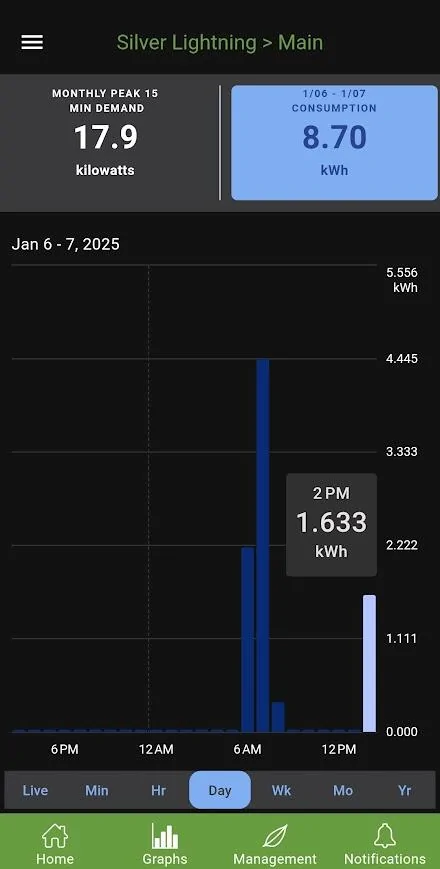

I've seen similar this week, my truck did an afternoon thermal bump up when I plugged in , then another a little after 6 am this morning.
Tuesday 1/7
Ford F-150 Lightning Intentional cold soak -15 1736359227636-6y
Ford F-150 Lightning Intentional cold soak -15 1736359091091-f0
Wednesday 1/8 morning spontaneous battery condition, no departure timer, manual activation of charger or remote start.

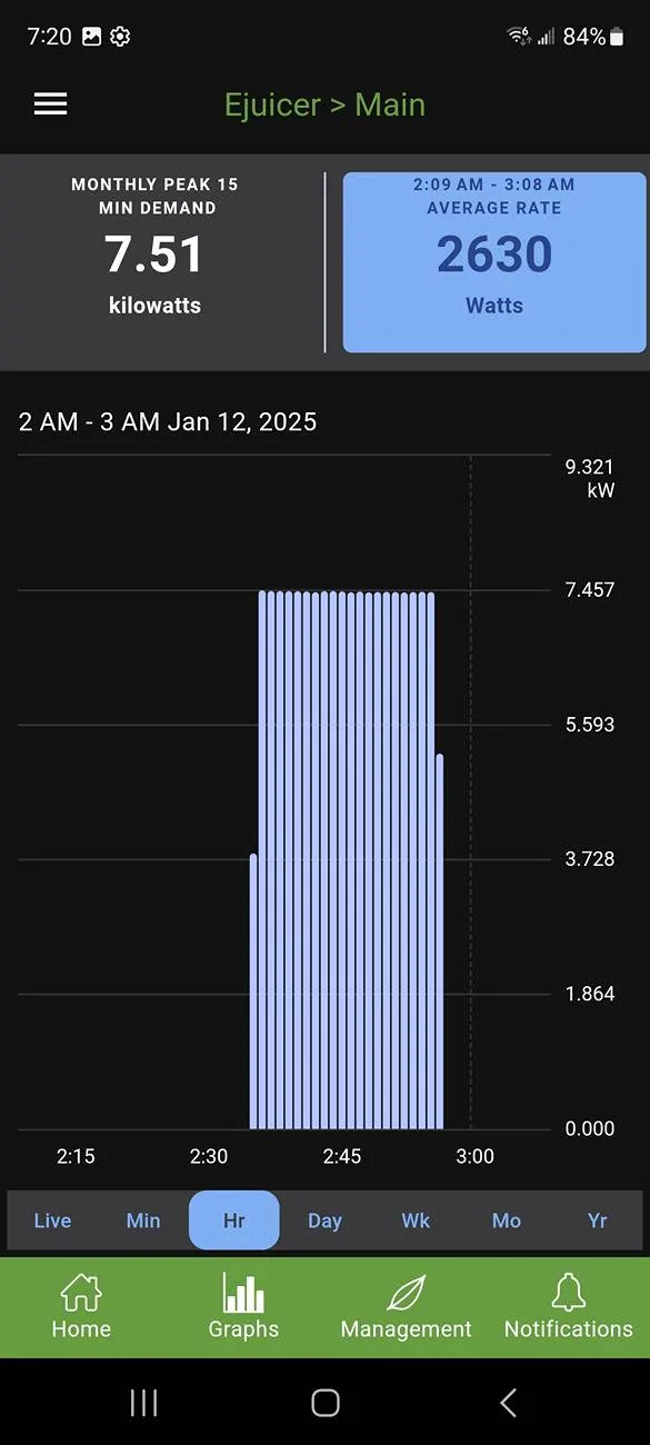

I just noticed my previous statement may be incorrect. My charger limit is set around 7KW and the battery heater uses around 9KW. What I was seeing was just the energy sent by the charger. It looks like heating system takes energy from the battery to make up the difference. In my previous observation truck SOC was above charging limit I had setup so charger never tried to charge the battery back up to make up what was taken from it during preconditioning process. It looks like this time when SOC was at charging limit, 2.6 KW was used not 1.5 KW to heat the battery. Those of you that pay closer attention to what your truck is doing please share how much energy your preconditioning uses. Please share what is your charger limit is set at.

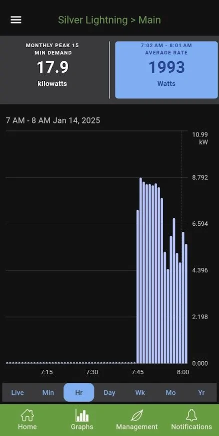

No over night condition needed Tuesday morning, the residual heat and moderate temps of Monday held over into this mornings low temp of 25°
This chart only shows my 15 minutes if remote climate start warming the cabin, 2 kWh.
Ford F-150 Lightning Intentional cold soak -15 1736864535514-rc
Ford F-150 Lightning Intentional cold soak -15 1736864553682-3m

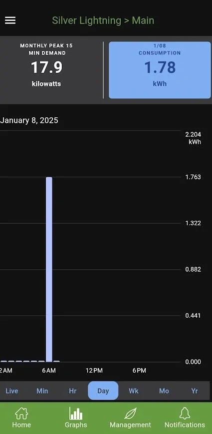

Got 10 minutes of battery warming Wednesday morning from 6:22 to 6:32, it's 19° right now, 1.77 kWh worth.

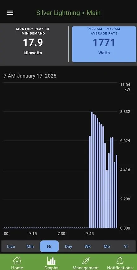

Updated post with energy chart that includes the remote climate start from 7:44 to 8:02, an extra 5.1 kWh of energy to warm the cabin.
Ford F-150 Lightning Intentional cold soak -15 1736985820102-uf
Ford F-150 Lightning Intentional cold soak -15 1736985701672-os

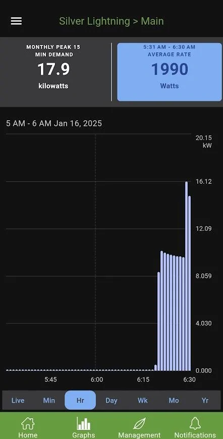

Thursday morning, 11 minutes of spontaneous battery warming 6:19 to 6:30, waking up to 11°, ~2 kWh used, 100% of available power to the motors.
Ford F-150 Lightning Intentional cold soak -15 1737036897103-a
Ford F-150 Lightning Intentional cold soak -15 1737036964906-ja

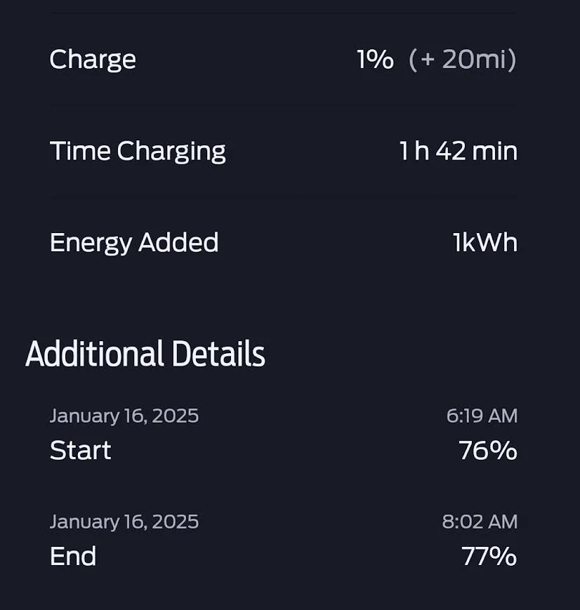

15 minutes of cabin conditioning, the rate of 17.9 KW suggests a little battery charging is occuring regardless of my SOC limiter set at 50%, with 76% still in the HVB, about 6.4 kWh total used this morning.
Ford F-150 Lightning Intentional cold soak -15 1737037125912-n6
Ford F-150 Lightning Intentional cold soak -15 1737037141665-w1

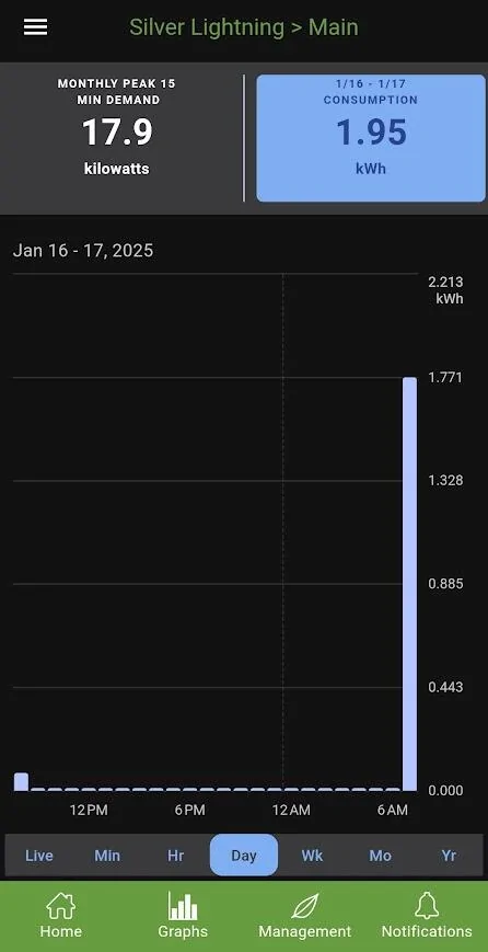

Tomorrow will be a little warmer in the early morning and highs increasing until Monday when the deep freeze sets in, that's going to be interesting to see how the Lightnings BMS performs
Ford F-150 Lightning Intentional cold soak -15 1737037360833-11
206
15,144
16,786

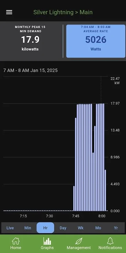

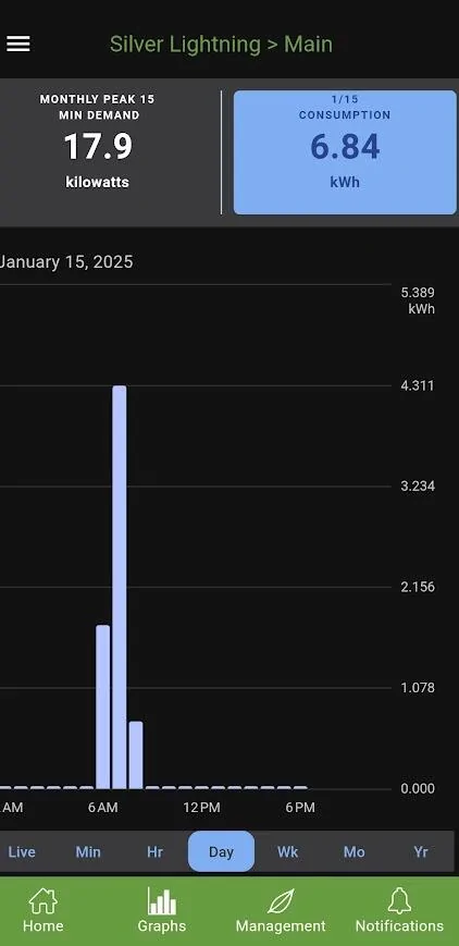

Friday morning was milder at 20° and the fact that I did some DCFC test charging yesterday afternoon, the residual heat held up overnight, no early morning pack warming was needed. The chart only has my 15 remote climate start, which was purley PTC activity ~9 KW and no latent charging. Only needed 1.95 kWh to warm cabin.
Ford F-150 Lightning Intentional cold soak -15 1737122537802-6v
Ford F-150 Lightning Intentional cold soak -15 1737122551430-vn

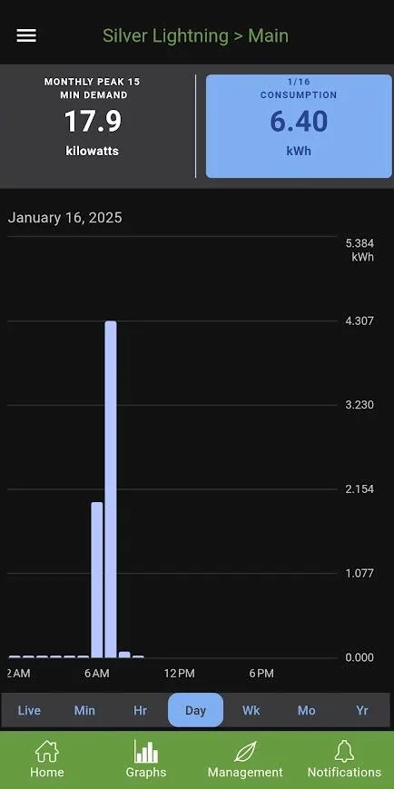

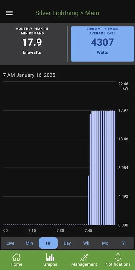

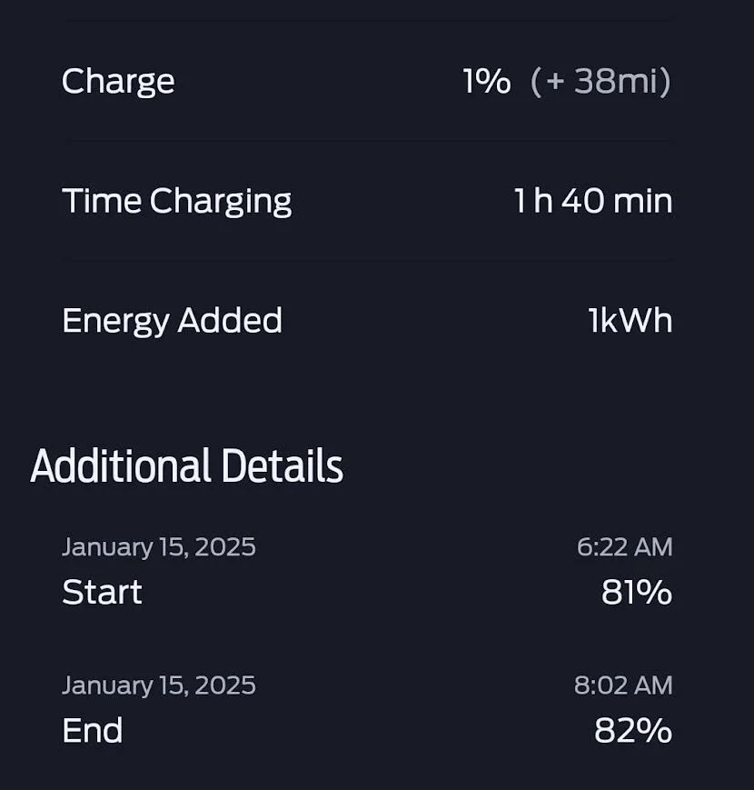

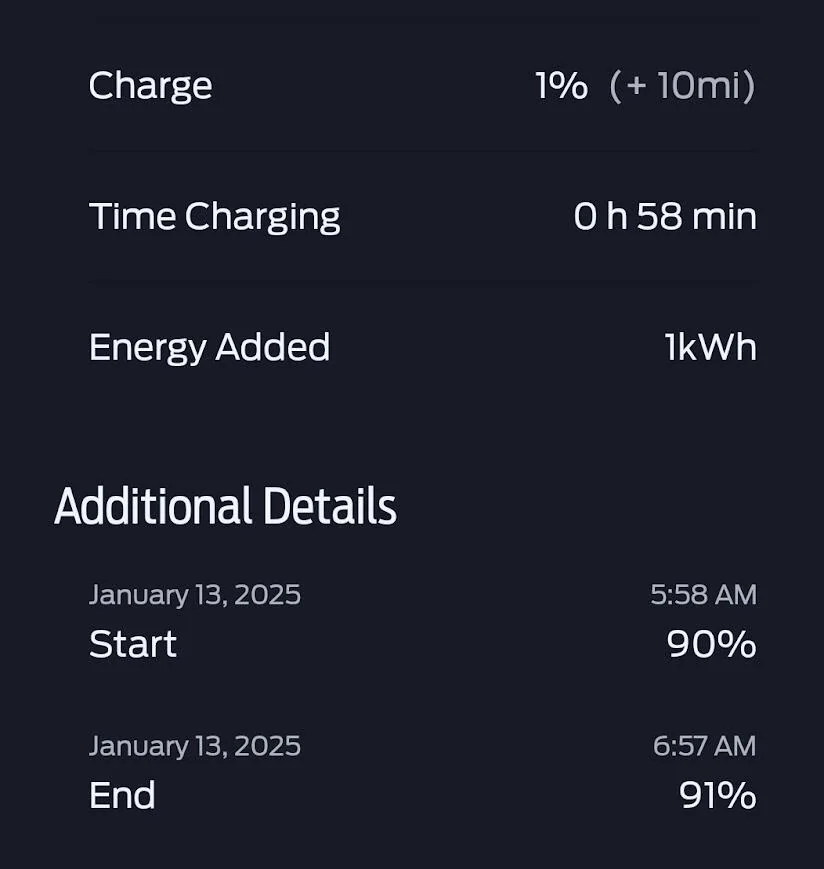

Speaking of latent charging while only doing remote start, the FCSP and Fordpass do measure this activity, always about 1% for a 15 minute period of time, notice the start times correlate to when spontaneous or departure conditioning started and ending time is when I unplugged.
I had samples from:
1/13/25----------------------------1/15/25-------------------------1/16/25​
