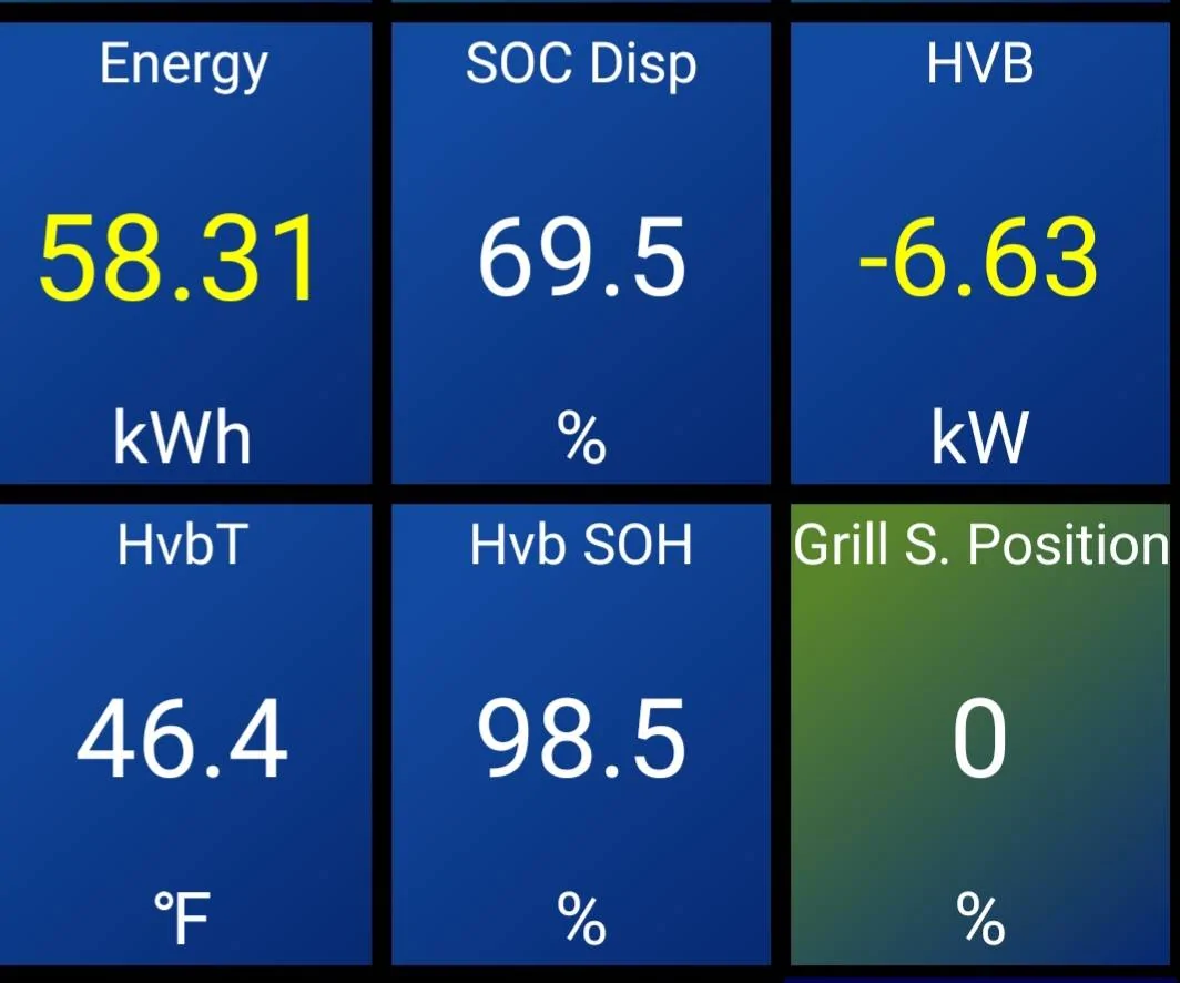

Thanks. Look at the images bellow. my truck was plugged in and battery was at 21F. so 25 may not be low limit for Lightning as it is for Mustang.
One more piece of Info: I just juiced up from 50% SOC to 70%. At 6.5 KW (charger was giving out 7.3 KW). At ambient temp of 16F battery temp went up 7.2 degrees. I assume at your charge rate it would heat up faster. This was from 39.2F to 46.4F. Heater was not used to warm up the battery. Just the process of charging. The other thing I noticed the delivery loss was at 10% but if I recall correctly, I was losing 7% during summer.
Also look at battery Temp and Energy at the same SOC (25 degrees at those temps and at my battery size gives 10 KWh)
This is when juicing was almost done:
Ford F-150 Lightning Intentional cold soak -15 Screenshot_20250122_192104

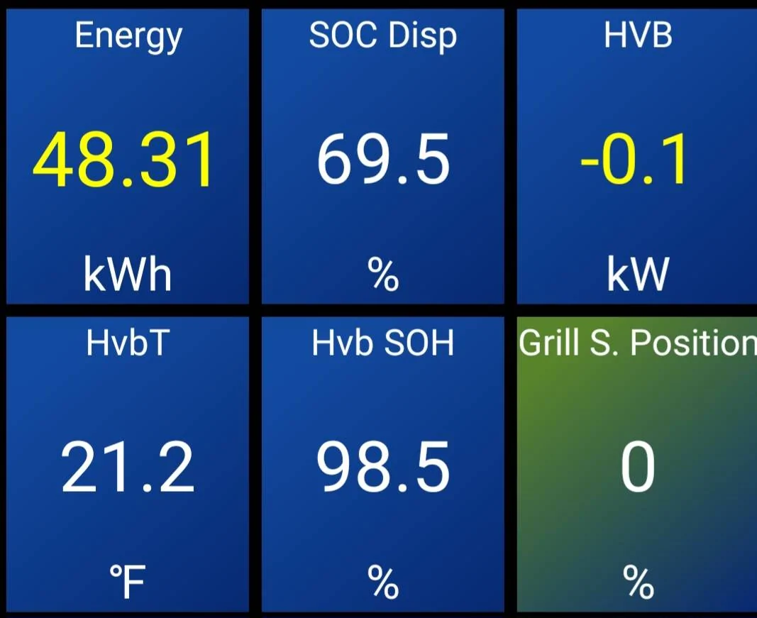

This is before I went out for a ride and used up 20%.
Ford F-150 Lightning Intentional cold soak -15 Screenshot_20250122_122001

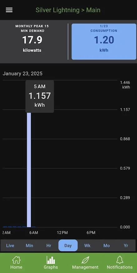

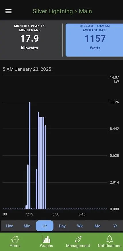

Thursday morning low of 10ยฐ, stimulated the Lightning to run the spontaneous battery warming at
5:13 am running until it paused for 3 minutes then resumed and finished at 5:24, only 1.2 kWh of energy consumed.
Ford F-150 Lightning Intentional cold soak -15 1737631862445-a6
Ford F-150 Lightning Intentional cold soak -15 1737631882500-rk

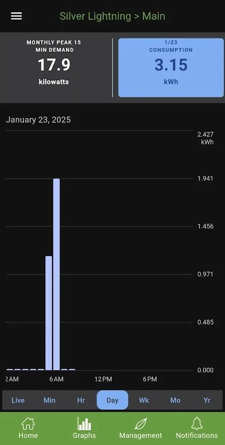

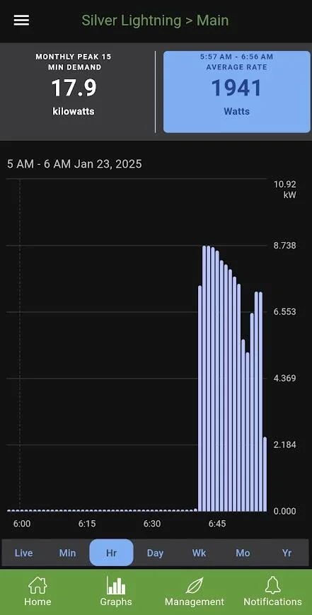

15 minutes of remote start will run from 6:40 to 6:55'ish 1.9 kWh
Ford F-150 Lightning Intentional cold soak -15 1737640879727-h0
Ford F-150 Lightning Intentional cold soak -15 1737640908901-75

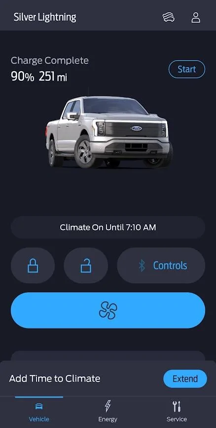

I manually started it at 6:40 but the system decided it wanted to run for 30 minutes with one push of the button ...... this is causing issues for folks who want to do a second session or further extensions note the 7:10 ending time.
Ford F-150 Lightning Intentional cold soak -15 1737641256244-48
