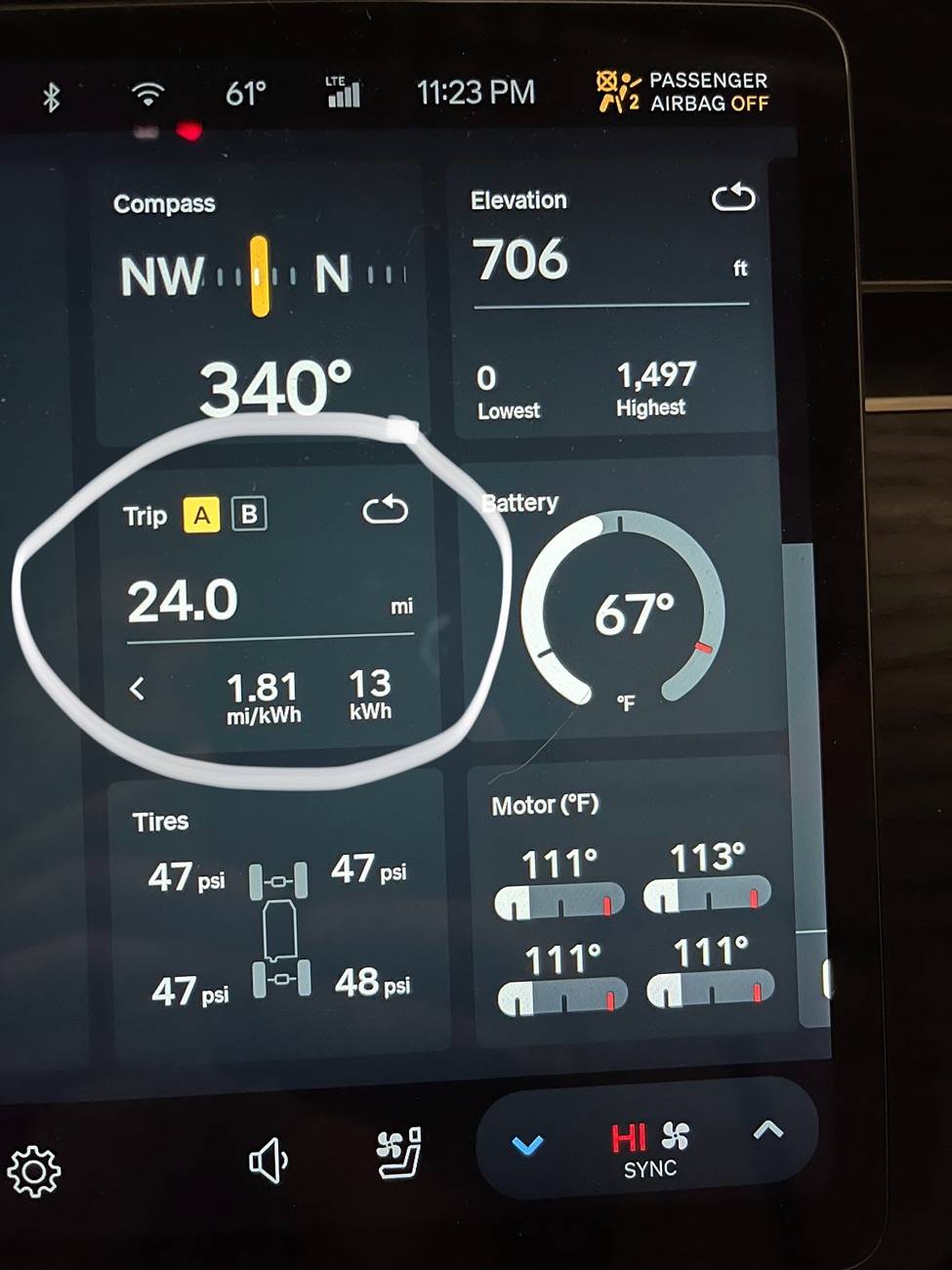

Here is a small efficiency update primarily done at 65 mph - 70 mph.
I normally get around 1.8 miles per kWh at highway speeds.
With the new tires I got between 1.8 - 1.9 miles per kWh.
Just based off the small trip I can tell the efficiency is comparable to stock.
Now keep in mind, my tires were 2-3 lbs low, my battery temp and motor temps were low as well.
I’ll do more testing today after putting nitrogen air from Costco and letting the battery / motor come up to temp.

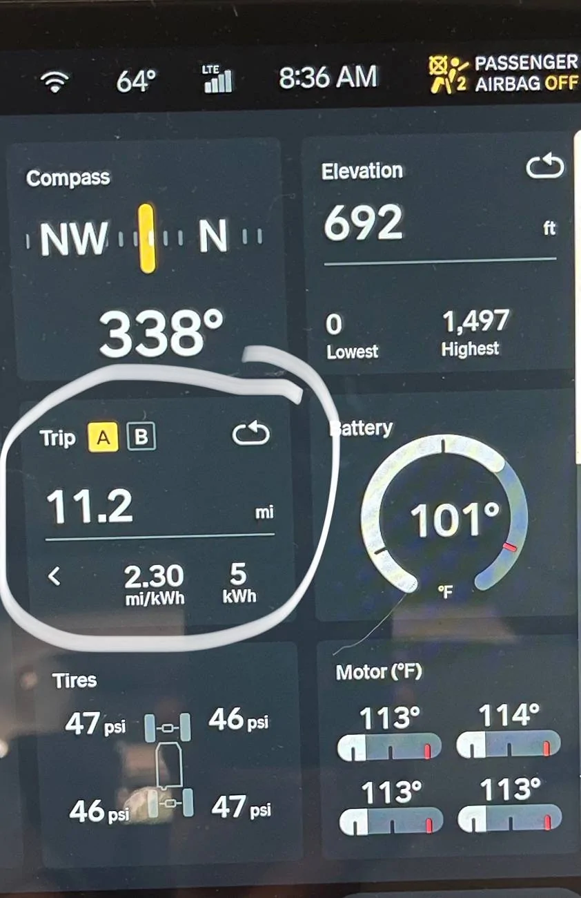

Another small efficiency update where battery and motor temps were at normal levels, speed was around 40 miles per hour driving to and from one side of town to another side of town using city streets.
I got between 2.3 mi/kWh and 2.5 miles per kWh when driving around 35- 40 - 45 miles per hour and mainly around 40 mph.
Keep in mind, my tire pressure was still 3-4 lbs low when hot. I expect slightly better numbers once tires are inflated to 50 lbs.
I’ll give another update once I can get my tires to 50 lbs hot. I don’t feel like using the compressor in the car and rather use the self-serve nitrogen tire pump from Costco at no charge.

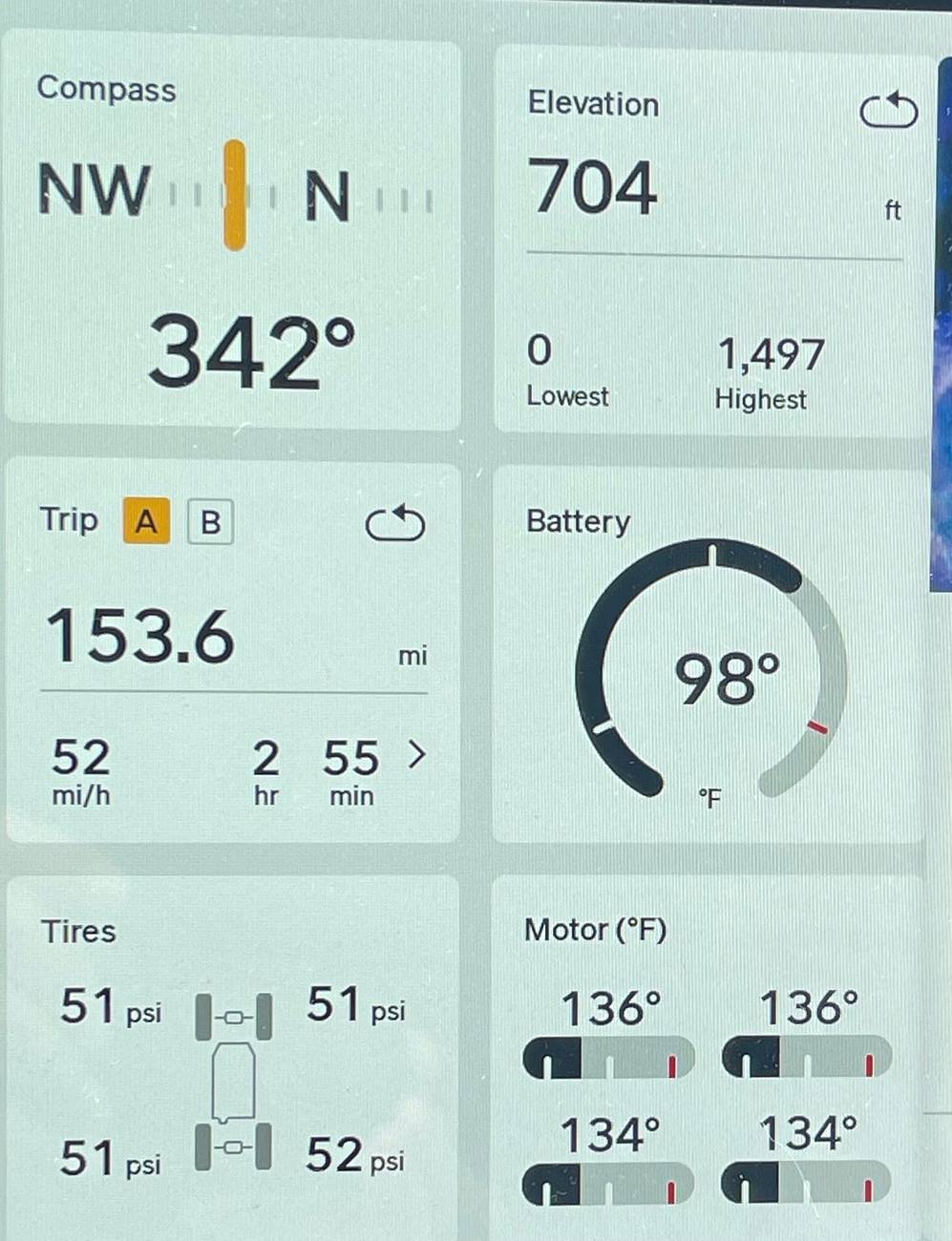

I got pretty much the same efficiency as stock or slightly/barely better with XTM AT versus stock Pirelli Scorpion AT+
I am running them at 48 psi - 50 psi and sometimes as high as 52 PSI after a long drive.
Here is my most recent run where I charged to 100% and took a long trip around town.
I am charging it back to 100% to see how much electricity is actual replenished.
Primarily 153.6 miles Highway Driving

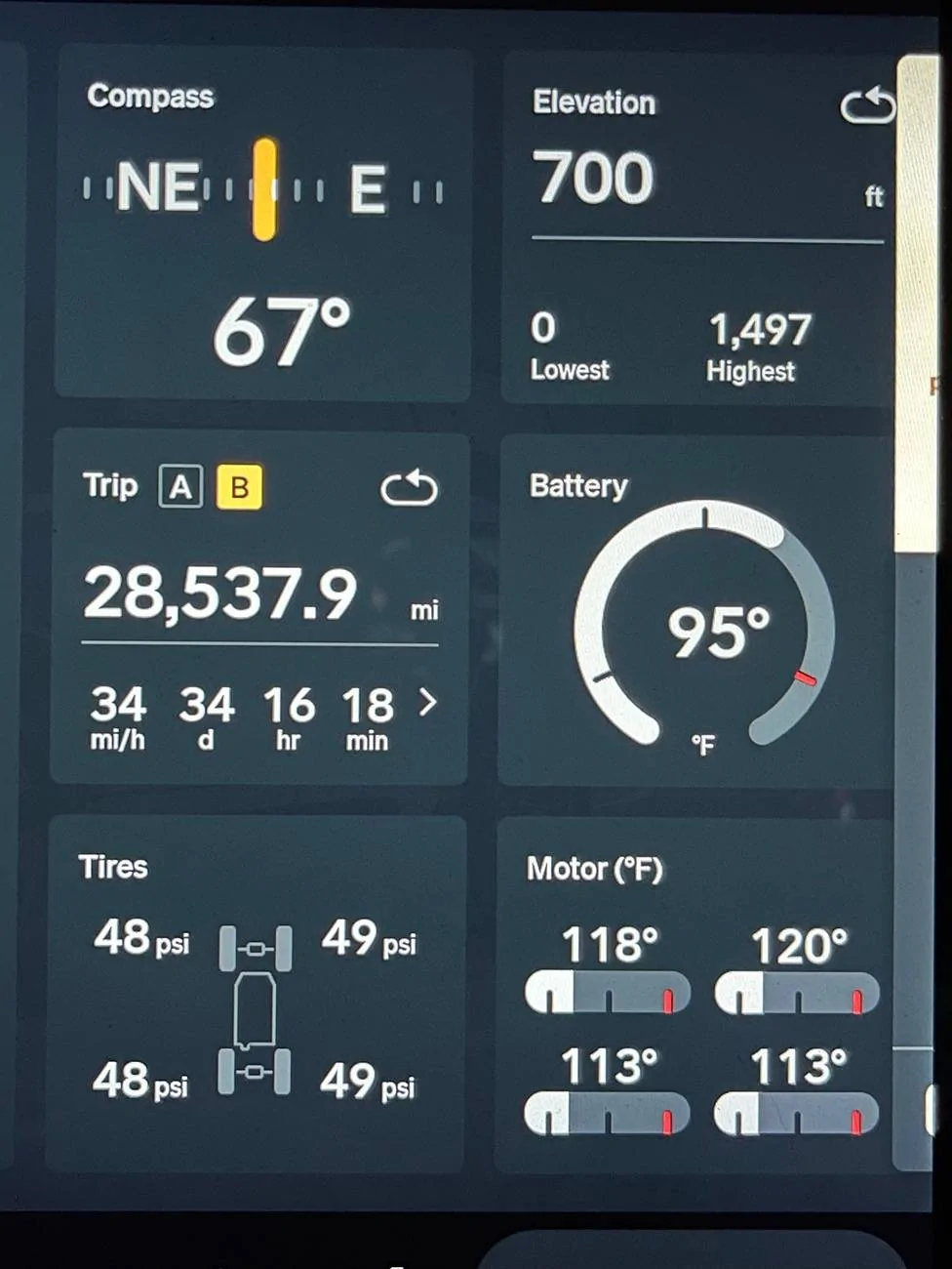

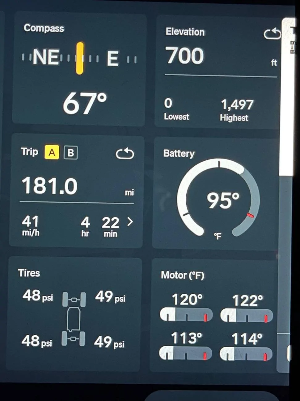

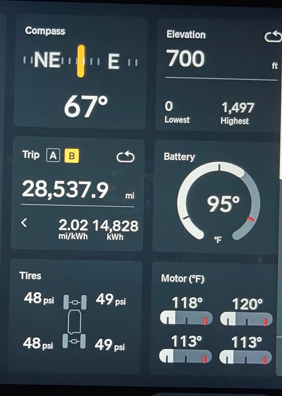

Mix of 85% highway and 15% city on Pirelli XTM AT.
Ford F-150 Lightning Just installed the recently launched Pirelli Scorpion XTM All-Terrain Tire with gas and EV variants. 34" Tires on 20" wheels. IMG_5801
Ford F-150 Lightning Just installed the recently launched Pirelli Scorpion XTM All-Terrain Tire with gas and EV variants. 34" Tires on 20" wheels. IMG_5794
Ford F-150 Lightning Just installed the recently launched Pirelli Scorpion XTM All-Terrain Tire with gas and EV variants. 34" Tires on 20" wheels. IMG_5798
Stock Efficiency over 28,637 miles is 2.02 kWh

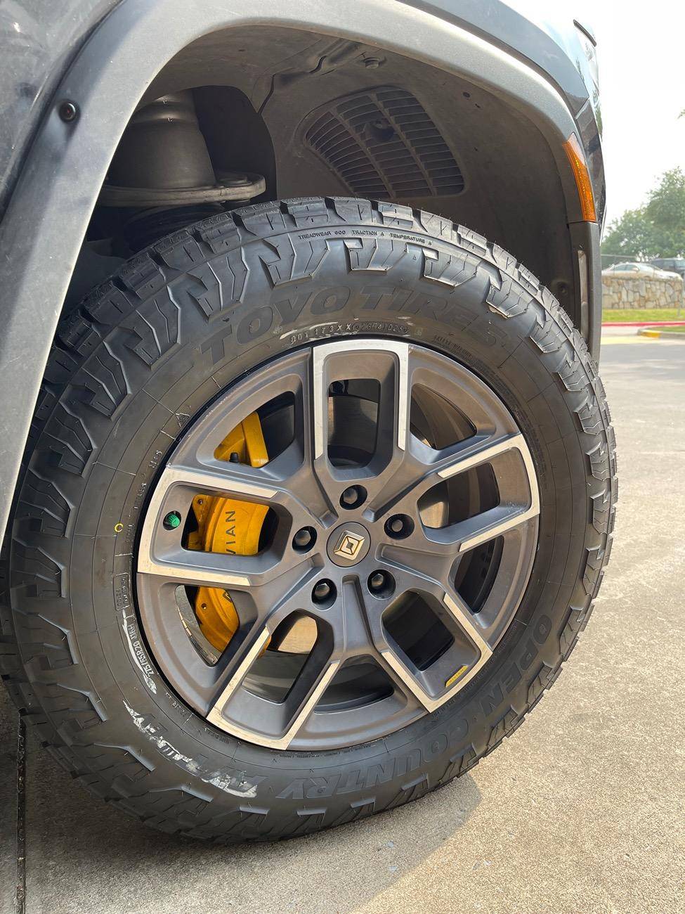

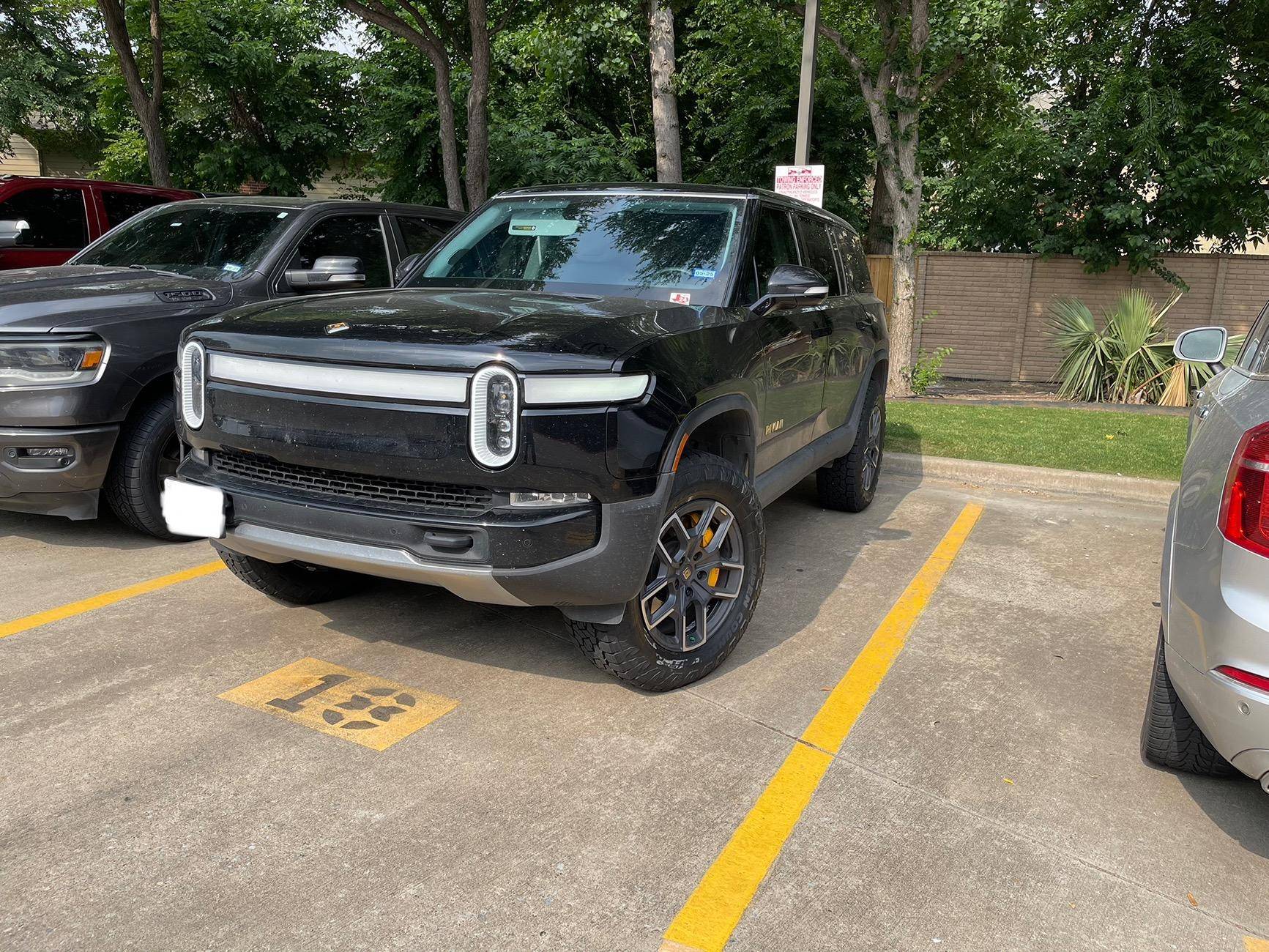

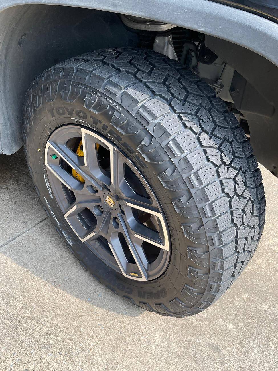

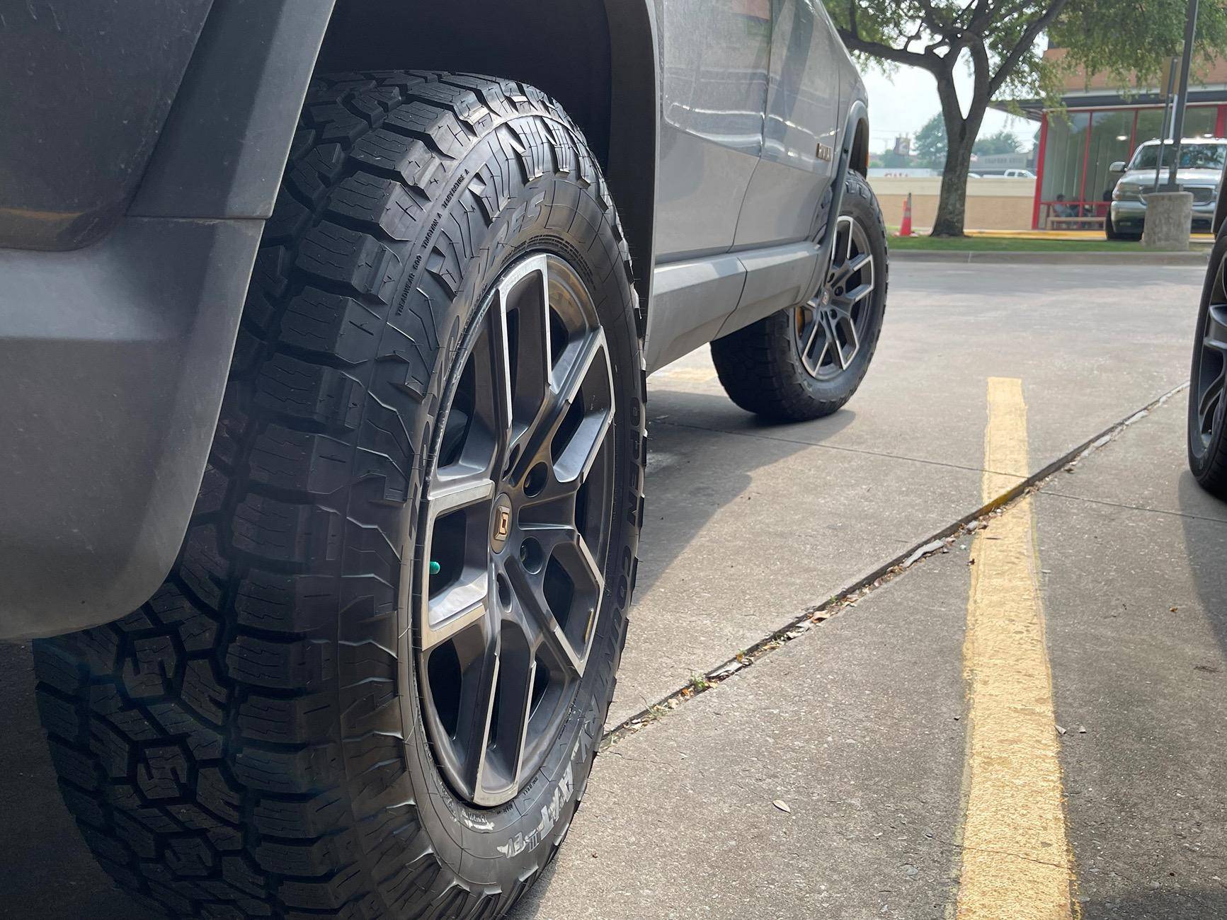

I swapped out the SL XTM AT with Toyo AT III EV SL to make sure I can safely inflate my vehicle to the minimum specs.
I would recommend waiting for the LT version of XTM AT which can handle more weight / pressure.
I chose the Toyo Open Country AT III EV tires because of the 116H rating / AT EV tires / Price.
I had to work with an associate at Discount Tire after ordering the tires to get them from a different store and have them shipped via Fedex next day at no charge. These SL tires are in low stock compared to the LT version
The 1-5 days shipping time was accurate for me. I did call my local store to make sure they can order it or get it from another warehouse / store.
Here is the initial pictures from the install.
Just driving 4 miles I got 1.92 mi per kWh. I would expect this to go up once I’ve driven 20+ miles instead of short trips.
I’ll drive more tonight and report back with proper efficiency numbers and once i get all tires to 50 lbs hot.
