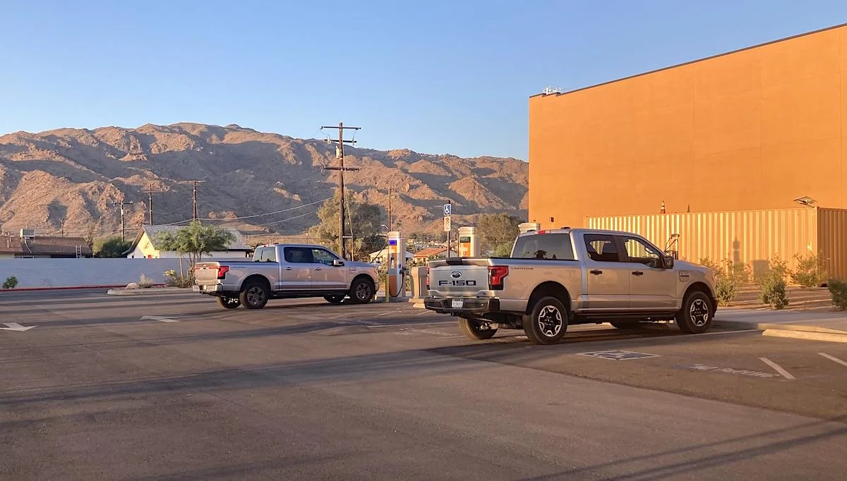

I am not a newbie - I have over 15K on my 2023 Lightning, over half of it on the open road, and I have over 75 DCFC charging sessions under my belt.
But sometimes I learn something new about my EV truck.
I was at a ChargePoint DCFC the other day. I was topping off (already slightly above 90%) because I was about to cross an EV (and literal) desert of over 200 miles, with some significant elevation changes (thousands of feet), and I wanted a bit more margin on the total range.
I plugged in, the charger began initiating the session, and then stopped. No fault or error; just stopped. After a couple tries, I hopped to the adjacent charger and got the same results. Then I moved to a Level 2 AC charger and the charge began, no problem.
After getting some coffee at a nearby donut shop (it was VERY early in the morning) and starring at the truck for a bit, I finally realized that the problem was NOT WITH THE CP CHARGERS. I was MY set-up instructions in the truck, which tell the Lightning to cut-off DCFC charging at 90%. Well, I was just above that, and both the charger and the truck were doing EXACTLY what I had told them to do.
The Lesson? Sometimes a frustrating charging experience doesn't have anything to do with a bad charger, or a problem with the EV. Sometimes, you just need some coffee to think through the situation and realize that what is happening is exactly what is suppose to happen.
