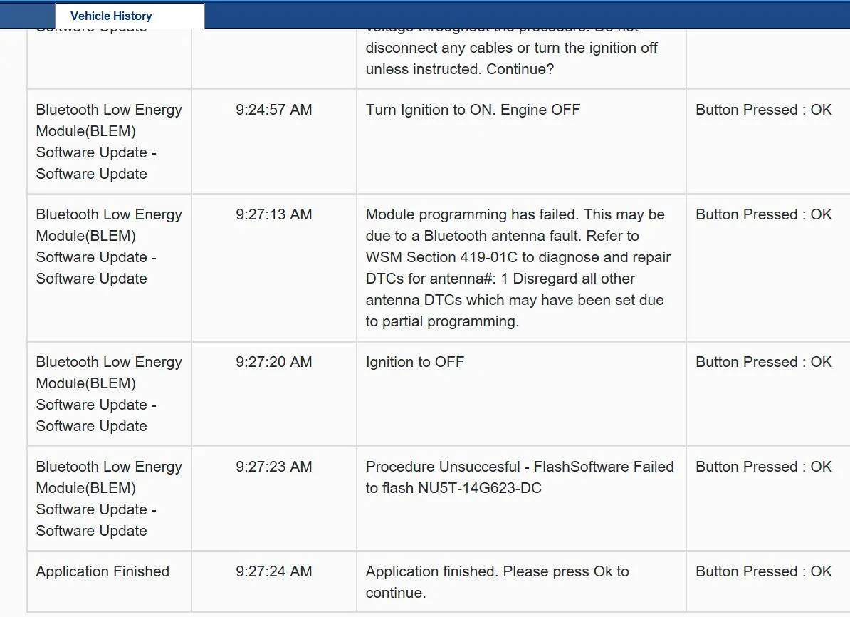

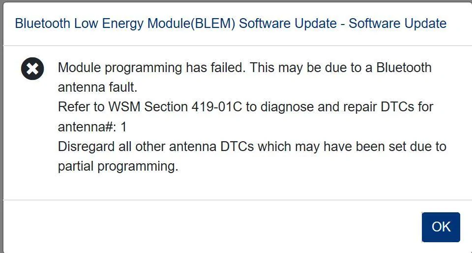

Picked up a 2 day license and got most of my updates caught up. Had a PCM, ABS, PSCM, SOBDMC, RFA, ACM, TRM, BECM, GFM2, SOBDM, SOBDMB, DDM and PDM available. I was able to run all of them successfully except the RFA which errored out (below). Has anyone seen this error before and/or knows how to get around it?
I did do the rotary shift mod, but I don't think that would be related to this. I did try to do a PMI on the GSM to see if it would work on the rotary shifter, but it errored out with "invalid hardware". I tried stating I didn't have the original module and then again stating I did. I was able to do a VIN Write successfully.
EDIT: Temporarily put the original shifter back in and it made no difference. Tried a PMI on the RFA as well. I'll next try a PMI on the ACM like rugedraw suggested below.
RFA error while doing update:
Ford F-150 Lightning Lightning Software Updates using FDRS 1744990108293-tc
RFA error in vehicle history:
Ford F-150 Lightning Lightning Software Updates using FDRS 1744990411825-n2
Strange. I looked through 419-01C in the workshop manual and I don't see anything there that helps. Your truck is not reporting any codes for that; only a U1A00 on the APIM. Try doing a PMI on the ACM (select no when FDRS asks if it is the original module) to see if that APIM code clears.
As far as the RFA, try turning off the truck and let it sit for a half hour. Reboot the laptop and try to update the RFA again.
@rugedraw , I appreciate the suggestion. I did the PMI on the ACM successfully. As for the RFA, I disconnected the battery for 10 minutes and then tried again with the same error. I tried a PMI and it failed as well as reading the configuration option. I tried RFM initialization too which mentions BCM and RFA, but it failed to get a security key. Do you think the RFA update failure could be an access issue related to my independent operator login? I know they locked down BCM updates to dealers last year.
I also gave Forscan a shot and rebooted the RFA. I then downloaded the RFA factory configuration defaults and tried to do a force write, but it said the process was interrupted.
Everything seems to work ok as far as I can tell, so I may just leave this as a future problem.
I don't think so. I have seen people here and on the Mach E forum have issues trying to update the RFA. I am not sure of the workaround, tbh, but I don't think the login type is the issue.
Did the PMI on the ACM clear the APIM code?
I didn't check afterwards and when I tried the RFA later it caused a ton of APIM errors. I ended up doing a clear all DTC and then nothing showed up in the errors after power cycling and checking again.
