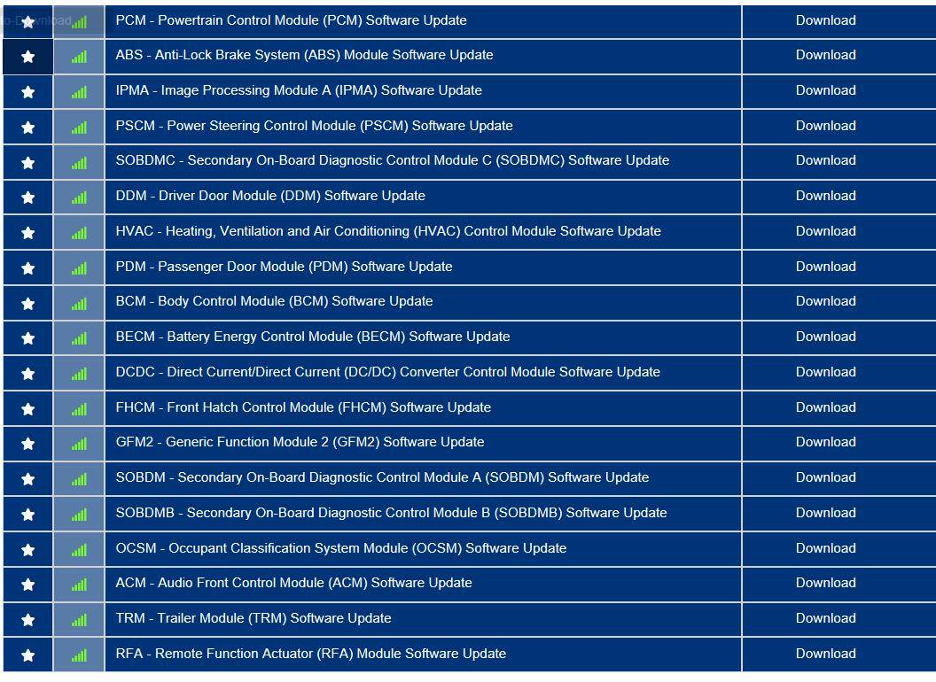

Ford F-150 Lightning Lightning Software Updates using FDRS 1743943750354-0k

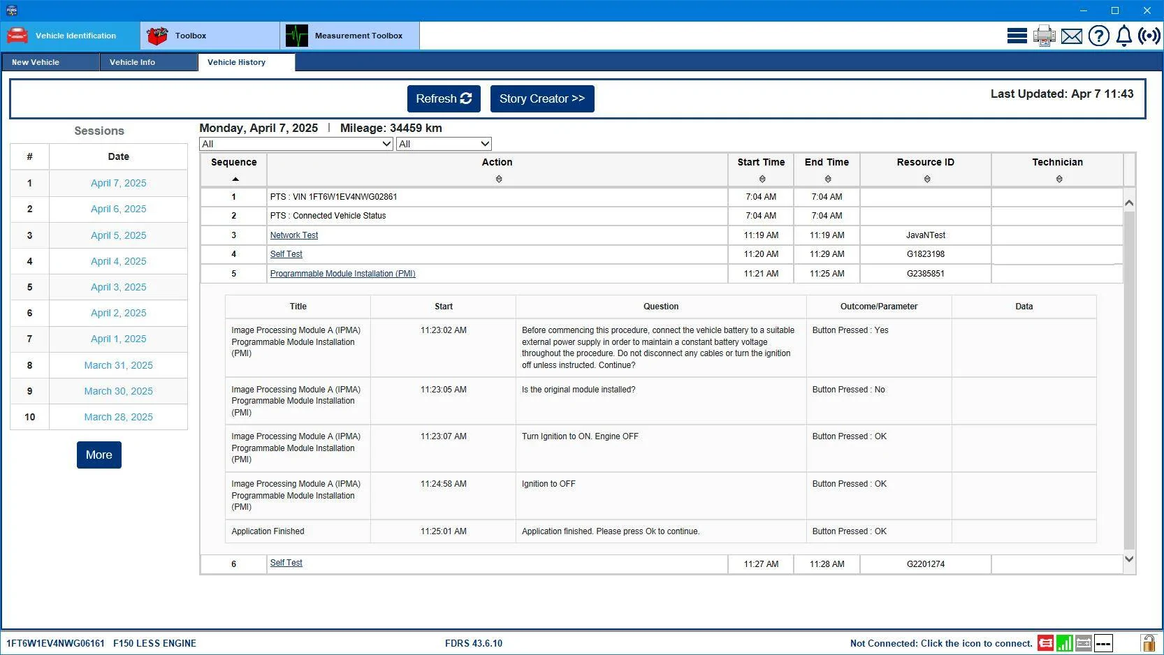

So I did go through the IPMA PMI routine using the TOPDON RLink this morning and FDRS is smarter than I am, apparently.
It all went fine, but because my IPMA was already at the latest software and configuration it didn't do any block erasing and replacing.....simply gave my truck a nice pat on the head and said "there now...that didn't hurt a bit, now did it?". I even tried to force it to redo everything by saying "No" when asked if the original module was installed. But apparently FDRS checked everything and decided that I was delusional and didn't actually need a PMI afterall.
But on the upside...the TOPDON RLink worked like you'd expect. I plugged it directly in without using the OBD extension pigtail (why add unneeded complexity if you don't have to) and it performed just as well at doing everything I needed to do today.
Obviously, the real test will be the next time I actually have some updates to do, and I will definitely use the RLink to do whatever comes up next, either on my truck or the MME.
