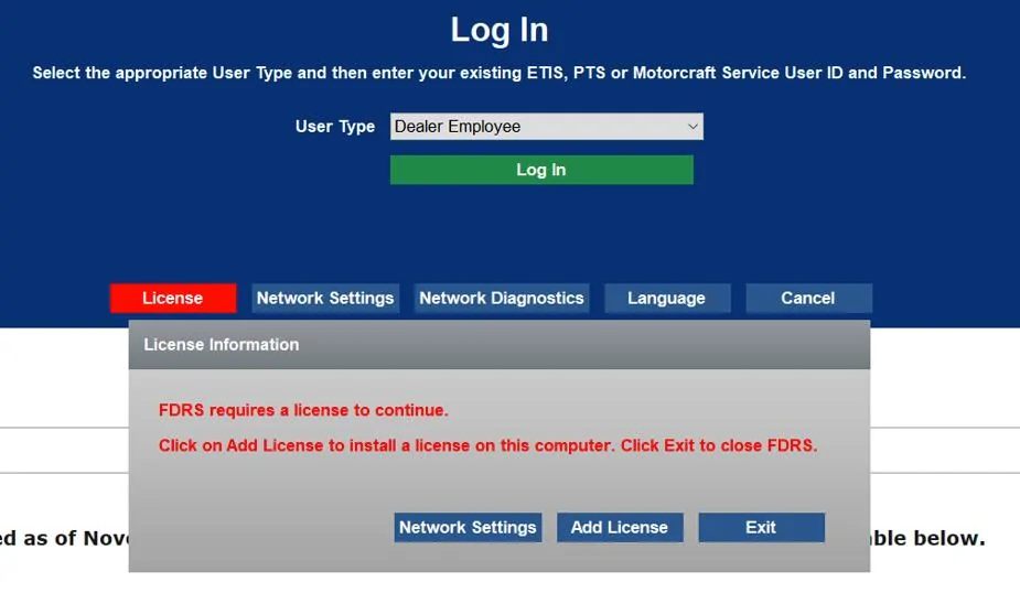

When you launch you should get this screen
Ford F-150 Lightning Lightning Software Updates using FDRS 1740529285907-kq

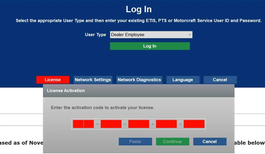

And when you click add license, you get this screen (but I think on mine it read my license from my PC. This screen was before I bought and was just testing)
Ford F-150 Lightning Lightning Software Updates using FDRS 1740529240216-jx
Only after you get past these can you click the green "Log In" IIRC.
It will then prompt you to login - use your Ford Account - not the Helm/Motorcraft one.

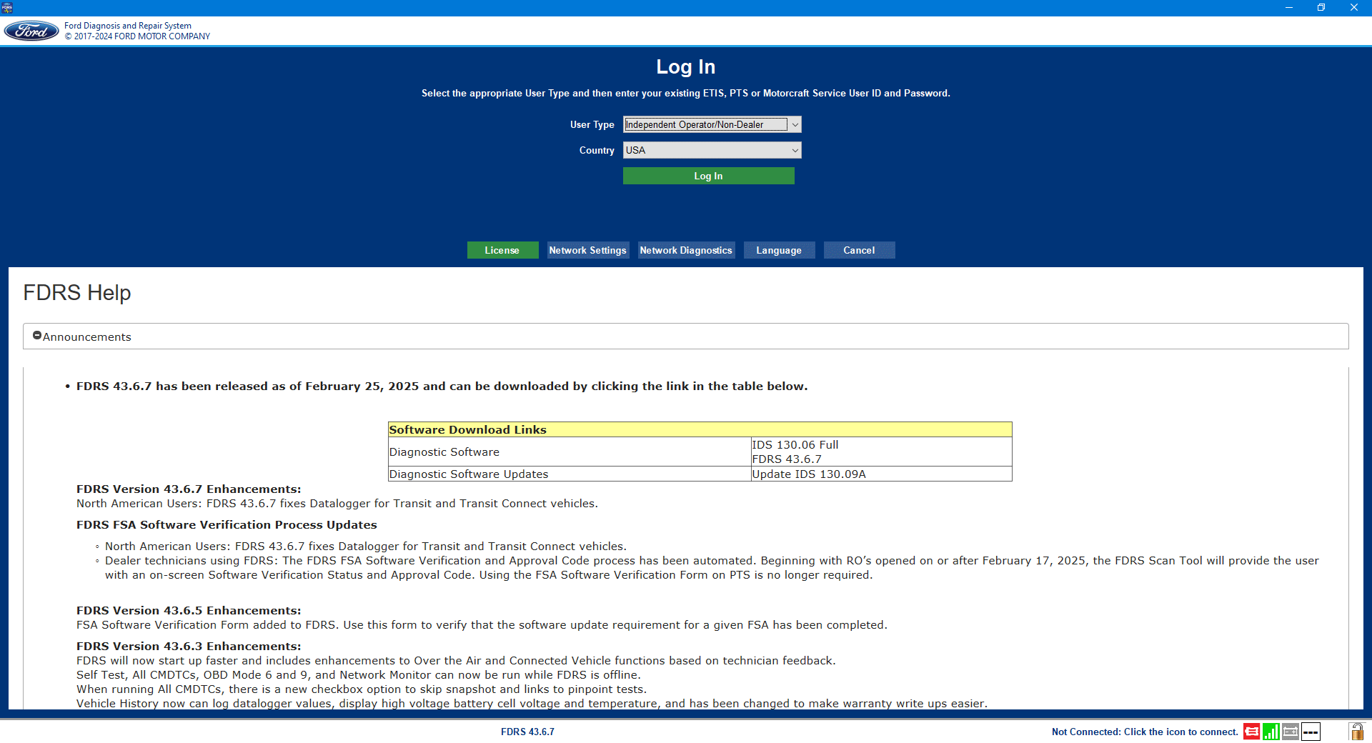

Should look like this when logging in.
Ford F-150 Lightning Lightning Software Updates using FDRS FDRS_Login_Page_43-6-7

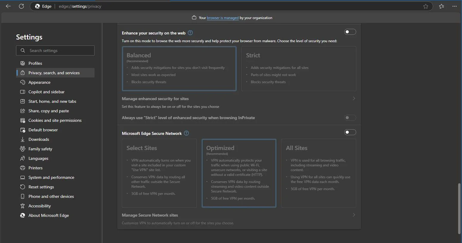

I have not gotten around to doing this yet...but eventually we are all going to have to update to Windows 11 since Windows 10 will lose support in October.
There are folks on this forum who have successfully installed and run FDRS on Windows 11 (for like two years now). But I've just been sticking with what works.
It is my understanding that one of the issues with running FDRS on Win 11, or rather one of the things to fix when trying to do that, is turning off Edge Secure Net in the settings for MS Edge. One of the forum members who was having trouble using FDRS on Win 11 said that he had to turn that off because the servers thought he was using a VPN.
So I've turned that off on my machine as well, just as a precaution.
Ford F-150 Lightning Lightning Software Updates using FDRS Edge_Secure_Network

Oh my gosh, I got in....
But I had to sign in with my Ford OEM credentials and not the Motorcraft ones. The 2FA prompt actually went though this time and FDRS showed updating software...I am now at user settings and I can see the Measurement Toolbox in back.
