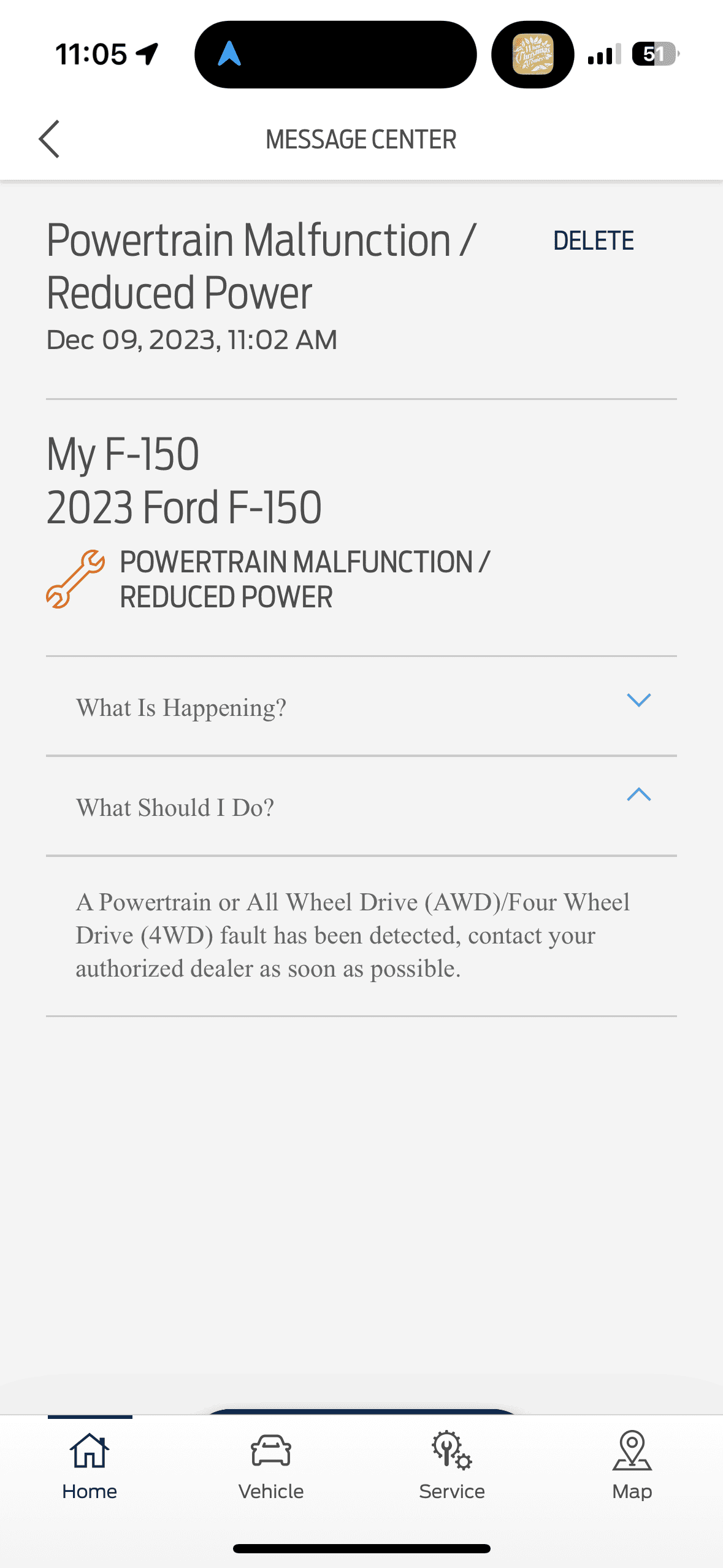

Would @rugedraw or @Mike G mind running my VIN (1FTVW1EV5PWG30179, SYNC 22326) for module updates? I had a Powertrain Malfunction code without actual power reduction happen this past weekend and it cleared after the next restart. It hasn't happened again since but am hoping maybe an OTA Update could fix it if it's software/module related. Still waiting for my first software update as I've had the vehicle for a month and a half with none so far. Dealer can't get me in for 3 weeks. TIA!

Not sure how I missed this, but here you go:
Ford F-150 Lightning Lightning Software Updates using FDRS 1702865137019
What happened that day seems to be an isolated incident.....a glitch in the matrix, so to speak. No DTC's were recorded that day that your truck hasn't recorded every other day. Keep the appt if you want, but I think your truck is fine. Dealers do not get paid by Ford to update modules, so I would not have high hopes they do it. 1.5 months without an update is not a long time. Your truck was built 3 months ago and most of the latest software on it already.
