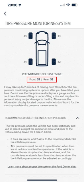

So I checked FordPass and noticed this:
Ford F-150 Lightning Lightning Tire Pressures (Door vs. FordPass) Lightning_tires_FP
Wow. they're really overinflated....

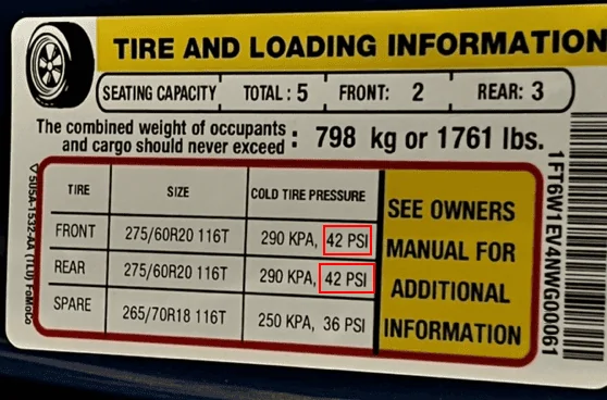

But just to be sure I checked the door...
Ford F-150 Lightning Lightning Tire Pressures (Door vs. FordPass) Lightning_tires_door
Hmm.. I guess they weren't that bad after all. ?
So I dropped the high ones down a couple of psi....
So don't believe FordPass...check the door sticker.

That is strange - I wonder if it is a carry over from the ICE pressure settings....

What did the truck display say about the tire pressure? Did that have the right information?

Yea I would believe the door sticker over food pass.. pretty sure a certification process has to go through for that door sticker to be produced.
It doesn’t say what the recommended pressures are just what each tire pressure is at that moment.

What does the door tire pressure sticker say for the 18" wheels? Can someone post a picture?

If anyone hasn't found out yet, that issue is the recall ford has on the Lightning. The 35psi was also the value for low tire pressure in the computer as well. The correct value is the 42psi
