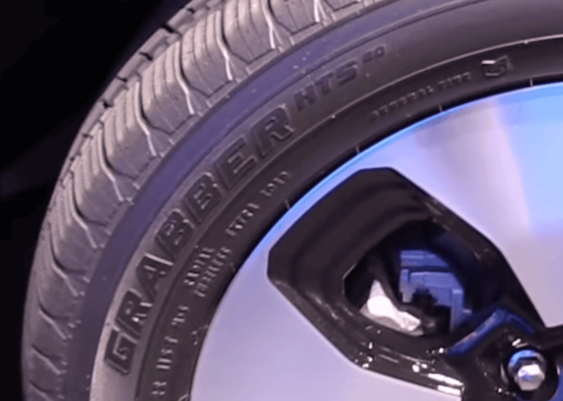

I've been pouring over videos trying to get closer looks at the tires, and the Platinum trim All Season most often is the General Grabber HTS 60. I've been looking for Lariat examples specifically, but haven't gotten as good a look yet

For those that are interested, I've found a few All Terrain tire options that are Severe Snow Service (3 Mountain Peak) rated and with relatively aggressive treads that are in the same ballpark weight class (in the 275/60R20 size) as the assumed OEM options (thinking primarily about how tire weight correlates to rolling resistance and impact on range). The Hankook Dynapro AT2's are the All Terrain option and weigh 41 lbs each (the OEM All Season Grabber HTS 60 weighs 40 lbs). The closest options are the Toyo Open Country A/T III and the Firestone Destination A/T2 at 42 lbs. The next closest are the Discoverer AT3 4S (44 lbs), the Hankook Dynapro AT2 Xtreme (45 lbs), and the General Grabber APT (45 lbs). Lastly are the Cooper Discoverer Rugged Trek (47 lbs) and the BFG Trail Terrain T/A (47 lbs).
For reference, my typical favorite, the BFG KO2 weighs in at 55 lbs. Thinking I'll likely go with the Toyo's as the best balance of weight, tread pattern/blocks, and performance. They actually have a higher Tread Wear rating than the OEM All Terrain Hankook Dynapros too. Warranties are comparable also, with a 5 year/65k mile warranty for the Toyo's, and a 6 year/60k mile warranty for the Dynapros.
All of this is per the info provided on Tirerack.
