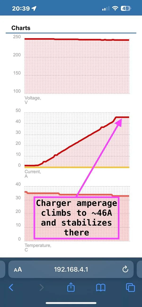

We just bought the Grizzl-E Ultimate 80A charger and are disappointed to learn our 2024 Platinum (ER battery) won't accept more than 46A from the charger. Grizzl-E's tech support sent me a spec sheet for the 2024 Lightning that lists its on-board charger with this label "19.2kW/17.6 kW (80A) Fleet Only" where, apparently, "Fleet Only" means it has to be the Ford Charge Station Pro Charger! This is extremely disappointing that Ford would limit a third-party EVSE and not specifically mention that ONLY their Pro charger will be allowed by the truck to accept 80A.
I confirmed the Ford-imposed limit of third-party EVSEs with Ford tech support.
Has anyone been able to achieve over 46A charging with a third-party EVSE?
