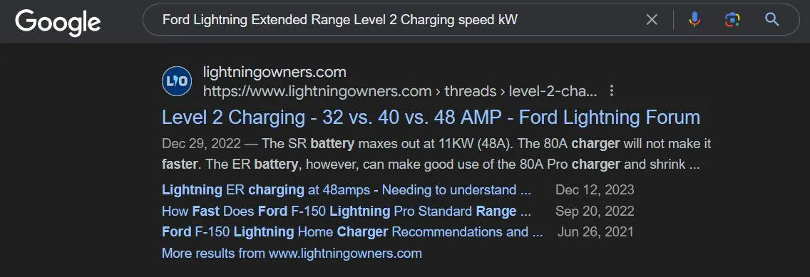

I'm betting if you went out right now you'd find more stuff saying the Lightning charges at 80A than not, by huge margins and you'd have to Google specifically the lower charging changeover. Add-in ANY kind of official communication from Ford that it has it and I'm sorry but I don't care if it's a chatbot or Farley himself but there's -0- call for making the OP feel like he was dumb here.
He's not going to be alone in thinking he has 80A on board charging and not actually have it is my thinking. Also, kinda BS to pin it on him.
First result for me that actually yields an answer is this, a few non-right answer, scroll, first answer.
Ford F-150 Lightning Lightning Won’t Accept More Than 46A From Grizzl-E Ultimate 80A Charger 1726347967772-im
Meanwhile, you go to Ford's site you see no mention of 48A max. If it said it somewhere prominently, 48A max, there could be some kind of argument for OP needing to know but they hid it behind numbers even veteran EV owners likely aren't going to divide too seriously to see.
They don't even list it on the window sticker. I'm sorry but the idea that literally anyone should have to go deep into press releases on janky blogs to understand what is going to be in their truck is ludicrous speak in my mind.

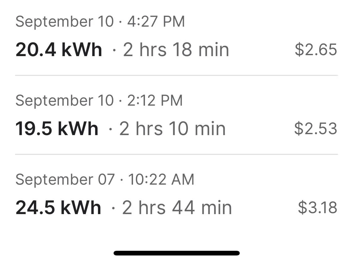

Simple actual owner experience to help level-set need vs want. 40amps. You can extrapolate for your nightly charging requirements.

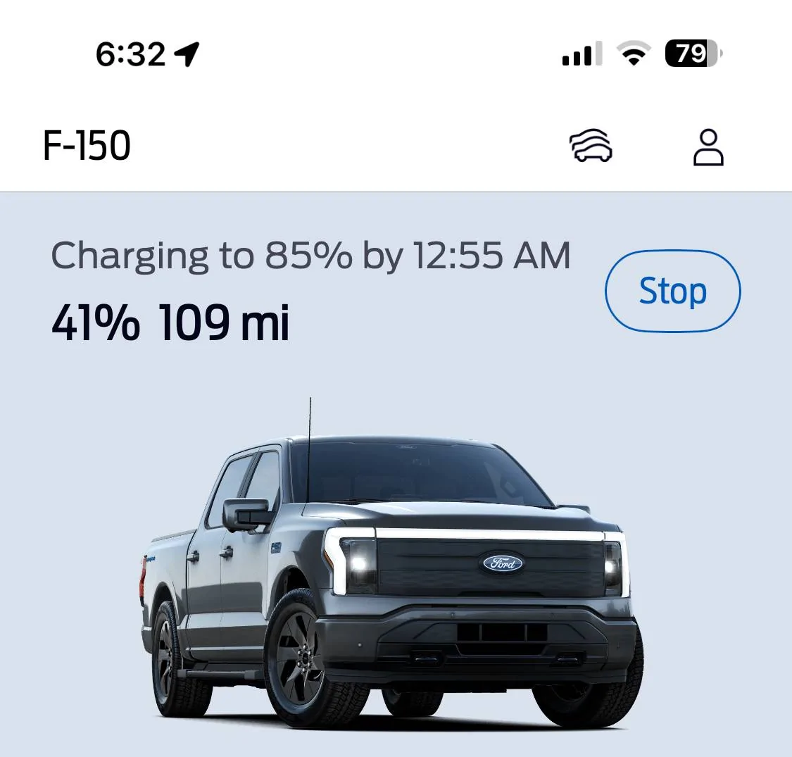

All good here. No judgement. I am happy for everyone who has an EV. Saw a ton of them at Electrify Seattle today.
Just in case someone new comes across this thread, here is what a charge day looks like, half-way though, when I haven’t driven a ton lately and my last charge was several several days ago.
Again, for anyone new to EVs, a typical home charger is just fine for almost all of the time.

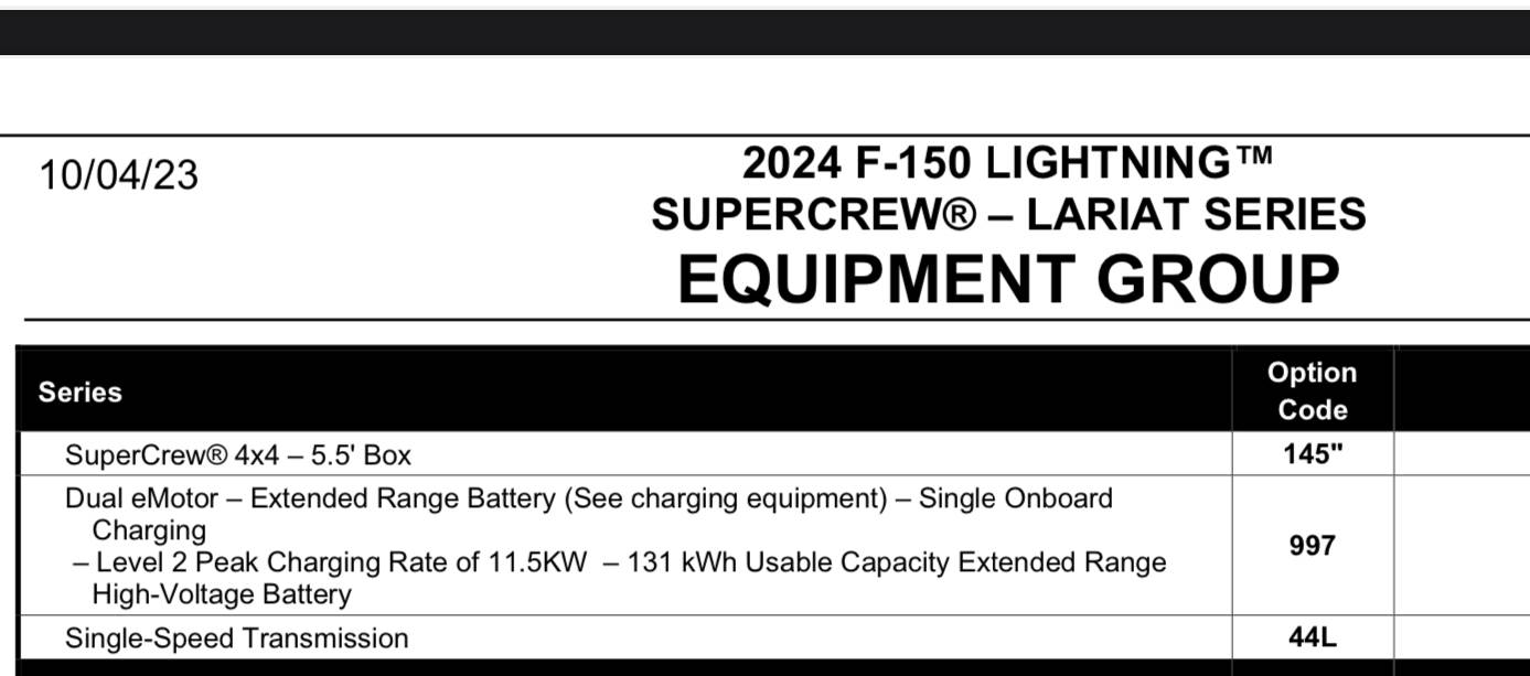

Grizzl-E's tech support sent me a spec sheet for the 2024 Lightning that lists its on-board charger with this label "19.2kW/17.6 kW (80A) Fleet Only" where, apparently, "Fleet Only" means it has to be the Ford Charge Station Pro Charger!
Piss Poor Documentation by Grizzly for inaccurate depiction of limits of scope depending on the vehicle equipment, yes, the very rare bird of a PRO-ER [FLEET ORDER] has that capacity, while everything else doesn't, that should have been documented by the EVSE manufacturer.
Piss Poor communication from Ford Tech Support, not knowing the product for MY24, not surprised.
