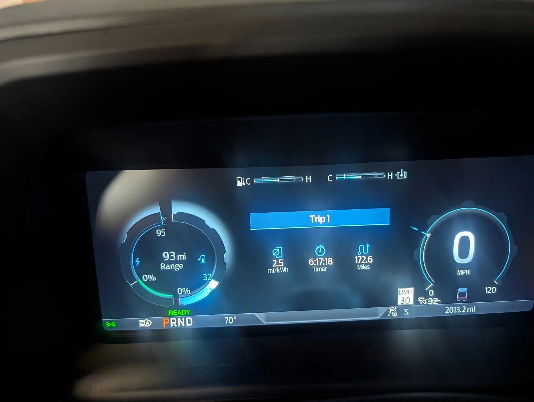

This is where my head went. Not sure if it's possible now, but can @FloridaBreen look at "Trip 1" stats again and see what the trip timer reads? That way you could see if someone turned on the truck as the timer would capture that time the HVB was being used.
I was interested in seeing this statistic also, would lend credence to the teen listening to dad's sound system on the garage, might have been tempted to back out the truck but then realized that would log miles so they pulled it back in.

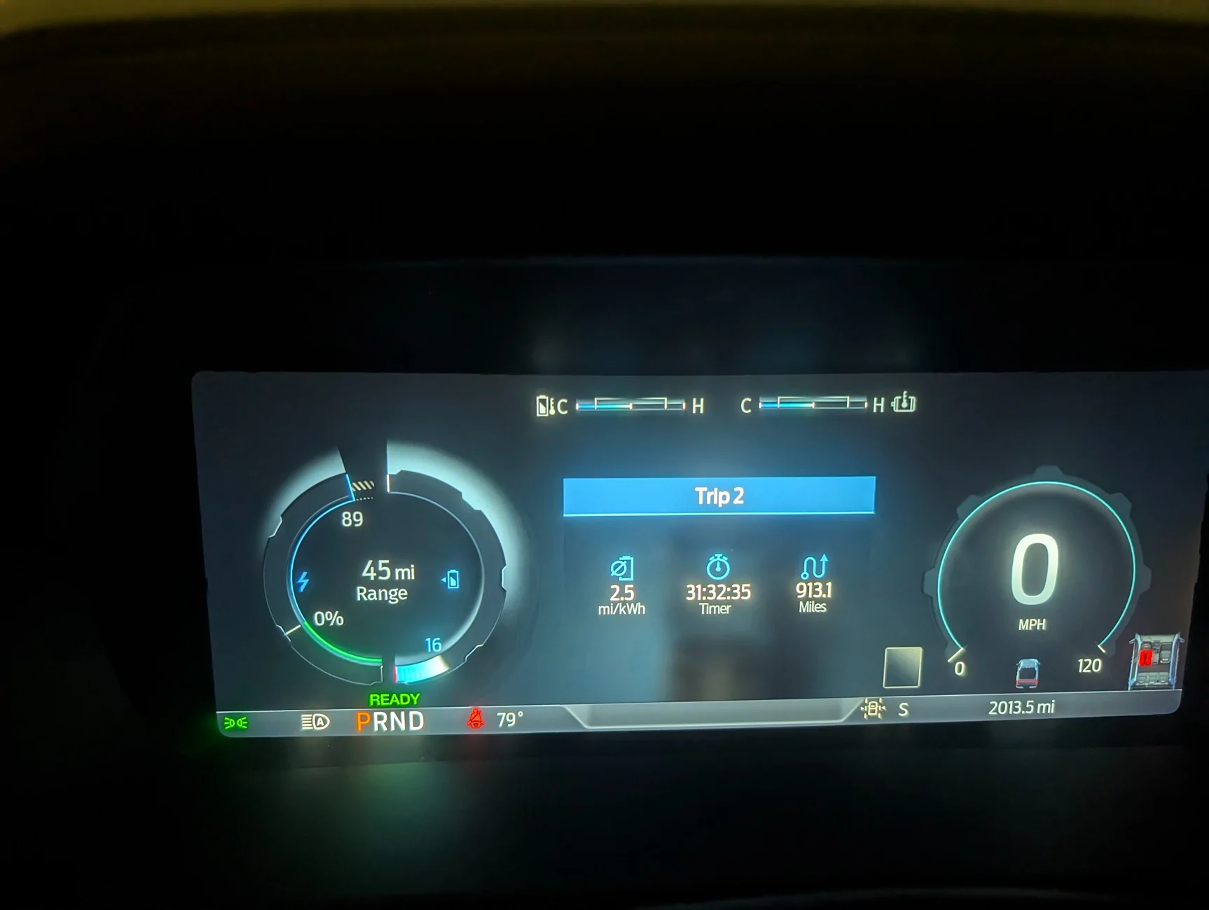

My concern is where did 16% of charge go. Tbh I don't know if I put it in gear once or twice between Feb 13 and today, almost positive it didn't travel more than a foot or 2. I recall planning on driving it once but noted that the charge was low 27% and deciding not to take it for a 60 mile trip. It's been a while since I last charged it to 100% to balance the cells. I rarely drive much more than 30 miles round trip and don't drive it more than a couple times a month. Looking back I realized the really cold days were earlier than Feb 13. It's charging to 90% and I'll be taking it for a drive tomorrow 50-70 miles round trip. Plan to recharge it to 100% then see what happens. I've never fast charged an don't have time to get it to 100% before tomorrow's trip.
Charge the truck to 100%. Let it sit for an hour past completely charged. Since you haven’t gotten it to 90%+ for some time, the truck may need to charge to a higher level, near 100%.
Odd things may happen. You may see the truck charge to 350 to 360 miles range. Another thing to consider is did you kept waking up the truck all this time to check on its condition, willingly or unwillingly. Check the APP for the settings. Never had my truck drained of that much battery energy since I got it. I have traveled many times for more than three weeks and left the truck outside my garage. Didn’t disturb it from its sleep even once. No battery drain even after 3 weeks of inactivity.
Here is a story familiar to me. I was one of the fortunate owners who was able to track the Lightning’s progress since it left the factory in Detroit. Ford dropped the truck at the rail yard with 54% SOC.
Since I found out I was capable to communicate with my truck, I kept waking it up every few hours to track its movements towards me. It took almost 30 days to see my truck at the dealer.
As I said, it had 54% and arrived at the dealer with 51%. Since it was the first Lightning at the dealer, there was one of those “let’s take it for a spin to see what it can do”, kind of thing. They brought it down to 48%.
My constant tracking brought the battery down after nearly 30 days by 3%. Check your settings, you may be telling or asking your truck to do something you’re not aware of.
