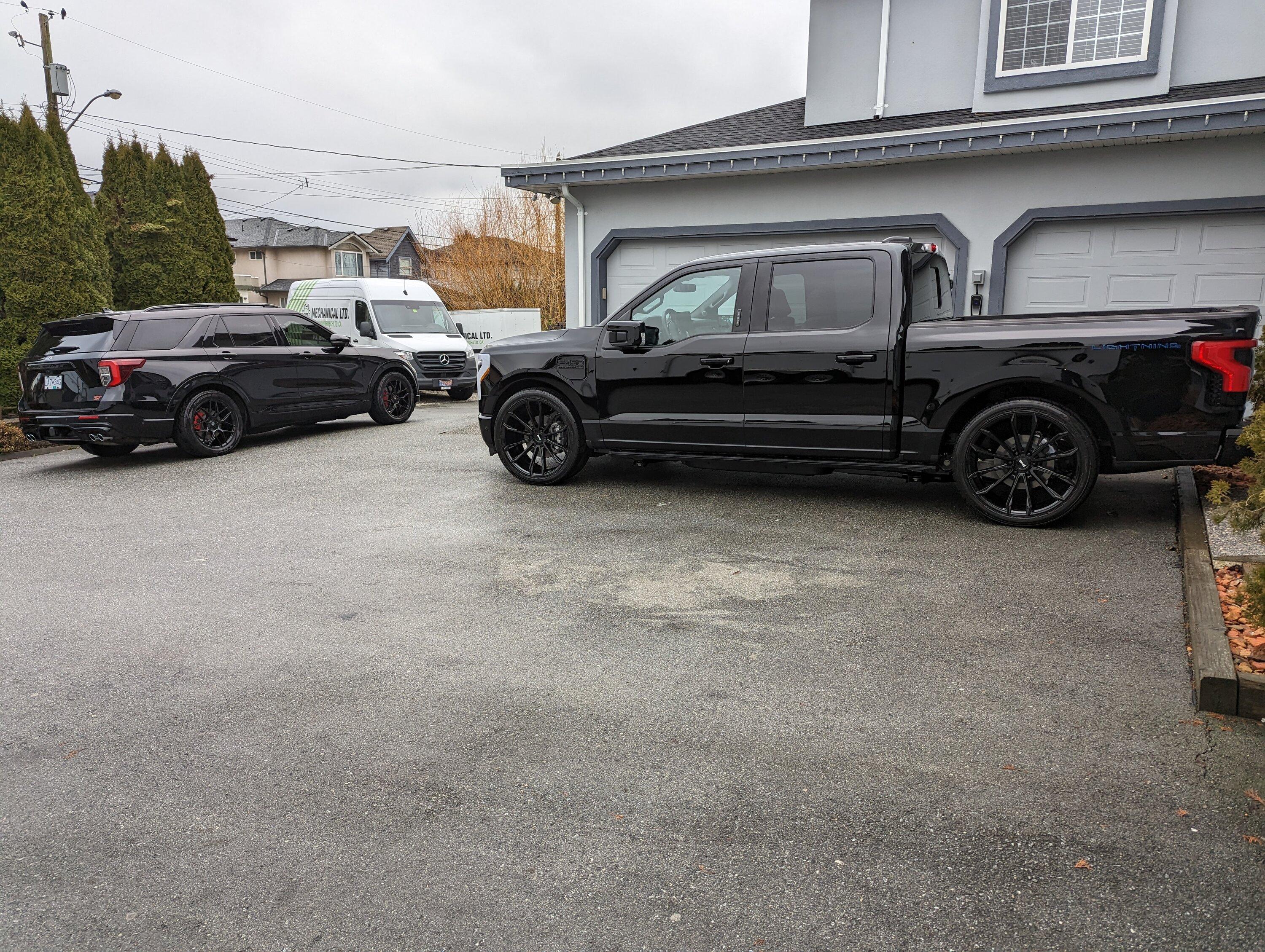

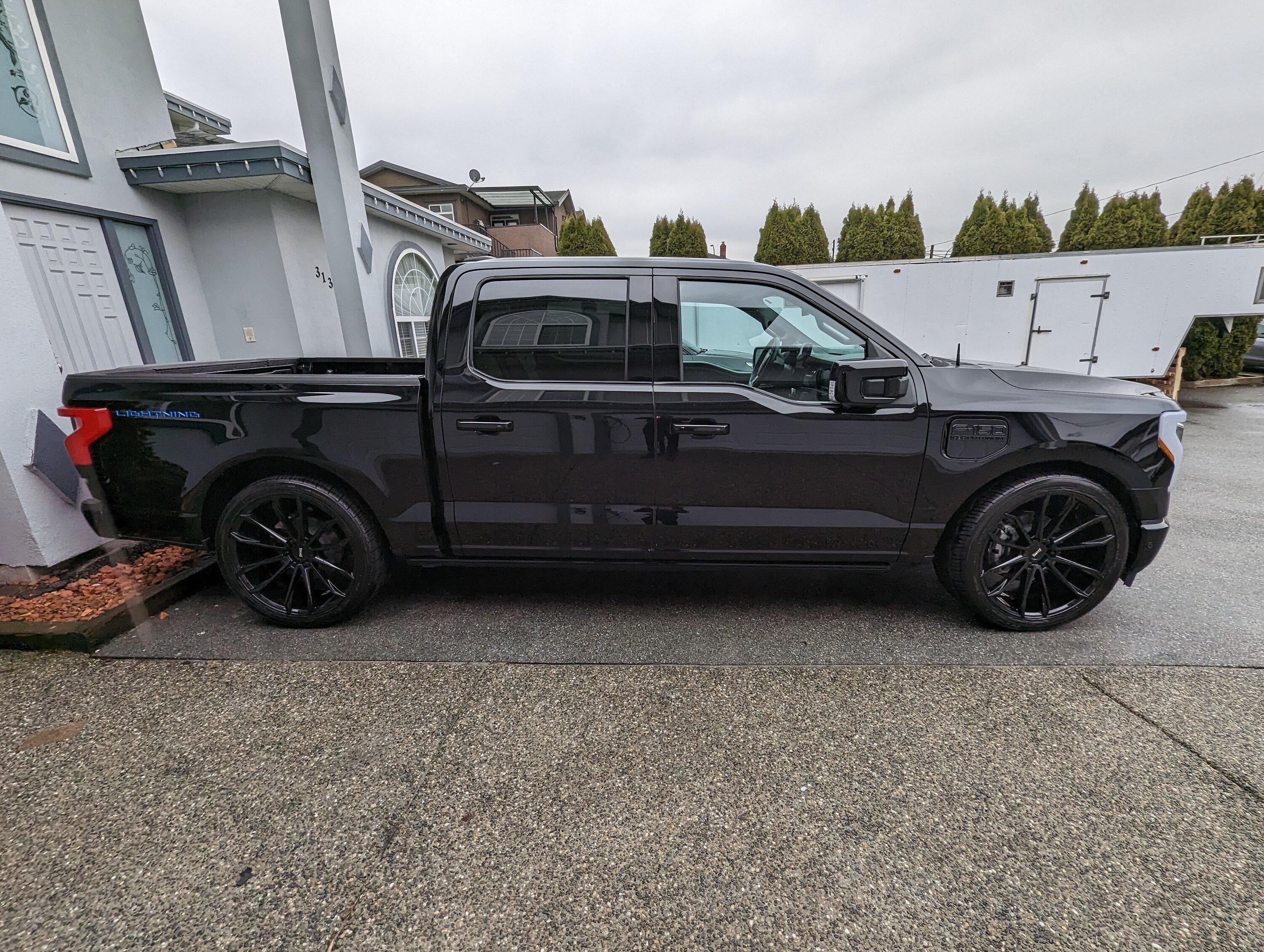

Hey Guys, belltech part number 25001 is bolt on for the rear and gets 3" of drop. Everything works as per factory specs except on board scales. There's a ridetech air strut that bolts into the rear for a 6" max drop, which is what I switched to now. Front is basically any ICE f150 lowering strut.
Something weird is going on with that part #. Went to their website and it speaks of exactly what you speak of and the pic shows it to be an actual strut but then goes on to state it fits all older model years like my other truck that's a 2013 and it most definitely does not have any suspension altering properties as it's a solid rear axle and uses a regular old shock, lol. whiskey tango foxtrot
