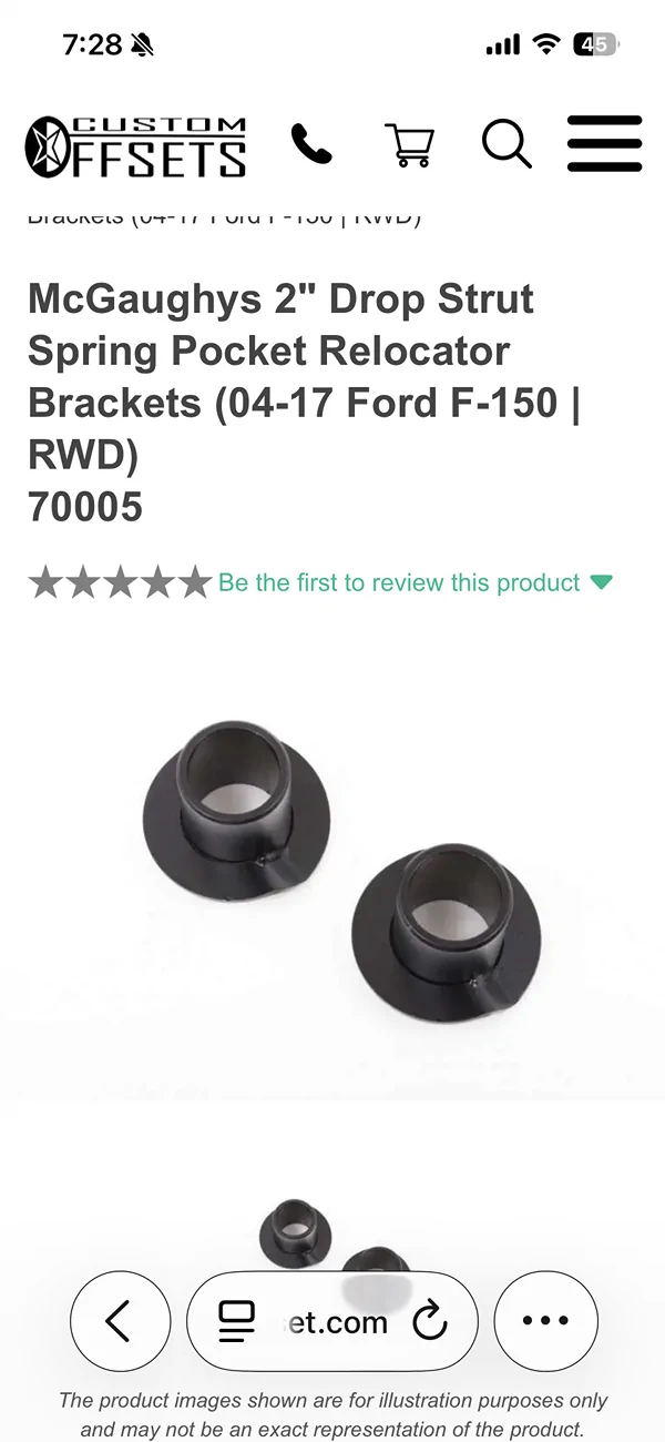

I used these to lower just the rear of my 22 lightning a couple of years ago. No issues at all. Lowered it about 1.5” or so.
Could you post a picture of these installed? What are they made of? What holds them in place?

I can confirm the McGaughys drop pockets (70005) work on the rear of a 2024 Flash to lower it about 1.5 inches. The rear end of my truck is not as stable/sorted at some of my highway cruising speeds in this thing now.... I need to figure out a stiffer strut now and wouldn't mind lowering the front about .5 inches to sort out a little bit of front end 'wandering'..... I was thinking about putting the Eibach shocks in the rear but they state they are for a 0-1inch lift and I thought I saw someone mention they really stiffened it up. I'll try to get a pick of my truck parked level later on to post and show the updated stance.
