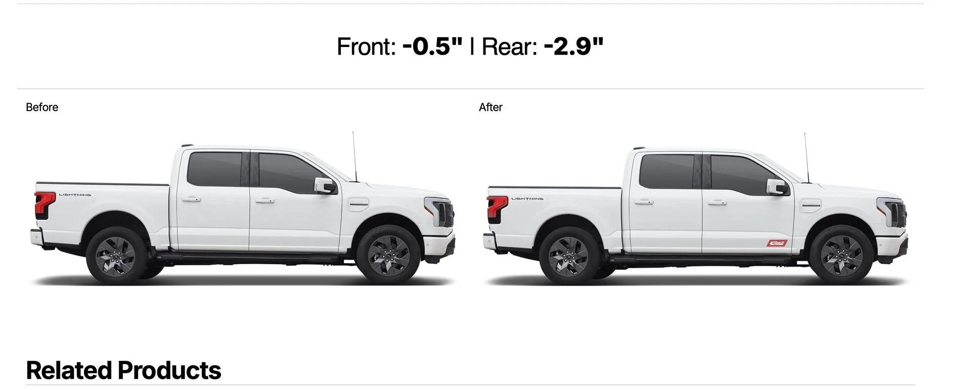

So essentially Eibachs either lowers the front a minimal amount in and significantly lowers the rear to get it level with the front. I think the front lowers like .5 while the rear lowers 2.9. If you look at your front now it will essentially stay the same as .5 at least to me makes 0 difference.
With the Icon I think you can lower the front a lot more but then have to deal with camber and ride quality. Eibach is set while with a True Coilver you can do what you want. If you look around at this pic there's very little difference in the front, the lowering comes from the rear.
I went the opposite with lifting, so my front is lifted to match the rear full Eibach Shocks/Springs front and rear. The ride is exceptional, ride quality is close to stock and handling is amazing. EIbach did a great job with this combo. You cant go wrong with them, they have significant history in the suspension game.
Eibach makes good stuff. The Ford F150 lightning has a standard front suspension which lowers easily. You don't need any sort of kit to lower the suspension. You do if you lift the suspension, you're going to need longer control arms to get a proper alignment.

Only thing you need if you lower is the Icon Rear Camber kit with Eibach.

Completely agree. Even lowering the rear 1.5 inches created unattractive and completely unacceptable camber
