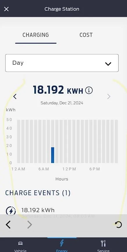

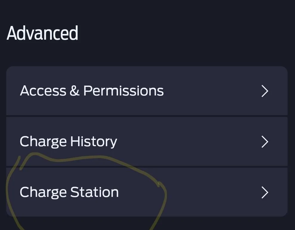

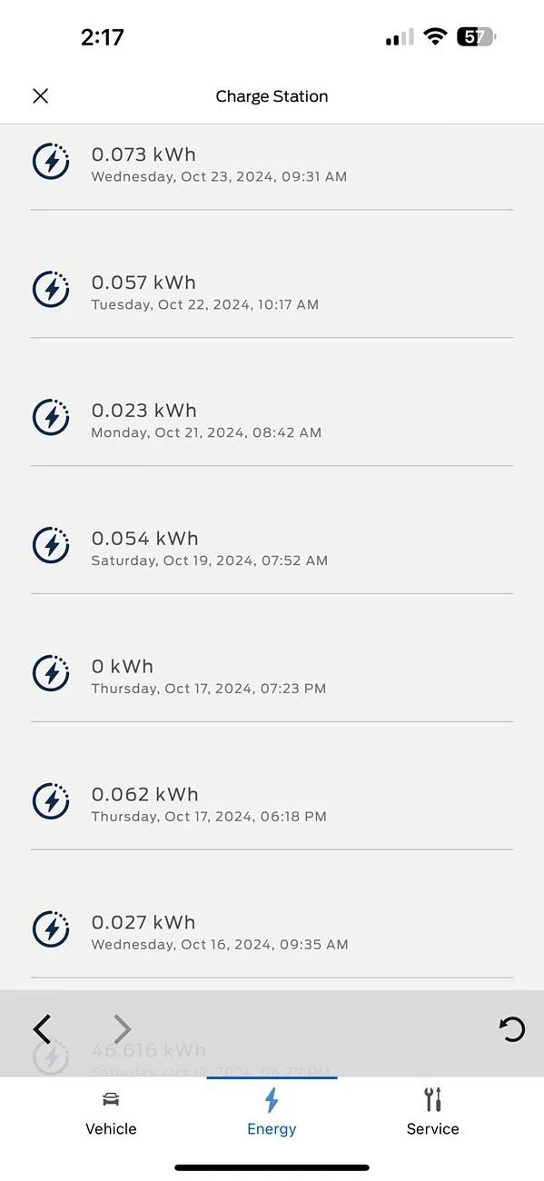

LOL .... assumed you're using the Ford FCSP as your EVSE, if you aren't these instruction won't be useful to you, but maybe other watching from the sidelines can learn something....
Fordpass, Energy tab, Charge Station
Ford F-150 Lightning Math hard 1734825856986-68
Insights
Ford F-150 Lightning Math hard 1734825887668-6d
Detailed records by the day, this data populates after unplugging from a charging session
Ford F-150 Lightning Math hard 1734825977849-nk
