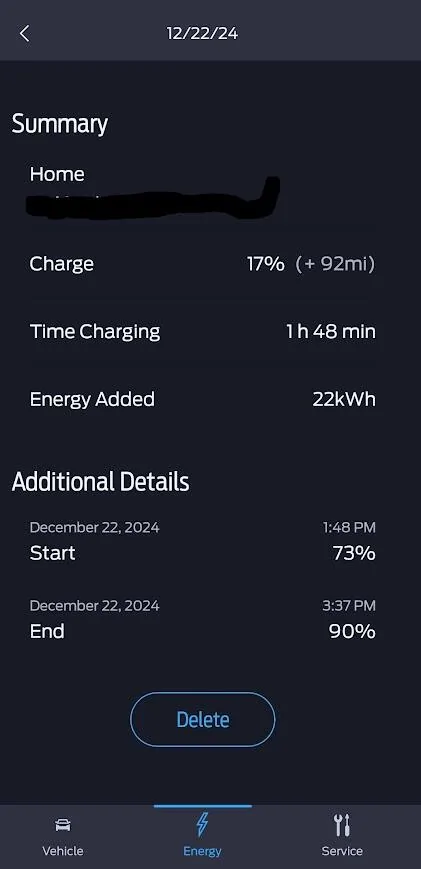

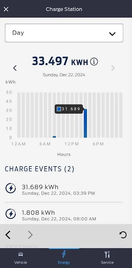

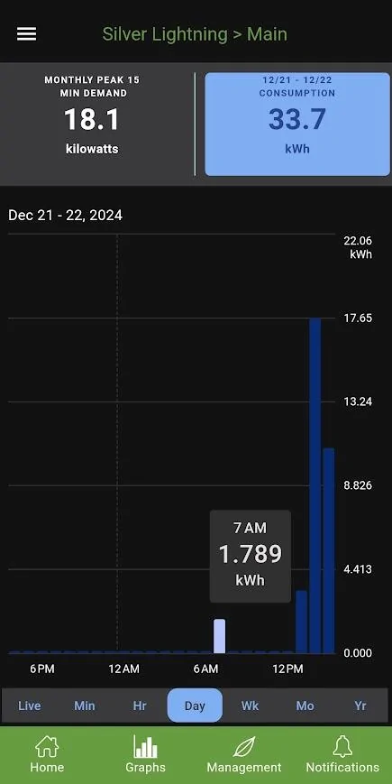

Another observation about how level 2 charging in very cold conditions causes battery warming from not only by the act of charging but also the PTC & circulator pump is more active.
I close my weekly charging log on Sundays, the truck had not been charged for the prior days driving, local temps have been as low as 11, and today's high was 21, the local trips brought my SOC down to 73%. The available energy to the motors was limited to 87%.
Once the day's travels were done, I plugged in for another top off to 90%, the 17% increase should be ~22.3 kWh of traction energy under ideal conditions.
Actual energy consumed from the grid, 31.91 kWh per Emporia, 31.689 kWh per FCSP log file, and 29.3 kWh per the active charging screen last I seen before the truck reached 90% then it disappeared, NOTE if you want to see that value again, just click the START charge button to trigger the "to 100% function" for 30 seconds to see the closing value, then STOP the charging process.
The Fordpass Charge Session log shows that I put in 17% and it's value was 22 kWh of driveable energy. The extra 7 to 9 kWh is attributed to conversion loss and thermal management of the battery.
NOTE, this morning I was plugged in but not charging nor pre-conditioning, I only used remote climate start and consumed ~1.8 kWh of energy to warm the cabin for 15 minutes.
The ETA to charging goal was pretty accurate, initially said it would be done about 3:15, then as the process continued it updated to 3:35, the Emporia log shows 3:36, I unplugged the FCSP at 3:37.

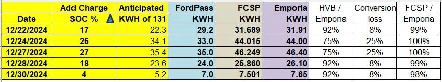

Been keeping the truck plugged in at night since the weather has been getting down to the 30's lately. No charge history the next morning for that night UNTIL I unplug the FCSP from the truck, then it appears within a minute or two.
That's normal, it should be the total of all energy sent to the HVB, to impute the total grid energy, divide the kWh shown on that report by .92, this is generally how it's been spring, summer & fall, but lately this cold season the energy to condition the battery spontaneously overnight or when doing departure time, or remote start isn't being captured accurately by that report, in my case the discrepancy jumps from 8% to 25%.
Folks in milder climates this factor might not be as bad in winter.

So 92% efficiency when charging, good to know the approximate energy lost to the charging circuitry etc. I'll have to use that when I calculate my cost to charge.
When I first plug it in before charging time has arrived, it tells me "<1kWh" is being used - to keep the battery warm I presume.
I also noted that even though I set the charging to begin at 1:00am, it always tells me it started a few minutes earlier, 12:57am for example.

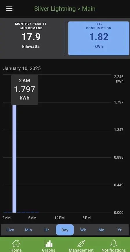

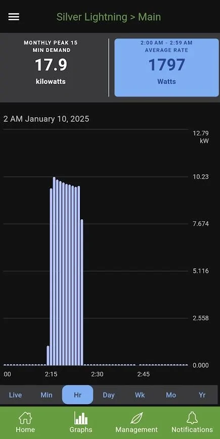

Last night my truck had another round of spontaneous battery conditioning due to cold weather, this time it kicked on at 0211 and for 12 minutes, used ~1.82 kWh of energy. My timed charging schedule always start on the dime, though this week, I'm not charging until Sunday end of travel day, and will immediately start charging when I plug in.
This weeks study is to measure the total weekly energy for battery maintenance and morning remote start in cold weather, this value is going to vary week to week through the season depending on how cold it is.
Tiny amounts of energy seem to flow between EVSE and the truck, I think it's just background noise that the ferrite loops are picking up from the lines.
