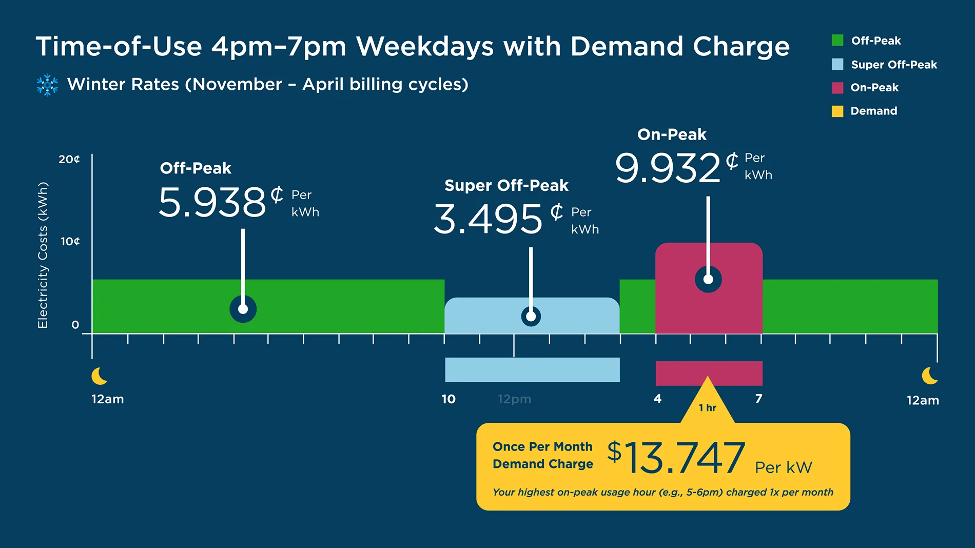

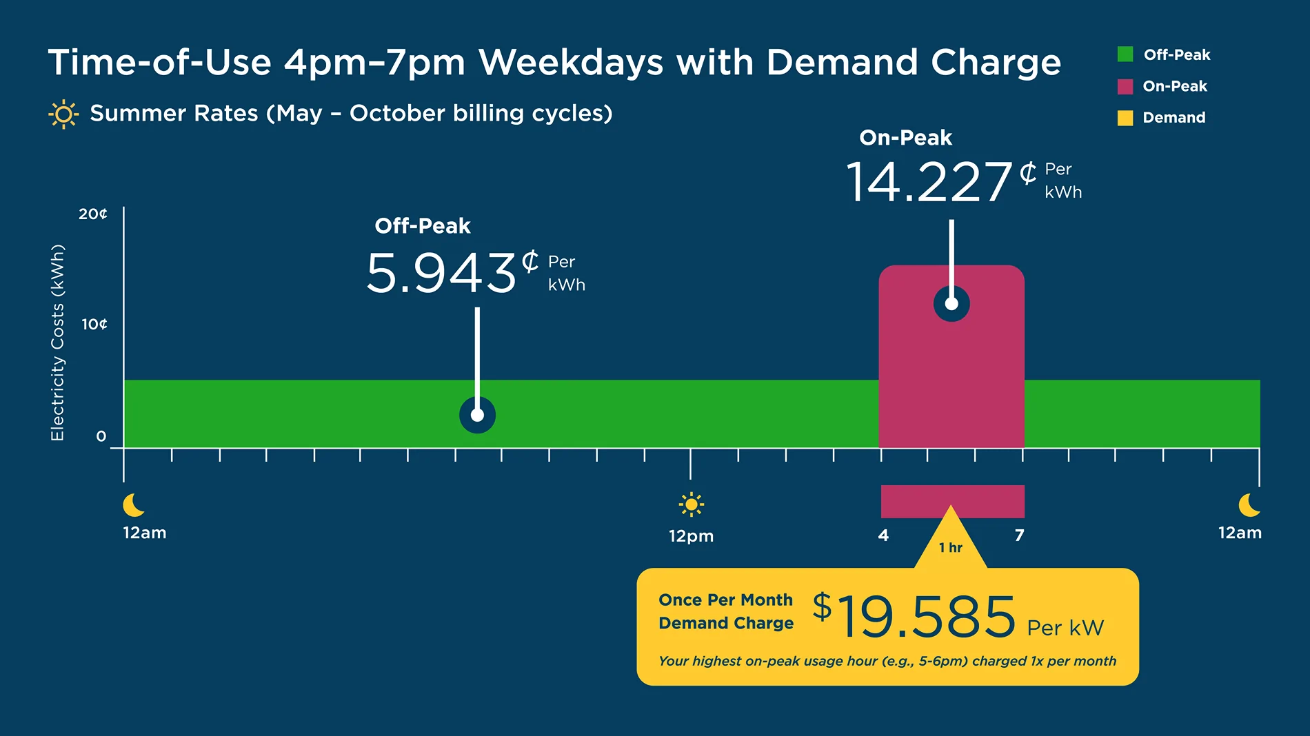

I have had my 2025 Lightning FLASH for a little over a year now and have a little over 17,000 miles on it. I decided to do a calculation of what it costs me per 100 miles to drive my truck. I live in the Phoenix metropolitan area and during the summer I average about 2.3 miles per KWh and in the winter I average a little over 2.6 miles per KWh. I decided to use 2.5 as an average for my calculations so I use about 40 KWH per 100 miles. I have a FCSP at home and charge exclusively at home except when I drive to LA or up to the mountains. My FCSP shows that I use between 7.1% and 7.5% more energy to charge my truck each time I charge. I decided to use 8% to be conservative which means to add 40 KWh to the truck I will use 43.2 KWh from the power company. I charge only at night starting at 10 PM and the rate I pay through my power company is 5.943 cents per KWh off-peak in the summer and 3.495 cents per KWh during super-off-peak hours (10 PM to 3 AM) in the winter. If my calculations are correct then the cost to drive 100 miles is $2.57 (43.2 * .05943) in the summer and $1.51 (43.2 * 0.3495) in the winter. Why would I ever spend money on gasoline again if my calculations are correct?
This is only the cost for the energy, not for the distribution. Check your electric bill, there are other (sometimes 5 or 6) charges (per KWhr) besides energy.

The advertised cost per kWh on our utility plan is
Winter: $0.12351 off-peak, $0.03495 super off-peak, and $0.32543 peak
Summer: $0.12345 off-peak and $0.34396 peak
For us, last month’s effective rate was $0.15/kWh.
I believe Arizona requires the utility to give you the $/kWh effective rate. Find that on your bill and use that cost rather than the advertised rate.
Got it. Those additional charges add $.02690 per KWh to the calculation. That raises my summer cost to $3.72 per 100 miles and my winter cost to $2.67 per 100 miles. Still way better than ICE.
