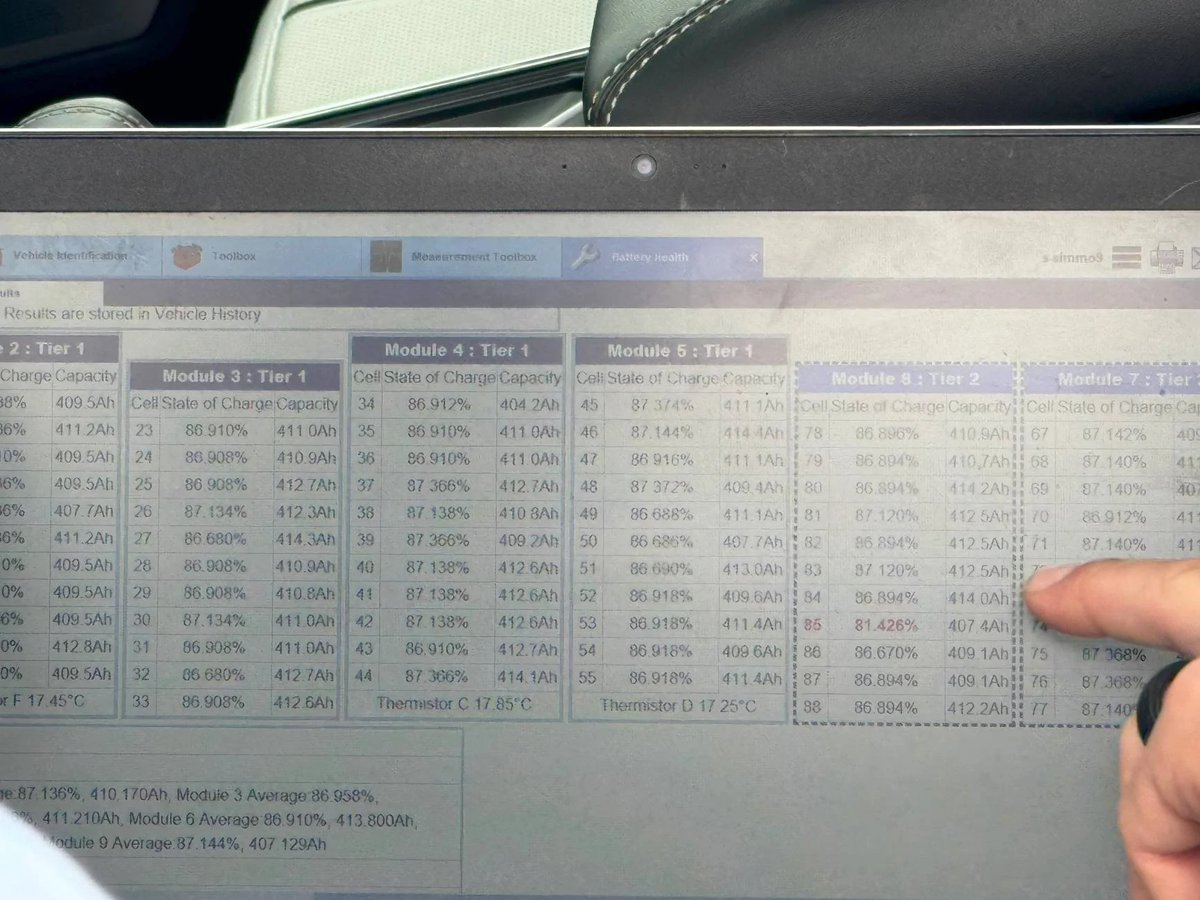

I took it back to Ford dealership and they told me that several battery cells were faulty and it needed a whole new battery.
I would ask to see the diagnostic report on that.
Due to the modular design, it would be highly unlikely all the cells are bad, you'd be the first I've heard of.
Most likely it just needs a module replaced due to bad cells in the module and not the entire battery.

As @Heliian stated, it won't be a whole battery pack. If anything it just be a module which takes +/- 2 weeks to get repaired. I had it done to my truck as well.
Talk to the dealer and get the battery report, which shows which cells where bad. It will look something like this:
Ford F-150 Lightning I Need a Battery Replacement at 1500 miles. IMG_1832(2)
