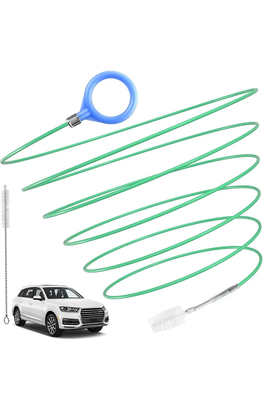

Being that the sunroof is so finicky, I religiously perform that TSB every 6 months usually in the fall and spring. 1 tube of the Krytox is good enough for the whole year. I also clean the drains out with warm soapy water and this drain brush from amazon

Exactly what the noise was. A little silicon spray into the seal. And noise disappeared. Thanks men. And the drain tool is next on the list.
