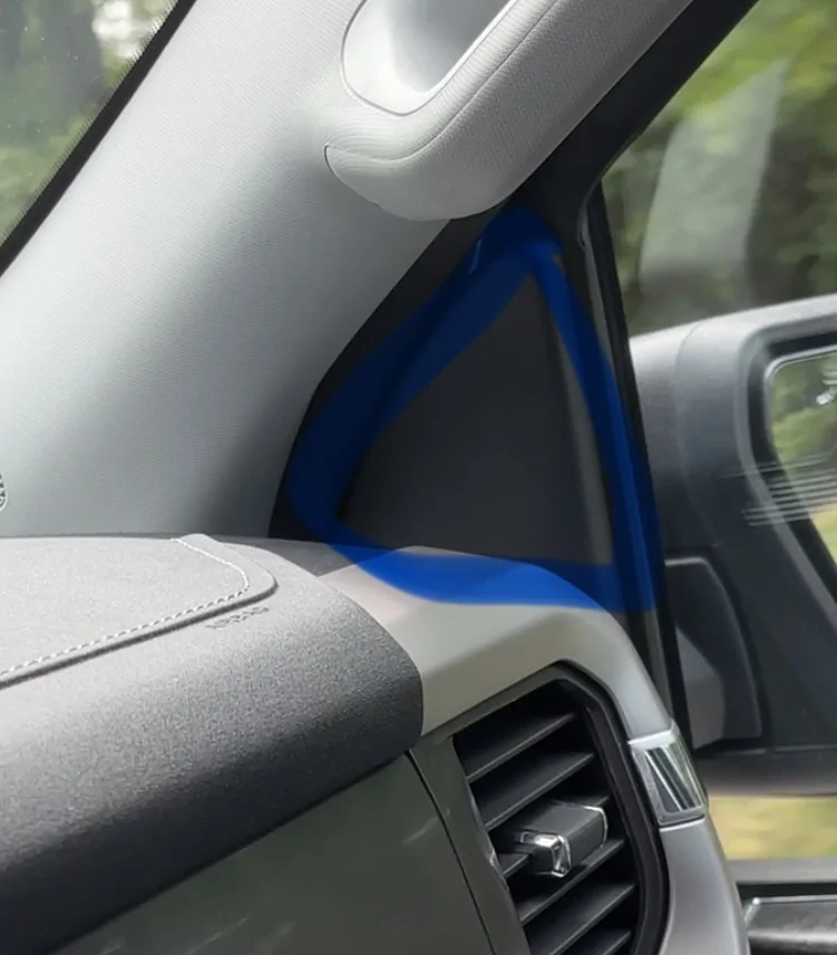

I had a very similar problem and it was the small triangular plastic piece that is on the interior door area where the mirror is. It was basically clipped in slightly askew so that every tiny little twist that the truck did over bumps made it click. Reseating the plastic cover made it go away

This is the sound, yes.
If it was like mine then it's this triangular plastic trim attached to the passenger door. All I had to do to fix was reseat it. Looking head on at the piece with the door open dig your finger nails under the trim and pull straight toward you. Should pop right off. You can use a plastic pry tool if it makes you nervous about breaking a tab though. Then simply shove it back into place.
I haven't heard the noise since and that was over a year ago.
