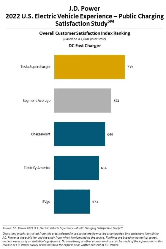

Yeah, it's not even really debatable that, overall, that EV drivers are happier with Tesla's network. Poll after poll agrees. Virtually everyone who has used both extensively agrees. And anecdotally, the amount of complaints about CCS dwarfs Tesla despite being far, far fewer CCS cars road-tripping.

Satisfaction polls show Tesla is far higher (see Zprime's post), charging difficulties WAY lower (per PlugInAmerica), people who have used both extensively generally agree Tesla is superior (see Out of Spec Motoring, for instance, who does TONS of road trips and testing), etc.
Way to spin! A 26% dissatisfaction rate for NACS charging does not qualify as making people far, far happier than the 33% dissatisfaction rate for all DCFC charging. Supercharging currently only has to work with one brand of EVs, that satisfaction rate is probably going to plummet when EVs from a half dozen EV models from different manufacturers start trying to Supercharge.
A 26% dissatisfaction rate also indicates that 1 out of 4 people were dissatisfied with their NACS charging experience, that’s hardly a statistic to be proud of.
Speaking of spin, nice try using the "average" when the only network that's above average is Tesla. You should compare Tesla to the average of CCS, not the overall average which Tesla brings way up because it's so much better.
The average of the 3 CCS networks on there is only 610, meaning 39% dissatisfaction, which is 50% higher than Tesla's 26%.
But anyway, you've now stooped to semantics of what constitutes "far" or "way" happier to pretend like Tesla's network isn't much better, which is nearly unanimous in polls and opinions from people who have used both.
Silly strawman. I never said I was "proud of" any of this. There's room for improvement with all networks. I just disagree with your implication that NACS is unreliable because it's weaker than CCS, when tons of polling and data shows otherwise.
