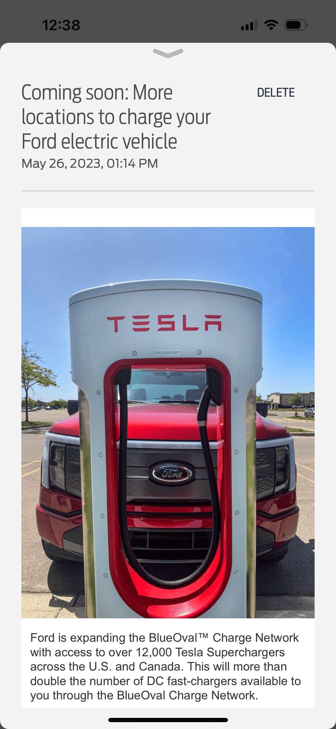

I am fine carrying a NACS adapter for my F150 Lightning. The ability to use CCS and Tesla Superchargers is a real competitive advantage. I am sure that buyers of NACS adapter Fords will be carrying CCS adapters as well. If we have a mix, and you can charge at any of them, that’s a real win.
Now, I just can’t wait to get my adapter. I will be watching the message center for updates.
