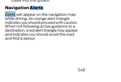

While using Ford Sync maps, I will receive ALERTS for school zones, traffic and stop light cameras.
I think it's safe to say that the double chime is from navigation alerts even when I'm not using the Ford Sync maps. Over the past couple of weeks, everytime I hear the double-chime, I jump over to Sync maps and there is some sort of traffic alert on the screen.
