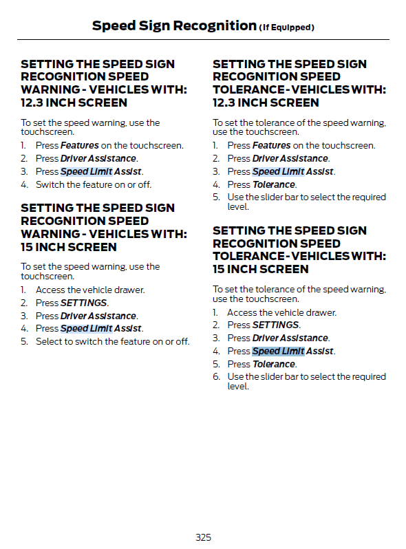

Not sure, but if you have it activated to recognize/see/alert for the "speed limit" sign/change. That might be something to check. Just a thought. I turned that feature off when I first got my 22 Platinum. Again, not sure, but something to check...
Where do I find the the option to activate the speed limit alert? Is it only available with Blue Cruise or adaptive cc?
