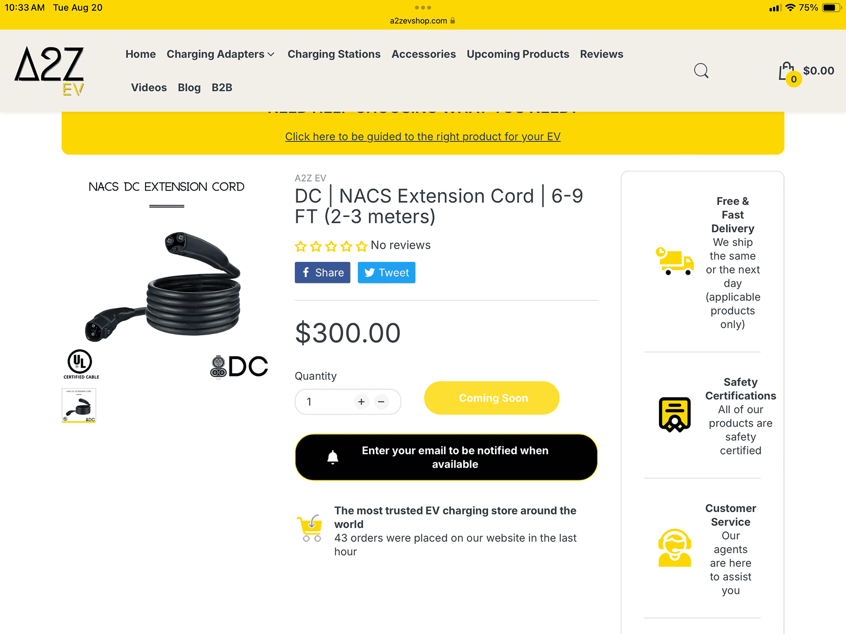

It's sort of a silly exercise, since Tesla and A2Z are coming out with extensions. And, having charge with the truck at Tesla locations, it's also not necessary.
Honestly - I have just completed a 2,800 mile road trip using almost exclusively Tesla stations and as long as you pull up sufficiently close - there is no need to have an extension. It will be nice when they add longer cables someday but I would not risk damaging the adapter or possibly causing expensive damage to the truck by MacGyvering an extension to the adapter - just not worth the time and risk in my opinion.
It's fine until it's not. El Centro, CA gets pretty busy since it's the only place between Yuma and San Diego. 8 stalls, one of them broken at the super charger. When there's a line of people waiting, there are only a couple you can access without blocking others off. I see value in it, and may buy one just to not be an a-hole in that situation.
