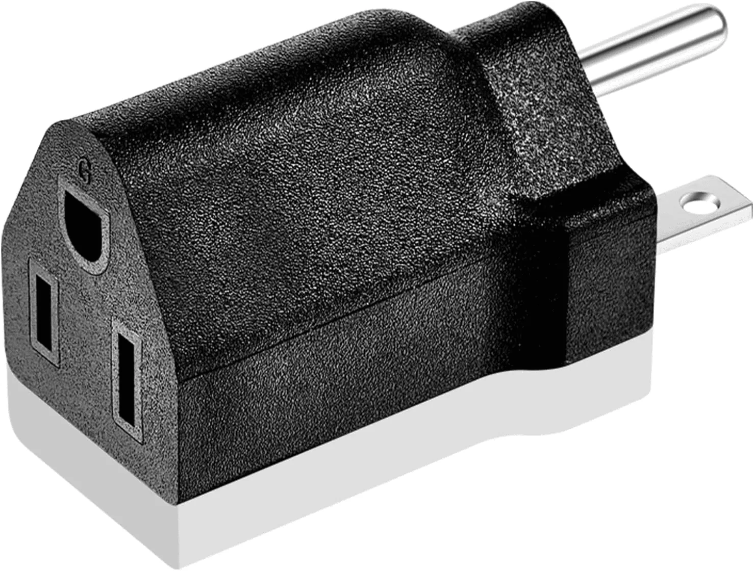

4,283
5,713
both of my youngest son's BOLT EVSE charger modules will do the same.... if you want 240v rather than 120v, and you have the correct adapter... TWICE the speed, and with the Bolts, the vehicle center screen allows you to switch from 8amps to 12amps... so, with 240v power, you'd get equal to '24amps' of 120v power... that's twice the 12amp option, or 3 times the 8amp speed.
That’s a nice, compact adapter. I wonder if those are sold somewhere?

This works well. Be sure to label it "FOR EV CHARGING ONLY":
https://www.amazon.com/gp/product/B07GZBZCYS/
I don't have a 14-50 socket in my garage but I do have a 6-20 for my compressor, I bought this adapter and the VEVOR 32 amp EVSE. It has adjustable output of 10/16/20/24/32A. It worked great at 16 and 20A (circuit is 25A). FCSP is now installed so this will become my frunk traveling EVSE.
