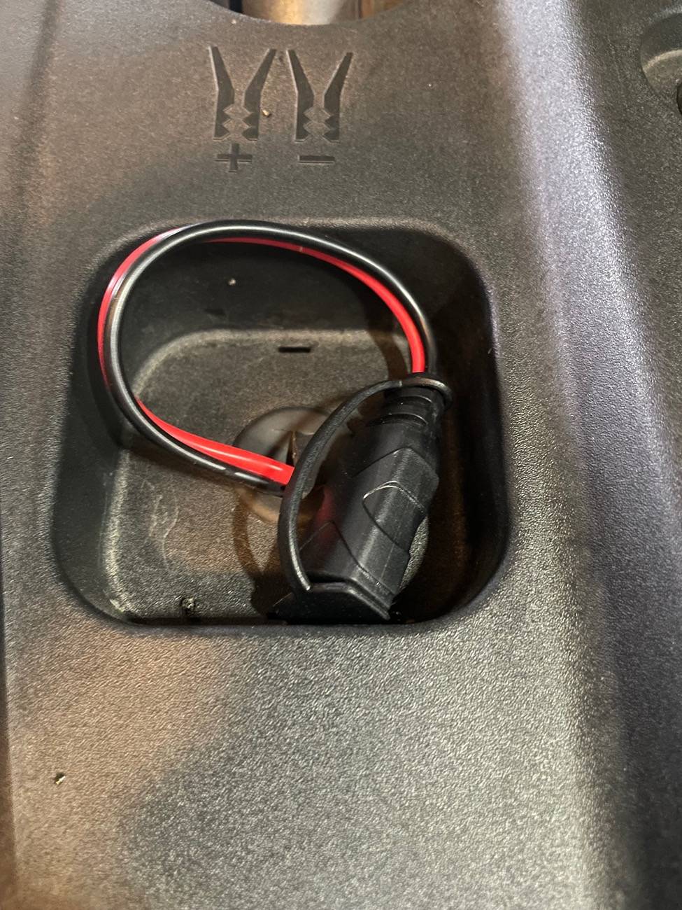

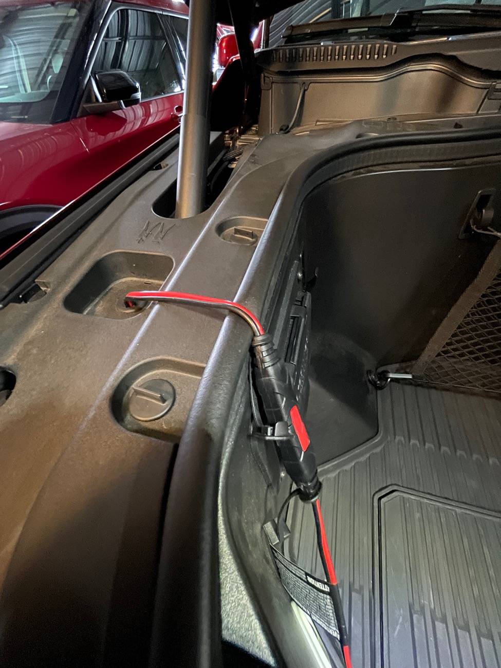

Here’s a couple pics of how I setup a trickle charger connection for my 22MY Lariat to attach a trickle charger without having to remove and reinstall that silly side panel.
Drilled a hole big enough for the connector end to pass through. Then inserted a rubber grommet. Easy peasy and Bob’s your uncle.
I close the Frunk during charging. The cord is small and doesn’t harm the seal.
