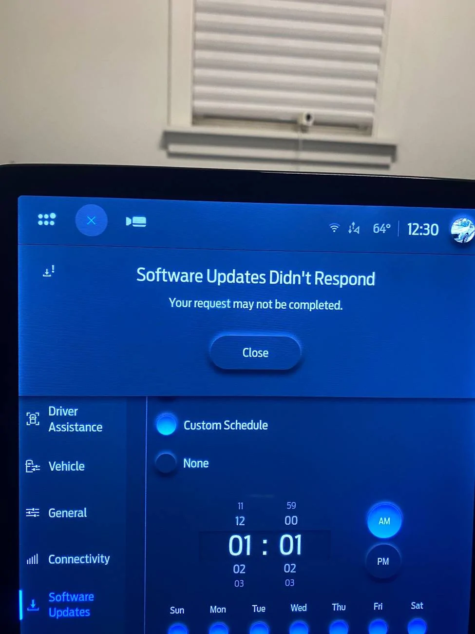

Ok so I got 24.2.5.6.1 on 9/3. After that date I had the 2 CSPs done (24B56 and 24B50) in 2 different dealer appointments. Since then I have had no updates besides the updates done at the dealer via FDRS. I am in EAP and always had updates the same day as they get posted on this forum, but since 9/3, nothing. Granted they updated many modules for the CSP including APIM for the karaoke update.
How do I know if the truck checks for updates? FordPass works fine so TCU seems to work. And I have the connected icon.
So still no update for my ‘22 since 9/3, despite being in EAP. I did a 12v reset and got this message when on the software update page. Any ideas?
Ford F-150 Lightning No OTA Update since September 5th IMG_4667

I just received my first OTA since September on my 22 Lariat ER.
Consistent Battery Performance Gateway Module ECG-25.2.7.1
