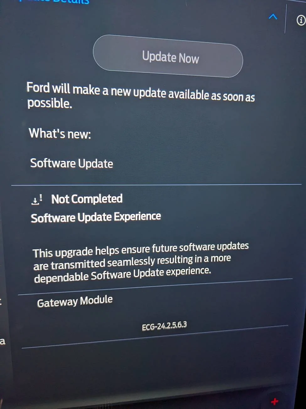

Does the screen say "not completed" or is the OTA trigger still active and failing to install?
Not completed. I think it initially attempted when my LVB charge state wasn't that high.
That sucks.....that means the OTA failed....it is not stuck. There's nothing you can do at this point but wait for it to be resent.

22 Lightning Lariat ER
Bummer. Thanks for the clarification though I misunderstood that the fix was for failure not stuck.

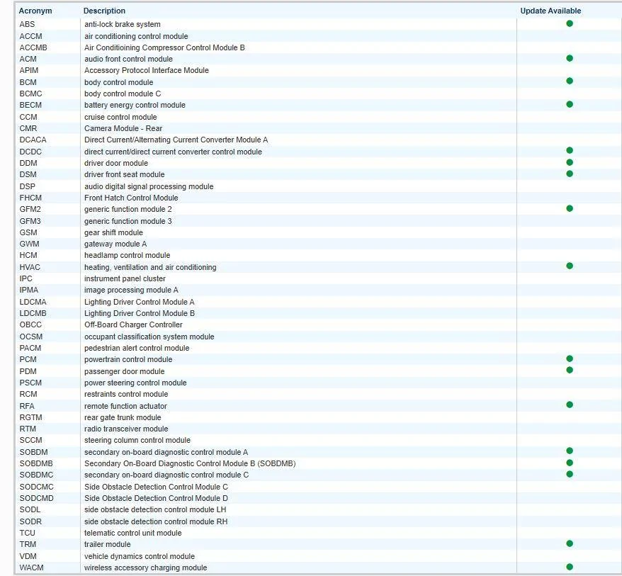

Could you please check my VIN to see what updates are available? My truck is a 2022 F150 Lightning VIN-
Gladly, but please remove your VIN from your request. Modules with pending updates are below. Your truck is on the latest Sync software and the ADAS modules are also on the latest version. In terms of the more important modules, you are up to date.
