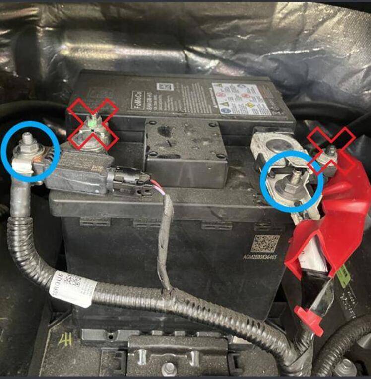

If you have connected your charger up to the wrong points, you need to do the BMS reset procedure to reset the learned values you messed up.
Installing a higher amp hour battery like the Die Hard sounds like a good idea but if the BMS is configured for the 36 amp hr battery we have now the charging performance might be a bit off for the larger capacity battery.
All of my 12V battery issues disappeared after I got the BMS sensor replaced. My battery now shows 90-100% most of the time when I check it.
