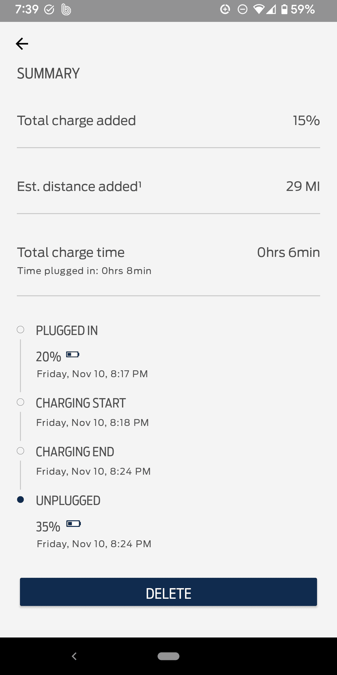

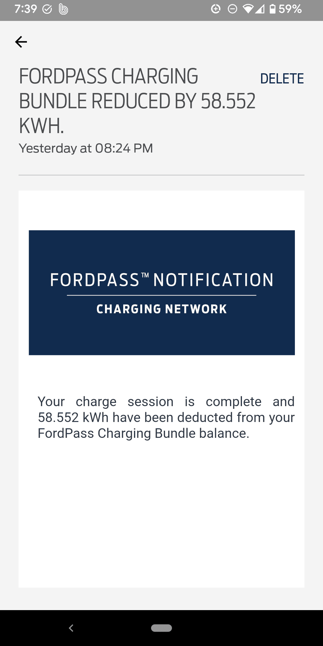

Out of curiosity I pulled my charge log and FordPass account balance
Ford F-150 Lightning Odd EA charging experience Screenshot_20231111-073935
Ford F-150 Lightning Odd EA charging experience Screenshot_20231111-073910
216
15,870
17,792
Save those screen grab's the values do not balance, 98KWH pack x .15 is 14.7KWH
