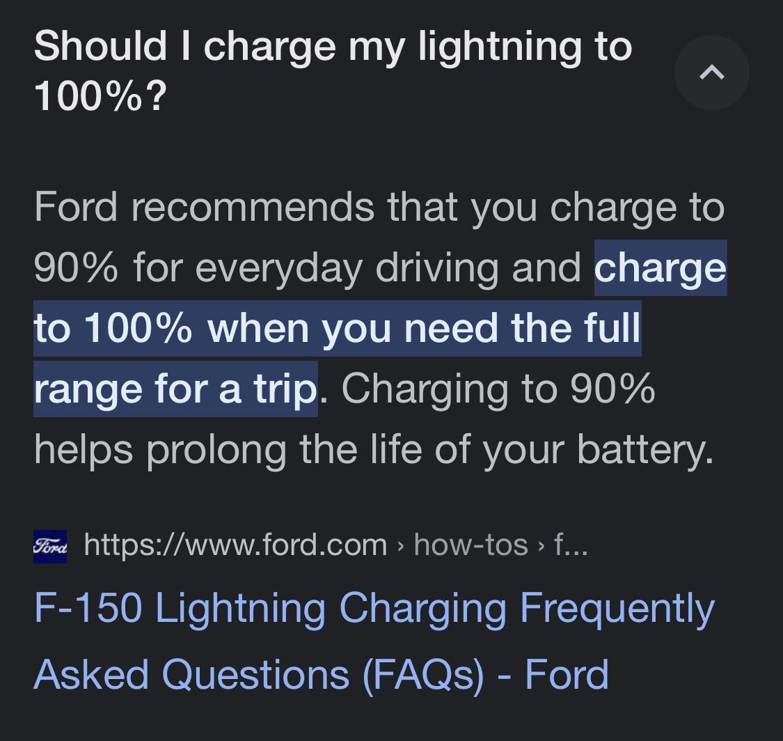

Official Charging Recommendations
csukoh78
Nope
Jul 30, 2023
343
573
SE USA
2023 Ford Lightning Lariat ER
Well, as far as official there is always the manual. YouTube videos are the last place I would ever look for actual, factual, information.
Yes. This. It's very frustrating to talk to people that insist on YouTube, "my friend Ricky Bobby who knows all about EVs", etc.
Go by the official documentation above produced by ford and you can't miss.

There is no way I would charge to 100% on a regular basis. Not only does ford *specifically* say not to do this, it highly stresses the electrolyte and the cells themselves. This is basic chemistry.
Fully charged batteries in hot temperatures are a known point of failure. Even if it doesn't fail, significant long term damage, slower discharge, loss of total power results.
Honestly since all the charging data is stored on the vehicle, if you were to have any warranty battery issues, all Ford would have to do is point to the data and say that you did not charge according to recommendations and they would be fully with the right to deny you any warranty repair.

Where would look to see that recommendation?
Look to see who runs a L-ion testing house (maybe called the Energy Storage Technology Center) and look to see if he left up his previous posts ;)
After cycling cells for 12 years (many different chemistries to include LMO, LTO, NCA, and NMC), I want to keep my daily charge under 80% of the actual capacity...so how do I do this when the useable is different from the actual capacity?
All numbers are for the extended range since that is what I have. We know the useable capacity is 131 kWh and I know the actual capacity is 141 kWh. 131/141 = 0.929, so we going to 93% if charging to 100%.
If we charge to 90% of usable capacity, (131*.9) /141 = 0.836 or 84% of the actual capacity, but I want under 80% of actual capacity...once again, I really wish I could share the graphs.
So let's look at 85% of useable. (131*.85)/141 = 0.79 or 79%. That is under my sweet spot AND meets my daily driving needs...the second part of that is what you really need to consider!
If you have a standard range, make sure you recalculate with the appropriate numbers.
I will start cycling some Lighting cells in a couple of months, so if you see me change my recommendation, you will know I saw something in the data (like I did many years ago with the Bolt cell)
116
7,525
10,352
Please show where it says that if you don't follow charging recommendations warranty can be denied. It cannot.
Please show where they say not to charge to 100% on a regular basis. They don't. They recommend you DC fast charge to 80%, due to charging curves. They recommend you charge at home to 90%, or "less than 100%" depending on manual version, for daily use. They don't tell you NOT to do anything, because they cannot.
If you charge to 100% everyday, via a DC charger, and the battery fails, they have to replace it under warranty. Just because the owner does stupid things doesn't prevent warranty from being honored.
