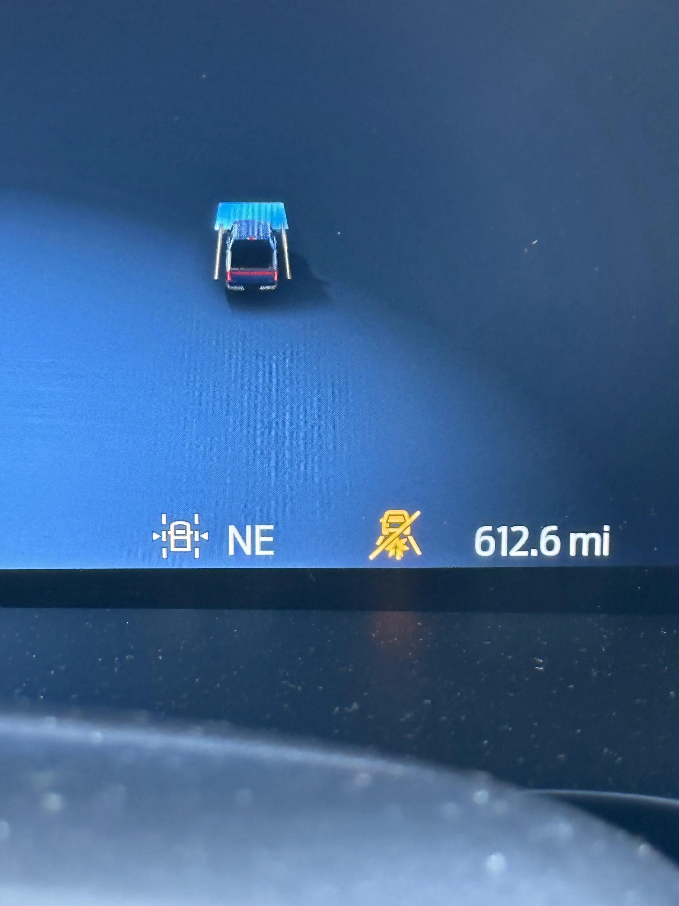

Ok…. I’ve looked and I cannot find what this light is trying to tell me ……. Hopefully, since it’s not Red, it’s not critical ……?
Ford F-150 Lightning Orange Light on dash IMG_1377

The pre collision assist is disabled. A sensor might be blocked.
Ford F-150 Lightning Orange Light on dash IMG_0217

Do you have a lot of bug guts or mud on the front bumper (drivers side / right) of the air grill?
In snow country during wet winter conditions the ice/snow build up interferes with the radar transducer.
Thanks I’ll check in outbid town right now

You will get this indicator when the camera is either blocked, dirty or in direct sunlight.
Mine comes on every morning when I'm driving towards the rising sun.
Ah thanks and in my specific case, it is turned off….. I must have hit it to “off” when I was scrolling through all the setting options ….. ?
