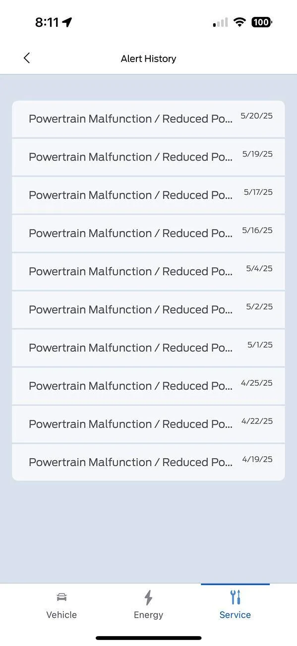

Some of us collect the notices like trading cards, but as long as the power stays at 100% (which mine always has) it's likely either the air dam sensor(s) or the shifter about to cause larger problems. During the middle of one of the below notices I started getting a clicking from the shifter handle, so I'm joining others in changing over to a rotary shifter as noted in other threads.
I have the same issue randomly. It is a shifter module issue. When I have the wrench displayed depressing the shift lever down button, does not retract the shift lever. Next day issue is gone. Ford dealer says I have to bring it in when the wrench is displayed on the screen. (Even though they can see the malfunction history on the car). Sucks
