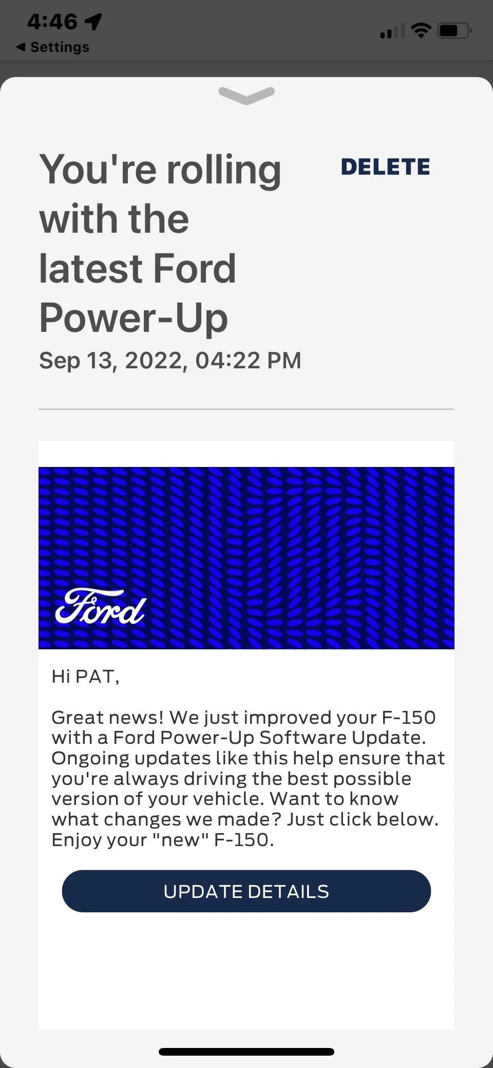

Well surprise me today!
Just got a Ford Pass app notification that my long overdue update was finally received.
Went from 3.2 to 3.5.2 without an intermediary.
Thanks for everyone's insightful data points and encouragement.
