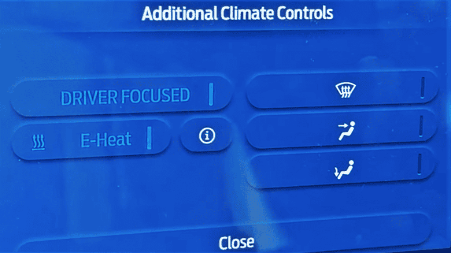

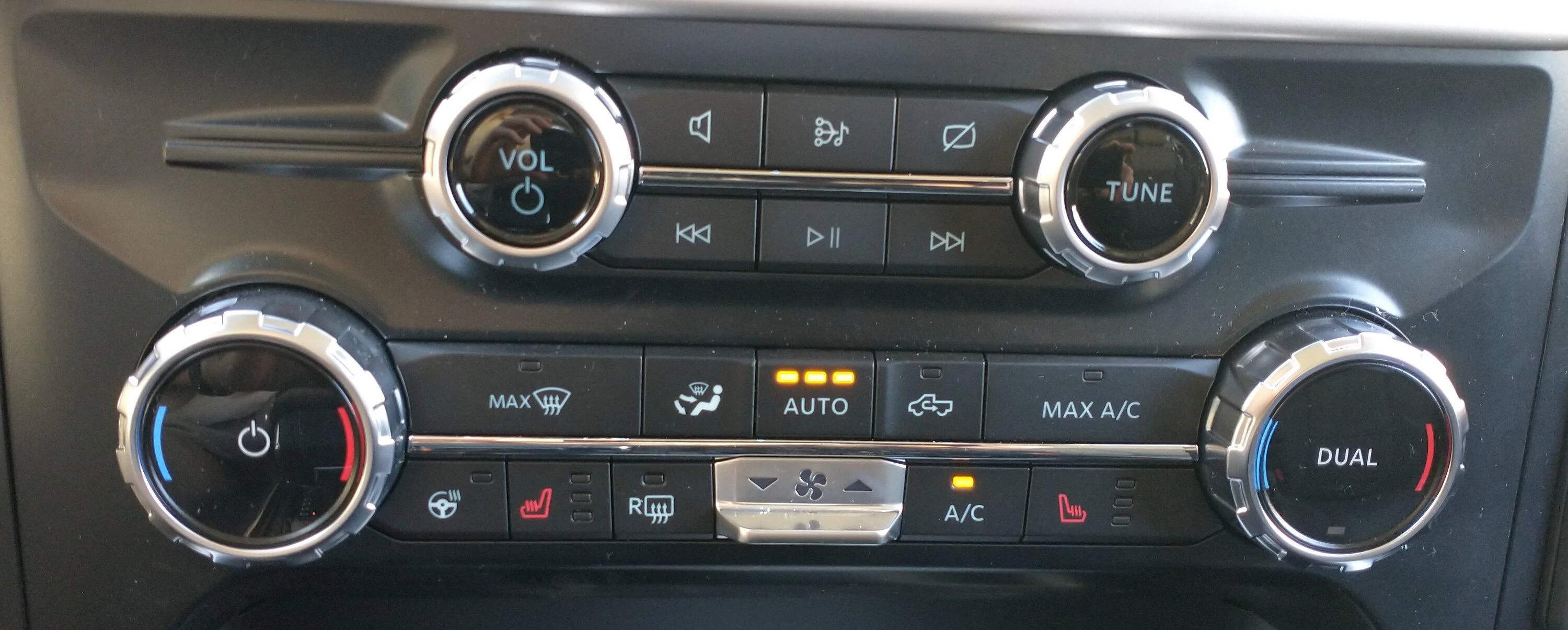

For the 12 inch center display on Pro and XLT models, climate air flow direction and E-Heat show up in a display screen called "Additional Climate Controls" after pressing the single climate HVAC panel control button that shows various air flow directions (left of "Auto" button):
Ford F-150 Lightning Heat Turns On Automatically IMG_20221118_121807822 Ford F-150 Lighting XLT climate controls buttons audio tune buttons sc
I think Ford should have fit these 5 choices below into the HVAC control panel as separate buttons:
Ford F-150 Lightning Heat Turns On Automatically additional climate controls showing e-heat for xlt or pro Screenshot 2023-07-30 221030
It is also weird the manual fan speed control switch can run the blower at a faster speed than the max (3 lights) speed of the Auto button. Another option, Ford could allow customers to customize placement of the buttons, physical or virtual on the display (I predict that will never happen)!
