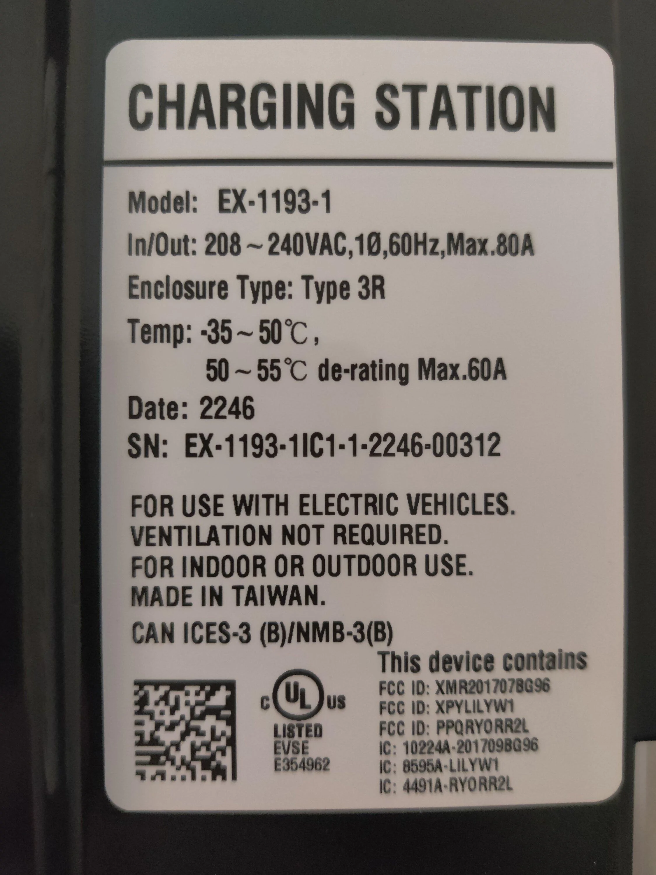

Given the issues some people have had with the FCSP charging at 80A, it begs the question, are there any other good options?
First, if you don’t need to charge at 80A, then sure, dial it back down to 60A or 48A or whatever works for your driving habits, and the FCSP should be able to handle that in almost any environment. That works for most people since most people won’t drive enough in one day such that a 60A overnight charge won’t fill It up.
But for those that want/need 80A charging, are there any other good J1772 80A EVSEs out there?
