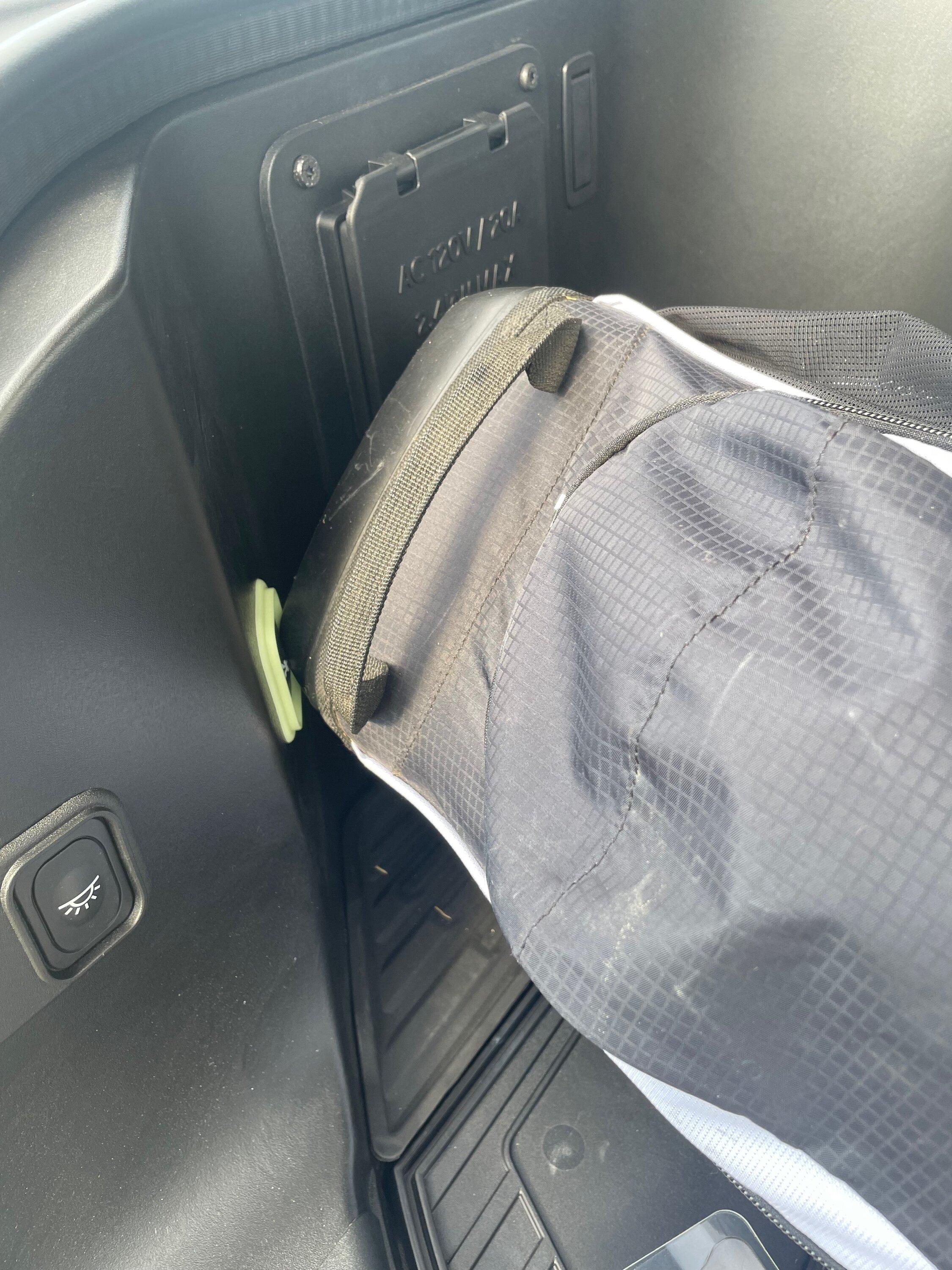

I had issues with the frunk button, not really sure how to solve this, but it seems in an awful location...is there an easy way to unplug it? I was looking at blocking it somehow, but may have to look a little closer.
p.s. I don't know how two golf bags would fit up there, it's awfully tight even with one.
