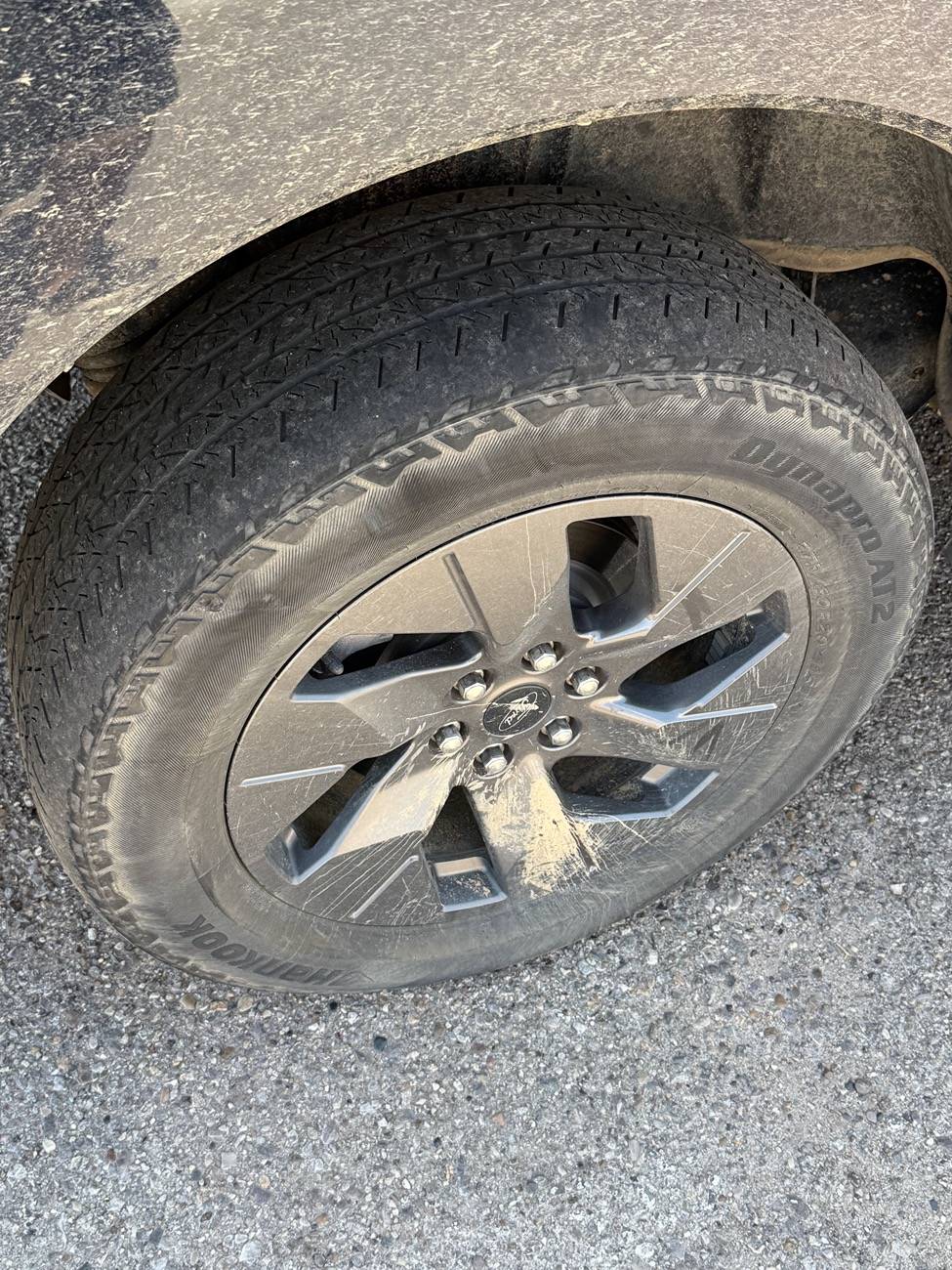

OP, do you have Hankook Dynapro's? Those tires are notorious for wearing on the outer edges.

I run 47-48lbs, on the Hankooks not a problem at all, I like the firmness, handling and extra range you get at that tire pressure. My Lariat has 30,000km and the outer edges of the front tires are just about worn down to the warning tread mark. I do drive very aggressively. I did a tire rotation moved the back tires up to the front now. The Hankooks are not directional tires, therefore you can flip the tire around on the rim which I'm thinking to do soon as the Inside Edge is practically like new still.

I have torched my Hankooks. I’m gonna see what deals discount tire drops and switch to Michelin Defenders. 35k not very gentle miles on these…

There are 3 dozen curves a day for me one way and if I hit them hard say tire scrub-squeal level I could burn their outside tread in 15K miles. Rolling easier meant I got 40,000. But they were pretty worn and time to go. Otherwise safe & sane would’ve got me to 60K. I’d like the Mich Defs to last 60K so I’m rolling very easy.
43 psi late spring m- early fall. Winter at 36 psi.
