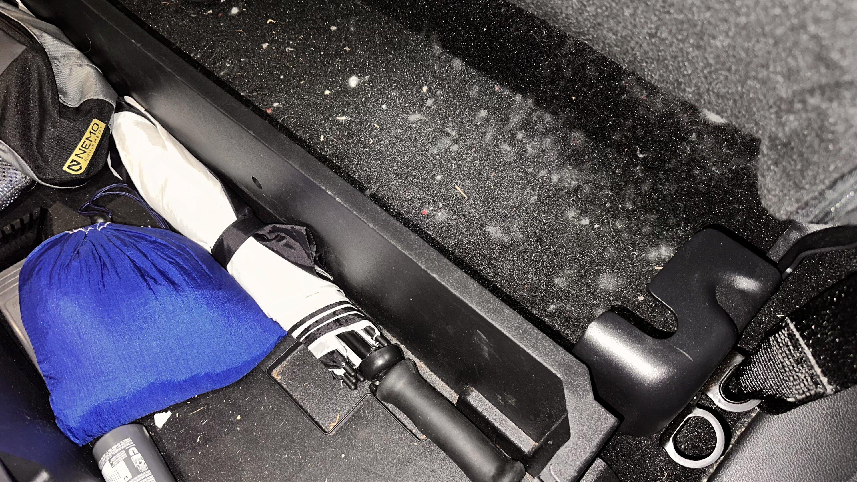

Today my wife took my truck to pick up our daughter from school and sends me a picture asking if I saw the mold in my carpet. I hadn't.
when she got home I went out and there is mold spots all over under my rear seat, all along the edges of the back floor carpet where it meets the plastic, etc. My carpet is soaking wet.

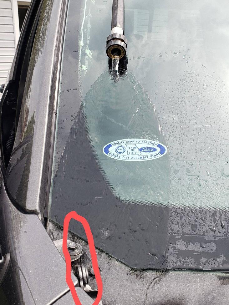

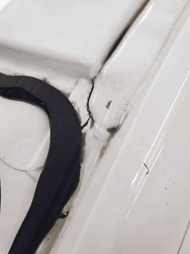

Read this F150forum.com thread: https://www.f150forum.com/f118/water-leak-cowl-seam-474781/?ispreloading=1
It is the same problem that exists on our trucks. Water is making it's way into the cabin via the firewall cowl or the body seams at the top and bottom of the windshields. This is why even on trucks without sunroofs, water still finds it way into the cabin.
