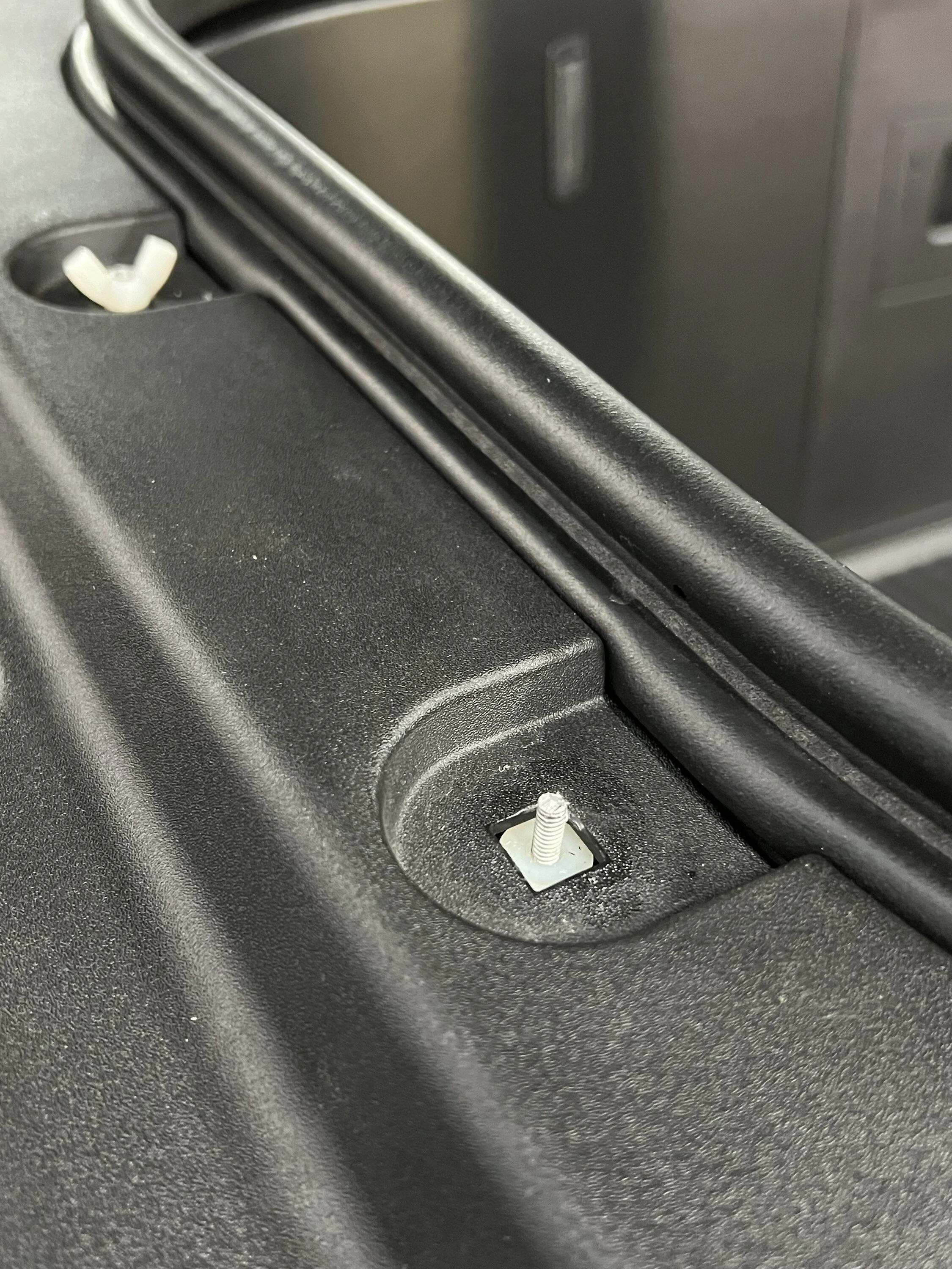

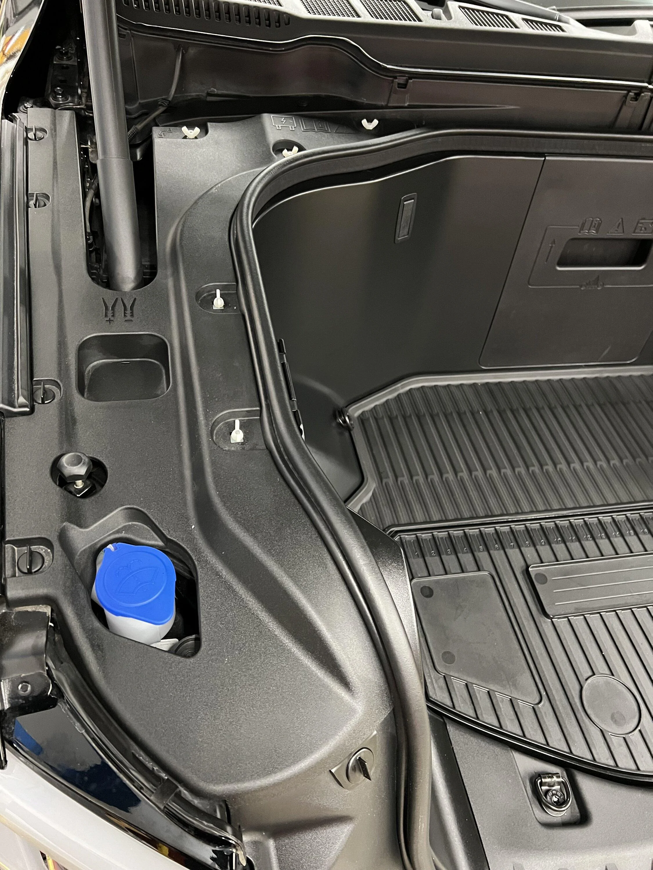

I was tired of dealing with those large inner annoying Frunk trim two-piece panel clips. When trying to turn them a 1/4 turn to release them they would come apart and end up losing one of the pieces. The only way that you can replace them is to purchase an entire trim panel for $174. They come attached to the panel. The smaller one-piece outer fasteners near the fender are fine and actually work well. I replaced those 5 larger two-piece inner fasteners on both sides with a nylon insert, #8-32 thread piece, and a #8-32 nylon wing nut. It works great!
Ford F-150 Lightning Pesky Frunk Inner Trim Panel Fasteners, my solution IMG_7163
Ford F-150 Lightning Pesky Frunk Inner Trim Panel Fasteners, my solution IMG_7164

Any chance you might shoot another pic or two so we can see what the replacements look like before installation?

I purchased the nylon wing nuts and press-in anchors at ACE Hardware. I installed the anchors into the slots where the original fasteners were and took #8-32 screws and cut the heads off of them and screwed the threaded rod into the anchors. Then installed the trim panels and secured with the wing nuts. I didn't replace the original fasteners in the front of the panel because they work ok. Must be they are inserted into a different size square hole. Black wing nuts would look better but I couldn't find any easily.
Ford F-150 Lightning Pesky Frunk Inner Trim Panel Fasteners, my solution IMG_7167
Ford F-150 Lightning Pesky Frunk Inner Trim Panel Fasteners, my solution IMG_7166
Ford F-150 Lightning Pesky Frunk Inner Trim Panel Fasteners, my solution IMG_7171
Ford F-150 Lightning Pesky Frunk Inner Trim Panel Fasteners, my solution IMG_7172
