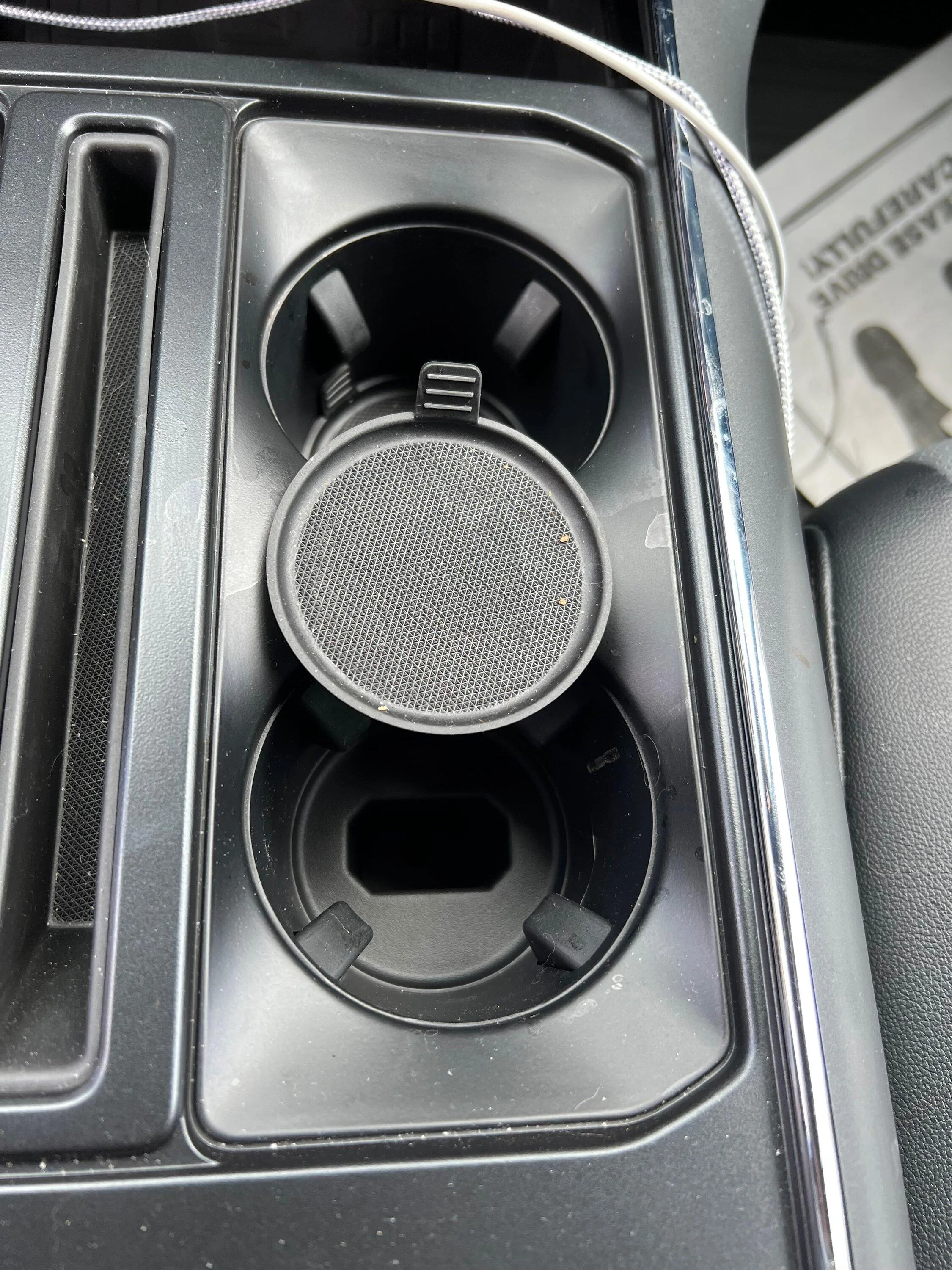

I have realized the solution!
1. Take the battery out of one of your FOBs and hide it somewhere in your truck. Without the battery it won't ever confuse the situation or let someone easily start the truck when you are not around.
2. Live a PaaK key free life without worry of it "failing"!!!!!
3. If Paak or the passkey ever fails just stick the FOB in the emergency slot under the cupholder to start the truck (or replace the battery if you have stored it with the FOB).
In case you don't know, you can start the truck with a FOB with a dead or missing battery by sticking the FOB in the emergency slot below one of the main cup holders.
