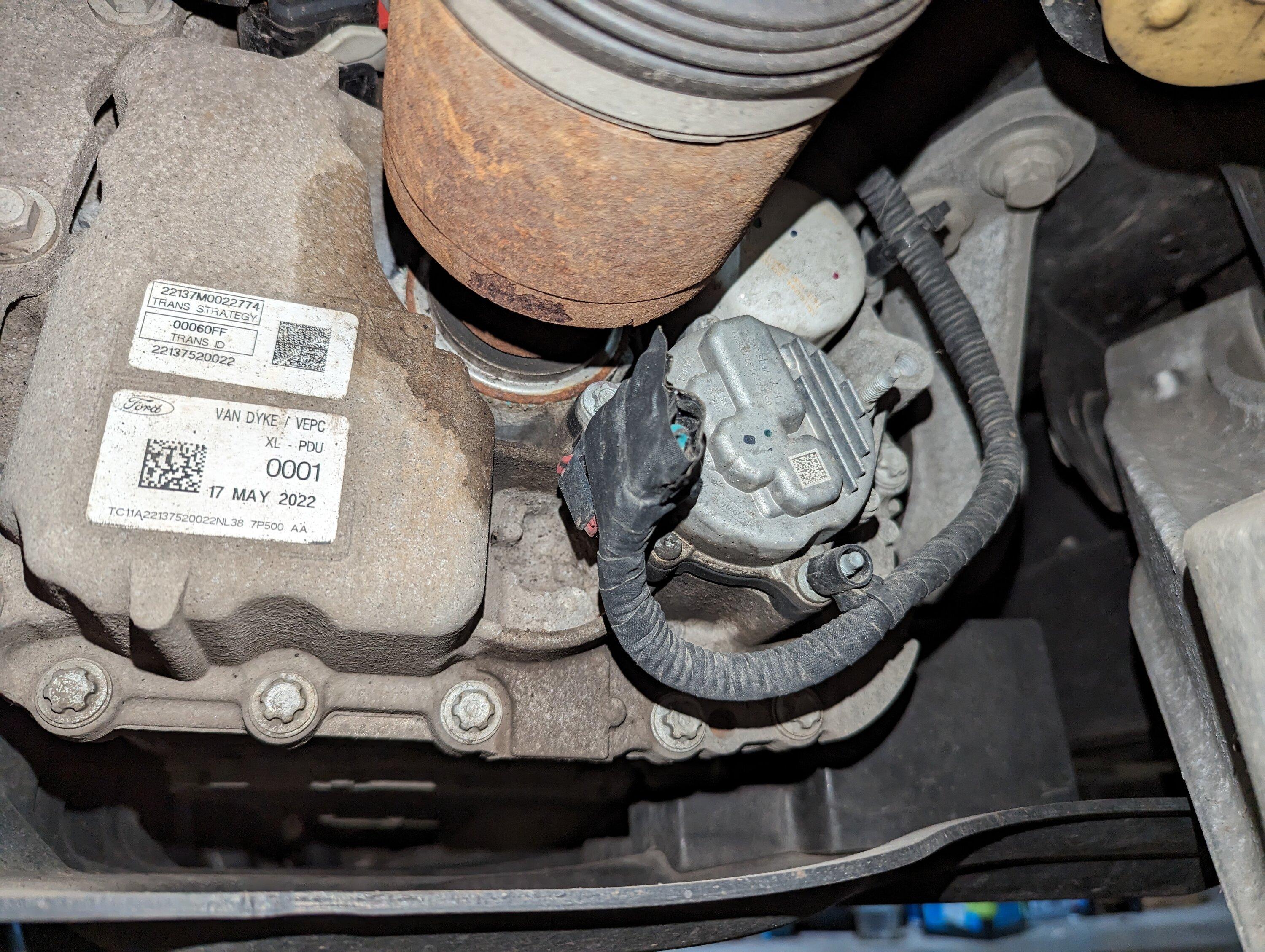

Or maybe it was leaking and not anymore? I pulled off a couple of wheels on my new-to-me truck yesterday afternoon and found this on my rear motor. It's dry with no dripping, so it doesn't look like it's a current thing. Is this something you guys would have looked at, or should I hold off and see if it starts to drip?

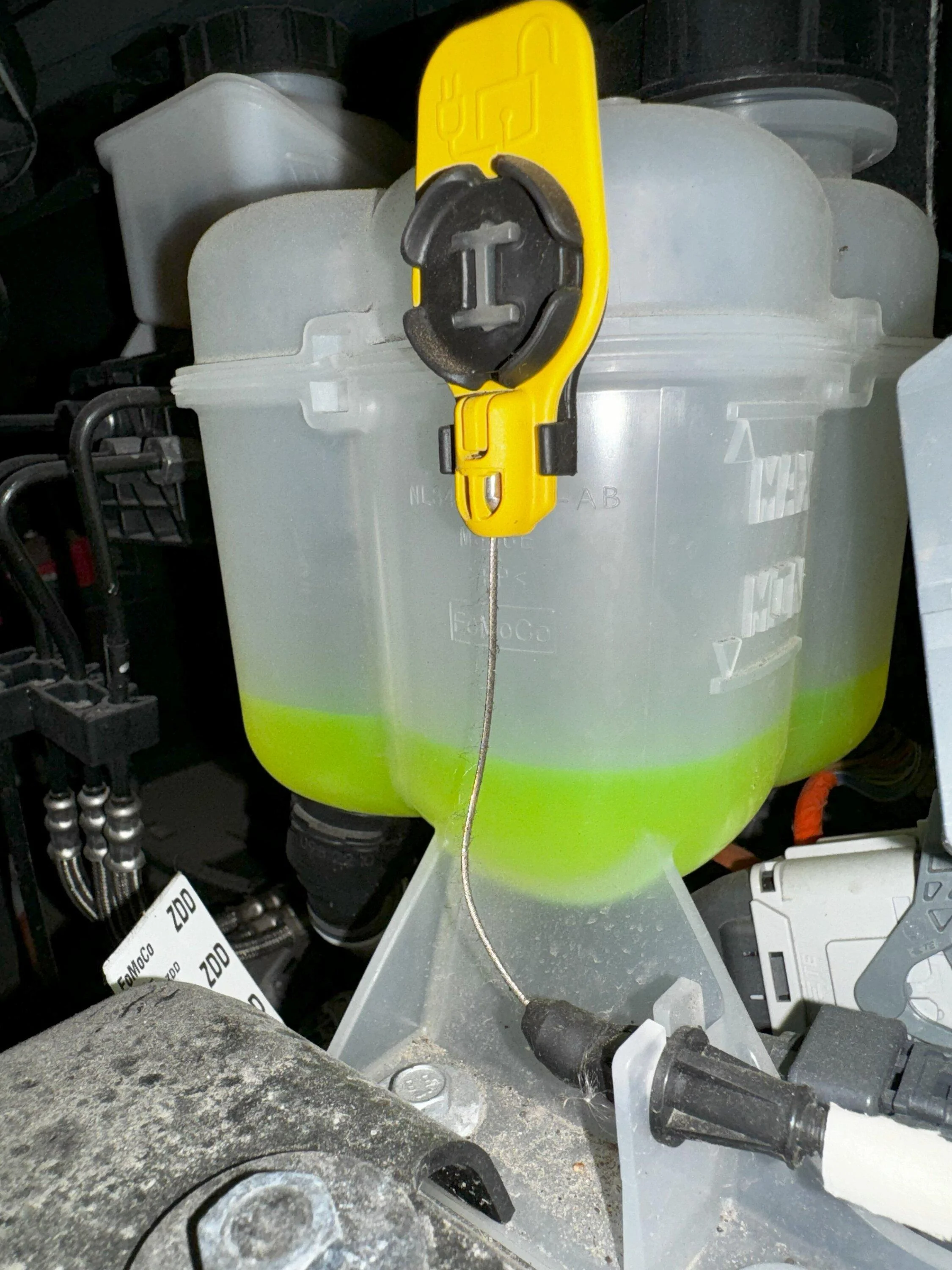

I'm also concerned about a possible coolant leak. It shares a garage with a 2004 Expedition that was driven on Friday, and I noticed a faint whiff of coolant when I popped the hood to connect the battery tender. I noticed nothing yesterday when I was in there removing wheels and found this, but I drove it afterward and smelled strong smell of antifreeze last night when I plugged it in. The reservoir looks a bit low, but I'm not sure if it's always been like that.

Your coolant level is definitely lower than normal, take it in for inspection.

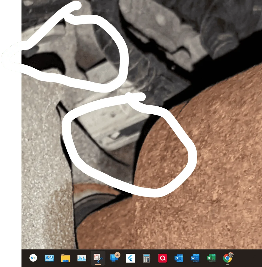

The moisture (oil/coolant)?? appears higher than the output shaft, might be oil sling from the shaft seal, or a leak from the top of motor or other devices further up, they have coolant lines up there.
That’s also a “Can you please check the seals?” situation.
FWIW, another forum had a member with the exact same issue last year and it was a coolant leak.
Mine was exactly there COLD the other day before my service appt, so I asked them to top it off.

Thanks, guys. I went back and stuck my phone up there to awkwardly make a video. It sure looks like the leak was from that seal. It goes in for 23B57 on Tuesday morning, so I’ll ask them to take a look.
