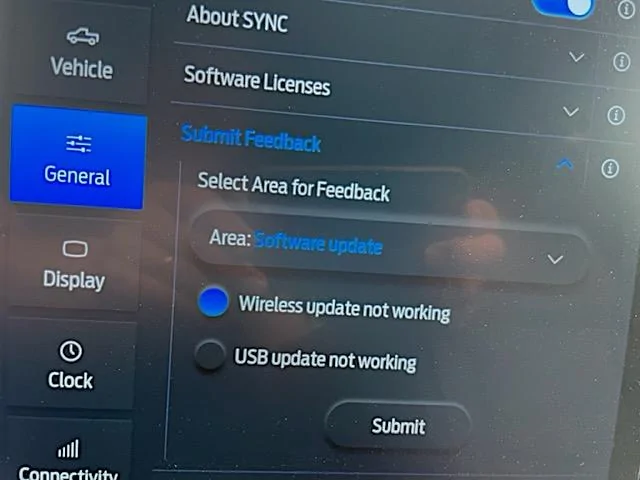

Do you have anything for getting 3.5.5? Stuck on the older version with no new version in sight. Yes I have everything set correctly lol
I used the submit feedback - wireless update not working on the Sync screen.
Connected to my home WiFi all day & night.
Next day, update showed up.

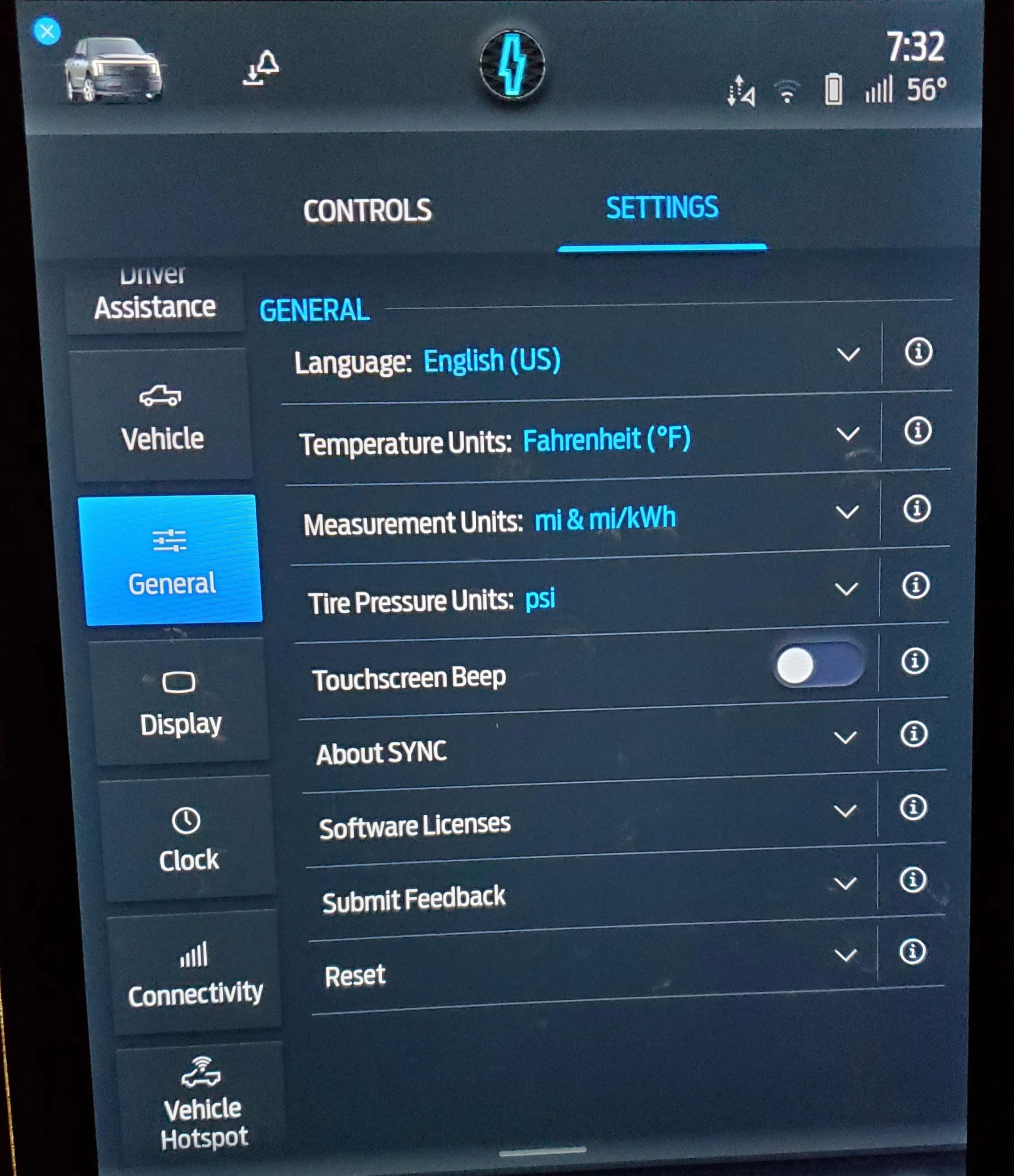

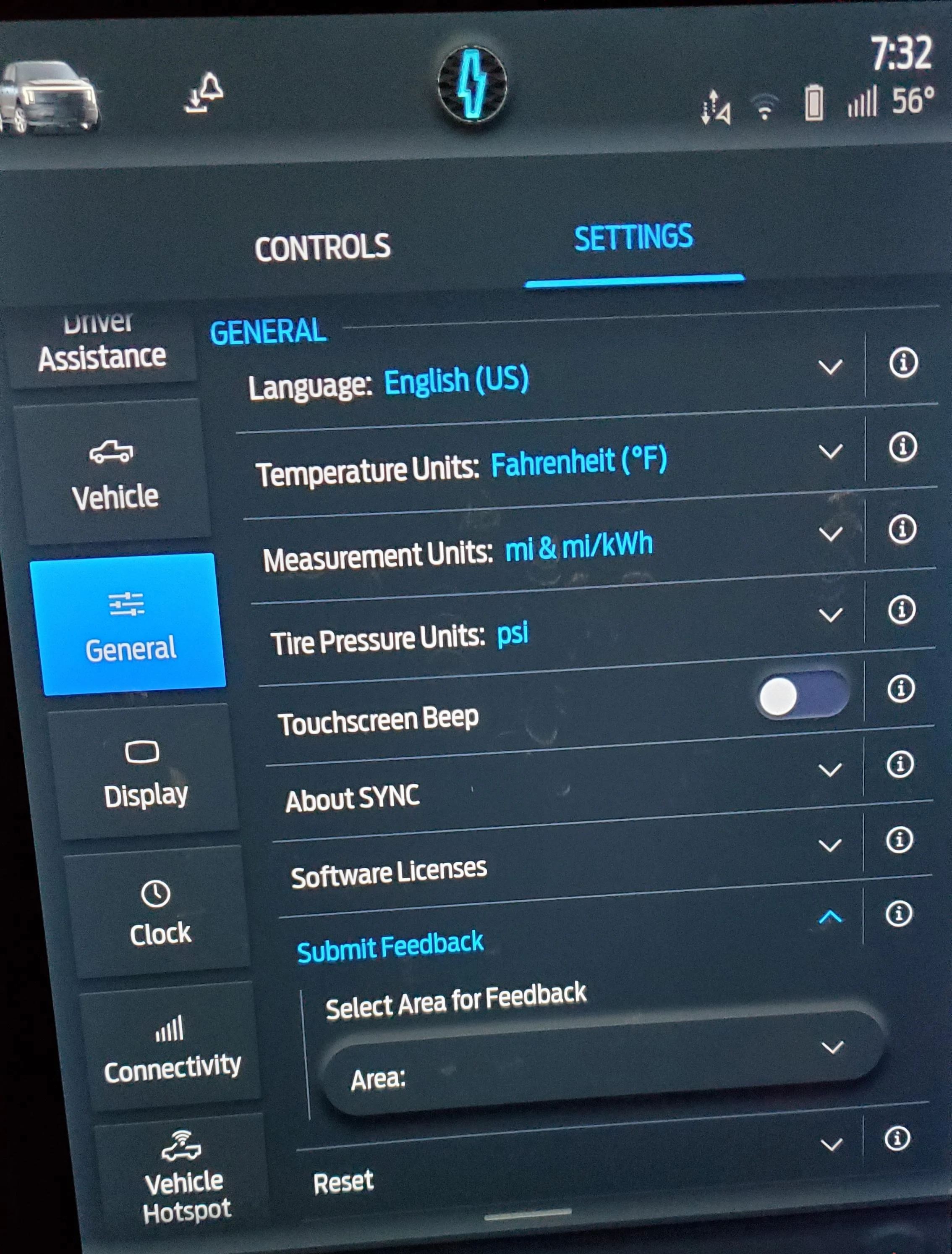

Where do I submit the feedback?
